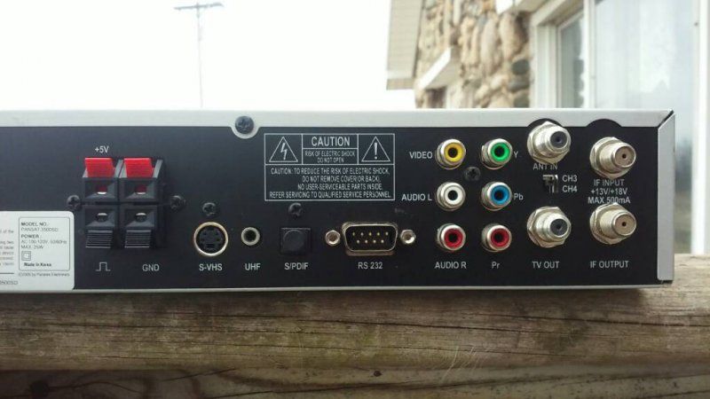

I just discovered FTA and know nearly nothing about it and need help setting it up. I have a pansat 3500sd and a kti 25' mesh dish, I'm not sure if the two are compatible. Thank you to any one that helps

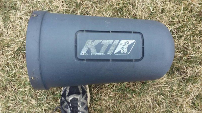

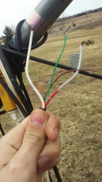

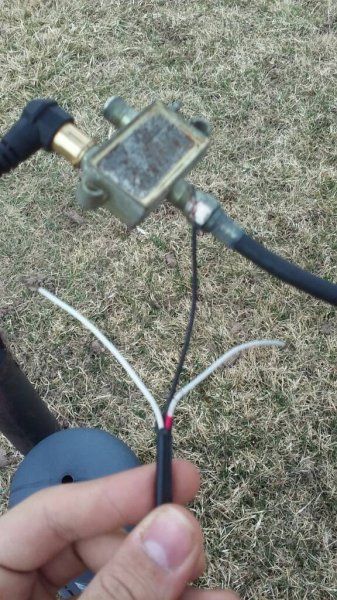

here are some pictures that might help you help me [emoji4]

You are going to need a mover to move that dish. You have two choices. You can locate a Vbox or Gbox or you can buy an Titanium ASC1.
If you decide to stay with a separate feedhorn and LNB combo with polar rotor the ASC1 with move the dish and skew the feedhorn antenna for you.
You could also you a car battery or other 12-36V DC source to manually move the dish just to see if the actuator works.
You can also go with an all in one feedhorn/LNB combo better known as an LNBF and you will not have to worry about having something to skew the polar rotor, you will however still need to have something to move the dish.
That receiver will work for a few transponders, however the majority of them have all went to DVB-S2, that box is a DVB-S1 or simply DVBS.
It will work to get your feet wet however.
