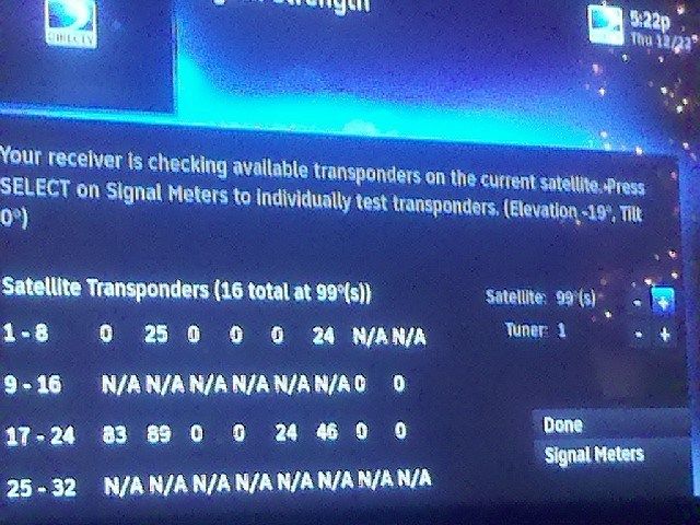

Ok they all look good except for 99 (s) and 103 (s) those are at zero. I flip to the tv and I am picking up all the HD channels. I guess I dont need those two?

If he doesn't get the 99s or 103s he won't get his locals, provided D* carries them.
While he's very close, and is getting all the Conus HD channels now, he wont get his locals.
Guppy, all you numbers are still low, but you'll be OK till the weather comes in.

I'm two states north and have all zeros as well but get locals in HD.
99S.jpg this what my HR24 shows and have never been questioned by ISS about the 99s when needing to call in to request waivers. You may be right, I have been unable to find anything like "the list" for directv.

View attachment 72416 this what my HR24 shows and have never been questioned by ISS about the 99s when needing to call in to request waivers. You may be right, I have been unable to find anything like "the list" for directv.
Hey guy,
Your locals are coming in on transponder 18 with 89%.
I was under the presumption that you had NO signal on the 99c Sat, you have strong signal on the 17 and 18...
The other transponders that you have numbers on are for other areas in your spotbeam that you don't receive.
