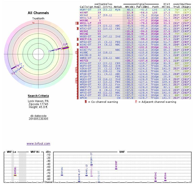

Based on a zip search on TV Fool a good, well aimed roof mounted OTA antenna you should be able to get some locals.

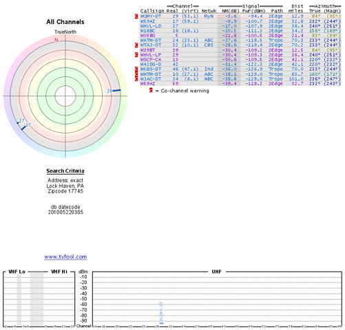

Here's how tvfool shows for my exact address. So if I'm reading it right, it will be tough to get anything.

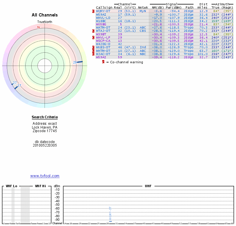

Yep maybe so, BUT if it were me I would still set one up anyway just to see, but thats the DXer in me; cant hurt to see what you get. Here is what I get based on your addy. Wonder why the difference? Maybe worth a try with something like a Winegard HD 9095P
