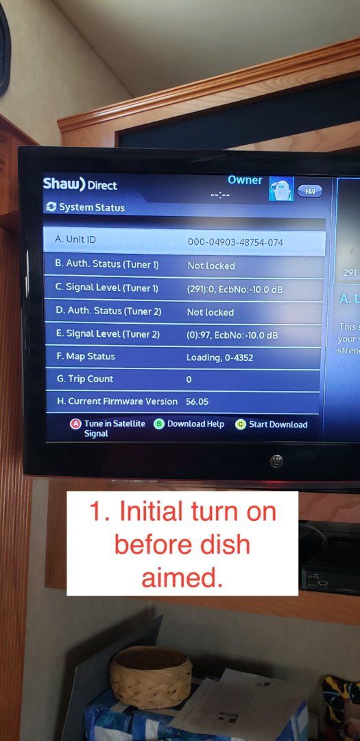

Hi Everyone - just arrived in Benson AZ to our house here and things aren't going too well. I see others are having issues as well. I have the Shaw 75 cm dish that was working great with a new Triple Satellite Quad Output xKu LNB last year with my old 630 PVR. That PVR was about to die (hard disk was squealing) so I got a new HDPVR 830 for free and thanked my lucky stars. Got down here, hooked it up and satellite signal is lost, the 830 PVR says, with the dish in the same place it was last year. The best I can do is Ecb of 3.0 Db on channel 114 on F2. I get 75, (EcbNo. 3.0 Db) on channel 200 on F2. I need a refresh but don't have the signal to do it. I used a Winegard SF1000 to initiallly find where Dishpointer.com says F2 should be but the signal isn't too strong on the SF1000. Plan B is me on the roof with the wife yelling "stronger"/"weaker" to get the above results. The 830 still says the satellite signal is lost. I'm using map 4321 that Shaw told me to use(my other option is 4320), Firmware 60.33, Tuner 2 disabled. The 830 only intermittently sees the LNB when I do an LNB scan, cables seem fine. It sometimes says it's a Quadband LNB. After chatting to Shaw for an hour they wished me luck on my own. Help! The CFL Playoffs are on this Sunday and if I don't get this working I'm toast.
This has all been covered in previous posts. "Do Not Move the Dish"! leave the rec on 4321, then find a channel that works down there like 002 or 003, if you can not change to them because your rec is set for factory default try 396 or 291. It really does not matter what channel as long as you get a signal. then you can get a refresh. Let it sit for at least 10 minutes to load. your firmware also need to be updated, that will take 45 min if you do it manually. otherwise it will dl at 3am as long as you turn the unit off before bed.
Hello All. Call me EXASPERATED !!!
In my previous posts I detailed how my HDPVR630 (unplugged all summer), would not receive any signal (-10dB) when turned on in Arizona. It seems that it may have gotten a signal initially, started a download, then somehow lost it's signal. I then borrowed a friend's receiver and had a good signal and programming so it's not an antenna problem.
Since that time, I had a conversation with Shaw who determined it was a faulty 630. They sent a replacement to my Cdn address and I had it forwarded to me here in Az. I have attached 3 screen pictures showing the chain of events. I installed the xku and connected the new receiver. After tweaking the dish, I was getting a solid 88 (6.3 dB) signal. I called in a refresh and after leaving things alone for over an hour, my signal disappeared.
Is it possible that Shaw, when the tech upgraded the programming last summer, set my receivers to hear the new G2 only?
In hindsight I should have gotten my son to plug this new receiver in and let it do the updates at my home address, or alternately, just shipped me a working receiver from my home.
I note that others mention changing the mapping or programming manually. Is that an option for me, and if so, how?
Thank you anyone, all, for your replies. Gary

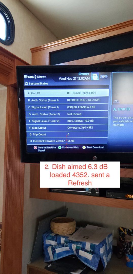

I don't see any where that you mention your dish size? Assuming you have the larger 75cm dish for that far down your (solid 88 (6.3 dB) signal ) is not very good. It is not possible for Shaw to set you to only 1 satellite like G1 etc. It is possible however for you to be aimed to only 1 satellite. In which case you would have to turn the dish a fraction to the west. If you have no signal on 212 or 213 try moving the dish slightly west and peak it if you get signal.
If you have a 60cm dish, replace it with a 75cm. You can now also take this rec to a know good working dish to see if the rec is ok.

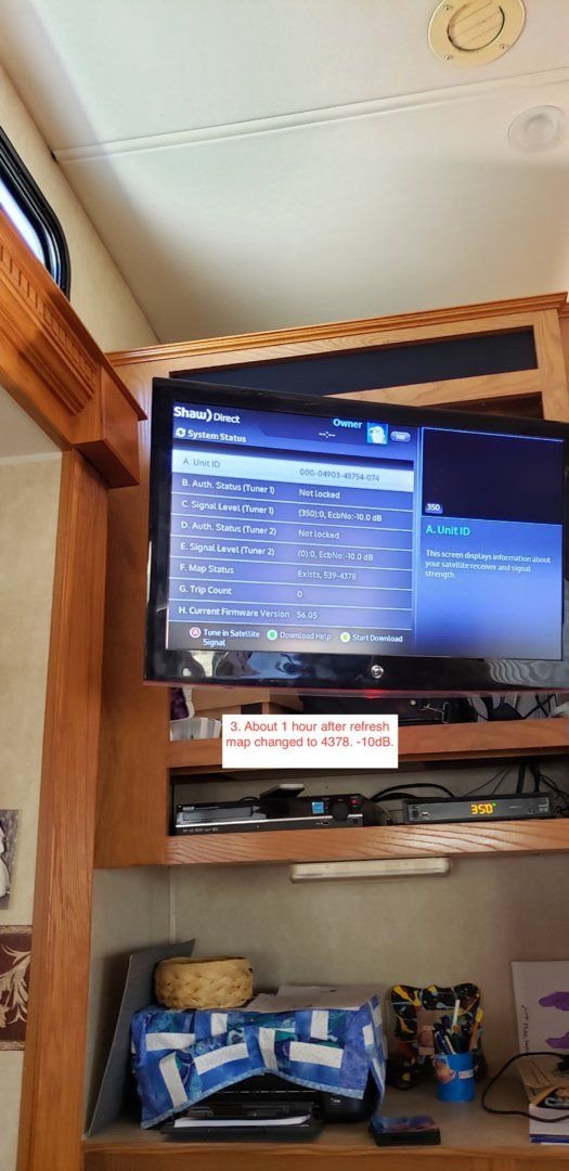

Hi All. I would be remiss if I didn't write to say I finally got my receiver working!!!
Just a recap for anyone still struggling.
Our Original HDPVR630 was left in Arizona all summer connected to the 75cm dish but the trailer was unplugged from power. This fall, it would not work and was replaced by Shaw.
The new one was connected with it's new xku lnb, and aimed (perhaps to F1) and got a 88 signal. It started to download and even sent a refresh signal before we lost the satellite connection.
With thanks to Showtime, I moved the dish west and then got on the right satellite and a good 95 signal. I did not have to refresh as I mentioned before because it did that previously.
Interestingly, I can get 212,213,214 etc, all HD channels but not 217 HD (Chek Victoria). I assume that is because it is only on the G1 sat ?
Anyway thanks again for all the help and patience. Gary

The light just came on! I think I finally figured out what Showtime has been trying to tell us. What I have been seeing as Intermittent drop out of the receiver with respect to the satellites is in fact not intermittent at all. It is dependent upon the channel I selected and the way the map works. I originally thought that my receiver was not being properly refreshed because of not receiving the refresh on the new satellite, but the refresh only affects subscribed programming and not reception. I also tried resets without success.
I now realize that the latest map (4378) tells the receivers which of the three satellites to look to for the channel selected. We know we can receive F1 and F2 and that we cannot receive the new one. It appears that when we select a channel, one of the two tuners checks the map, then looks to one of the three satellites, finds the correct one, and lastly finds the correct channel. When the two tuners are being asked to receive channels that are mapped to F1 or F2 everything works. As soon as we select a channel that the map says now resides on the new satellite, we get the Lost signal error, obviously because there is no signal from the new satellite. If we immediately go back to one of the known channels that are on F1 or F2 the tuner locks on and we have a signal again.
I'm attaching a list of the channels that are located on F1 and F2 and can be received in the Phoenix area. If you are having difficulty it could be as simple as asking for a channel that is mapped to the new satellite and not available here.
Hope this helps a few of you.
Reactions: showtime
