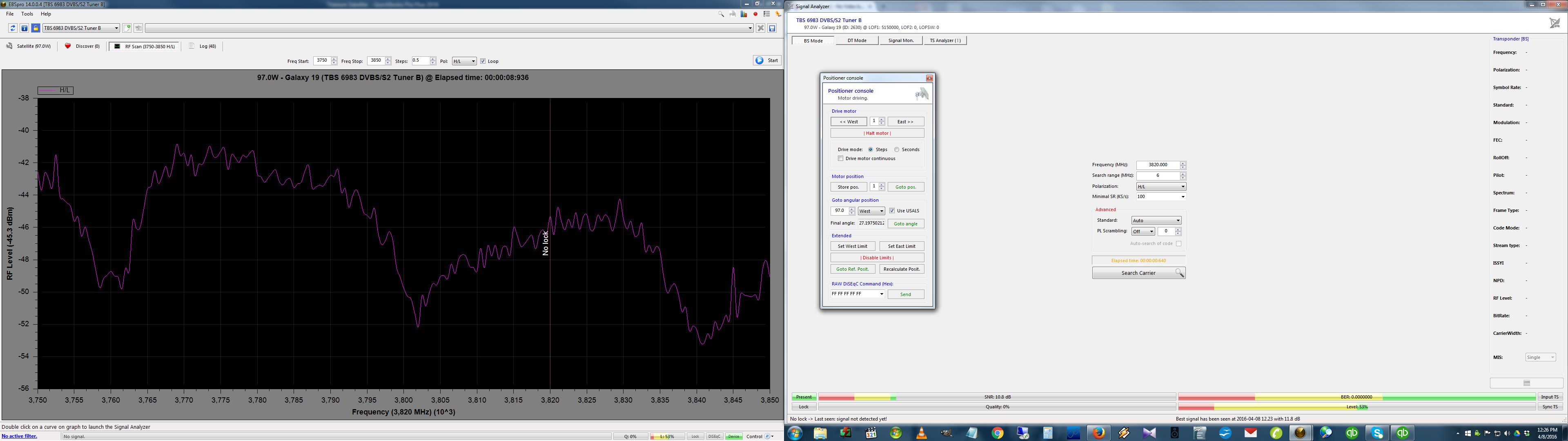

Here is a screen shot of EBSpro on 99w 3820:

OTHER Got ACM?
