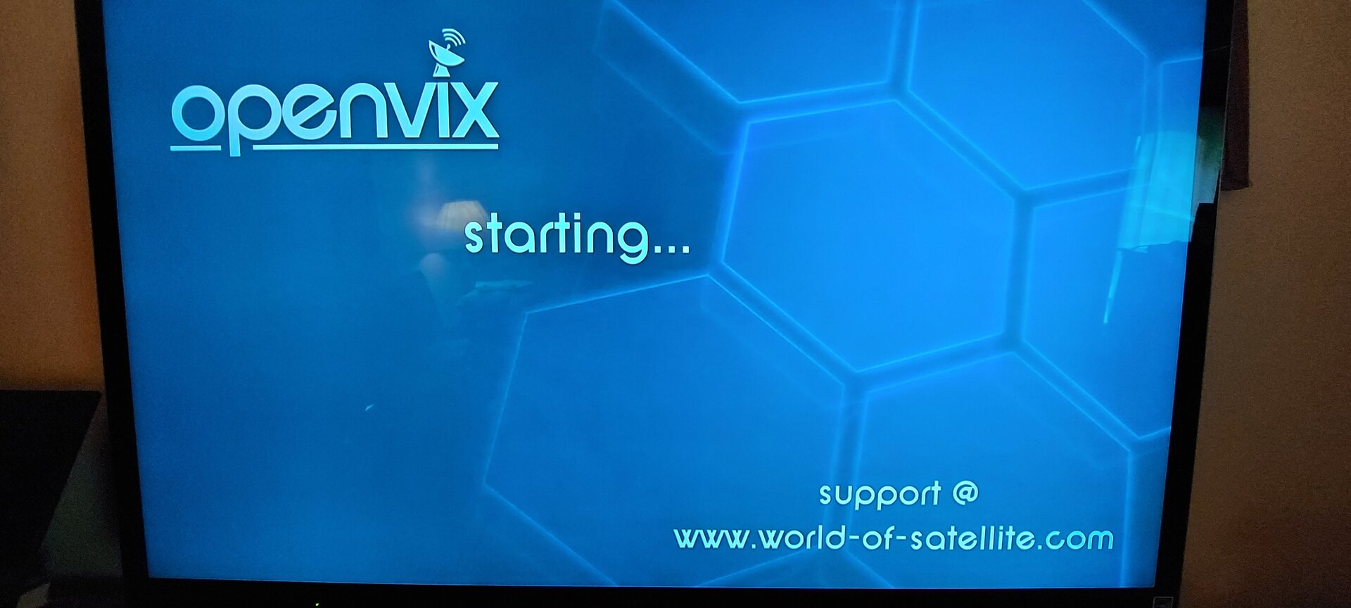

I have not used my Edision Mio 4K+ in quite a while. I had boxed it up to take to a different location.
When I boot it up, I get the splash screen and then I get "no HDMI signal" on my TV.
I have checked the setup on the Edision's setup screen. Everything is in order.
I have also reflashed a different image using a usb stick (openvix-6.4.002.release-osmio4kplus) .
Still "No HDMI signal".
Is my STB toast?

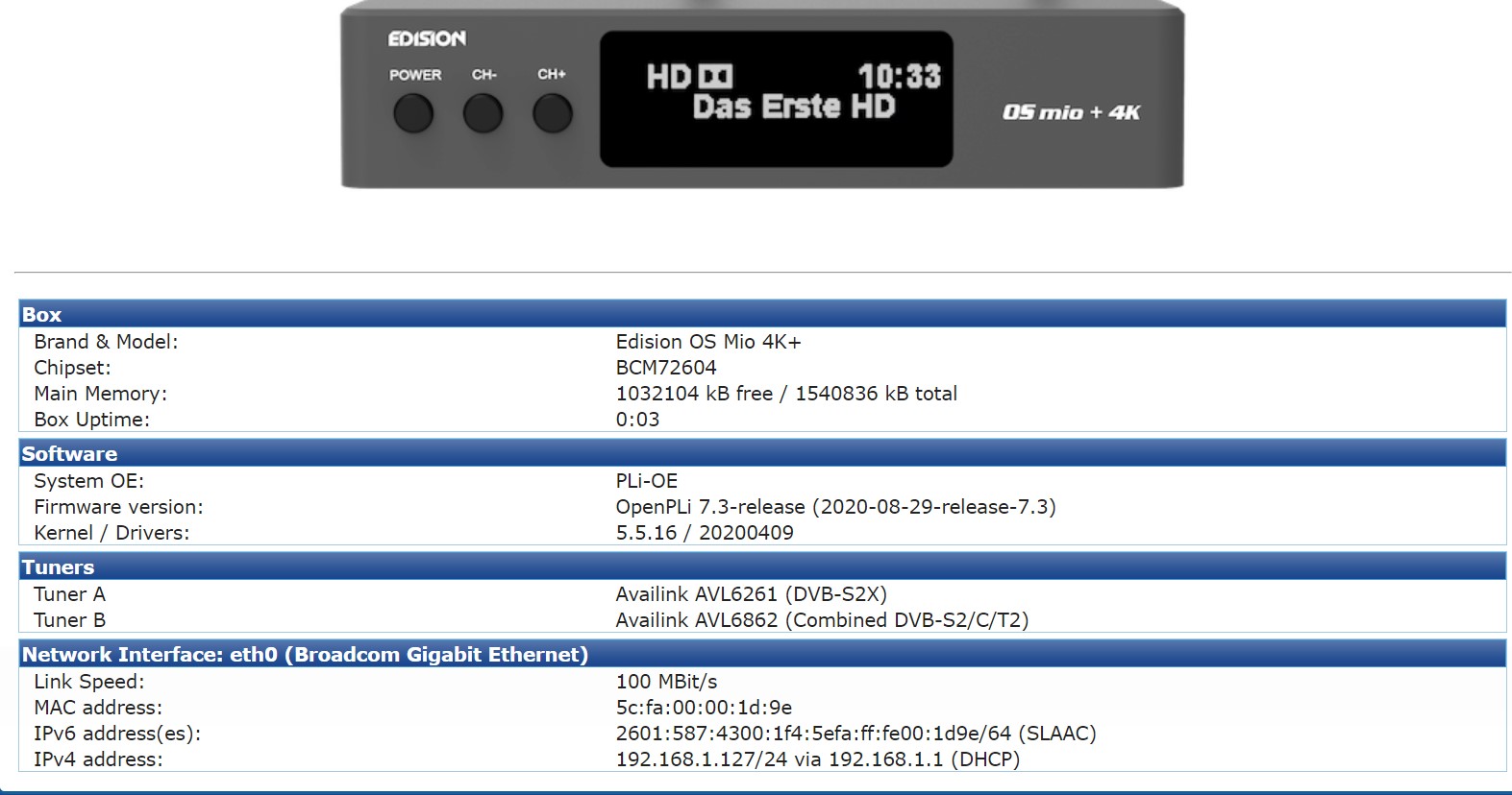

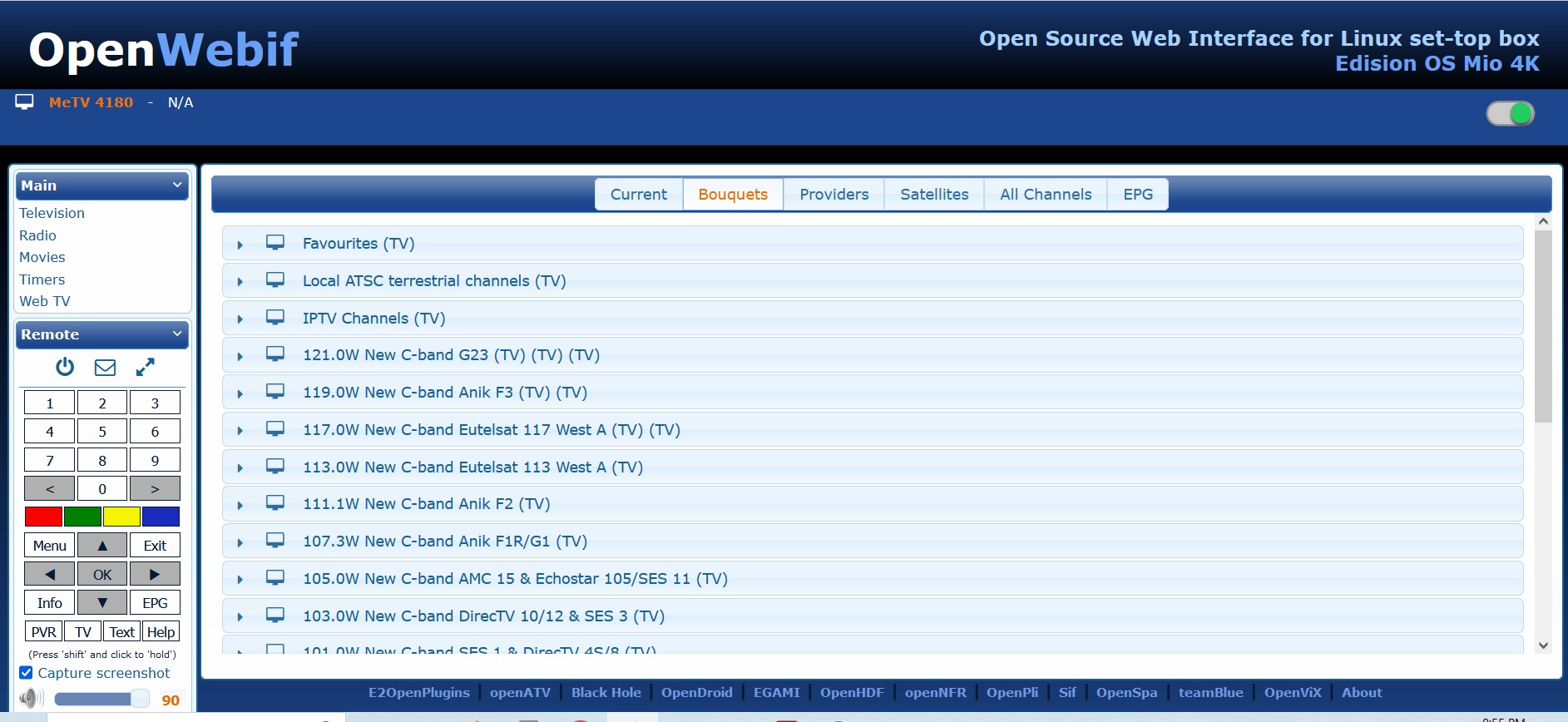

Connect an ethernet cable to it from your router. Boot it up, and wait a few minutes. Can you now access it on a browser on your laptop via it's IP address from the router using the WebIF menu? If so, you can change the video output so it comes up on your tv set.
Here's what that looks like:
I connected, but being easily confused, I don't know how to:
"change the video output so it comes up on your tv set.
Thanks for your patience.

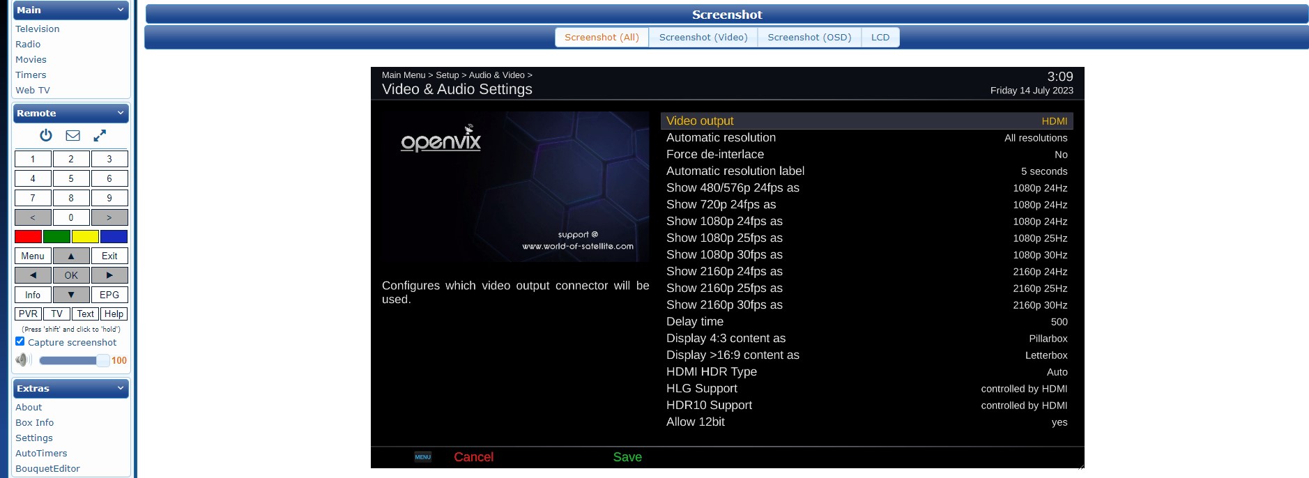

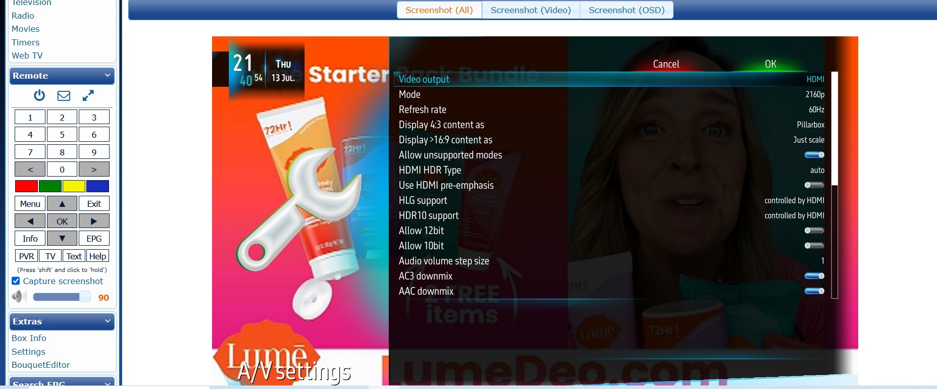

OK, over in the LEFT-hand sidebar, click on MENU. Then click the DOWN arrow 3 times, and it'll go to SETUP. Then click OK. Then OK again 3 times more. You'll be at the video screen. Then just change your settings using that same arrow menu, and Ok button once you pick the things needed for YOUR tv sets resolution. This is MINE for a TCL Roku tv set:

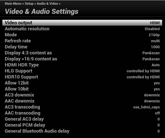

Here are my current settings:
I don't have Openvix at present, or those choices. However, since it won't output to your tv set, something about them might not be right. Did it EVER work with THIS tv set you are trying? Try another HDMI cable, and/or HDMI port. I would then suggest you try changing the one called: "Automatic Resolution", and see if it has a FIXED choice that matches your tv set. Once you get video on your set, you can play with the settings and see what happens. At least you KNOW the box is actually live and working, otherwise you couldn't do all this.

Give this setting a shot. If your TV is a 4K 2160 should be ok. Or try cranking it down to 1080. See what happens. I'm running the latest Vix. Do you have another TV with HDMI input to try? Or how 'bout a pc monitor?

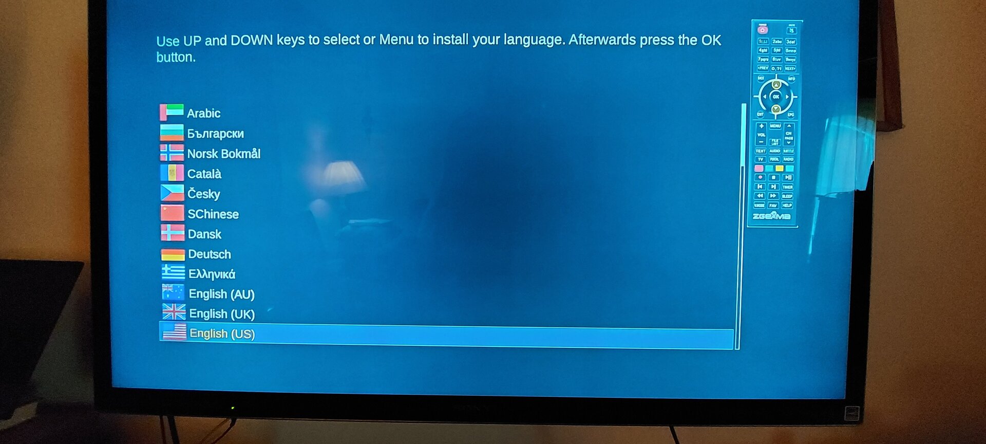

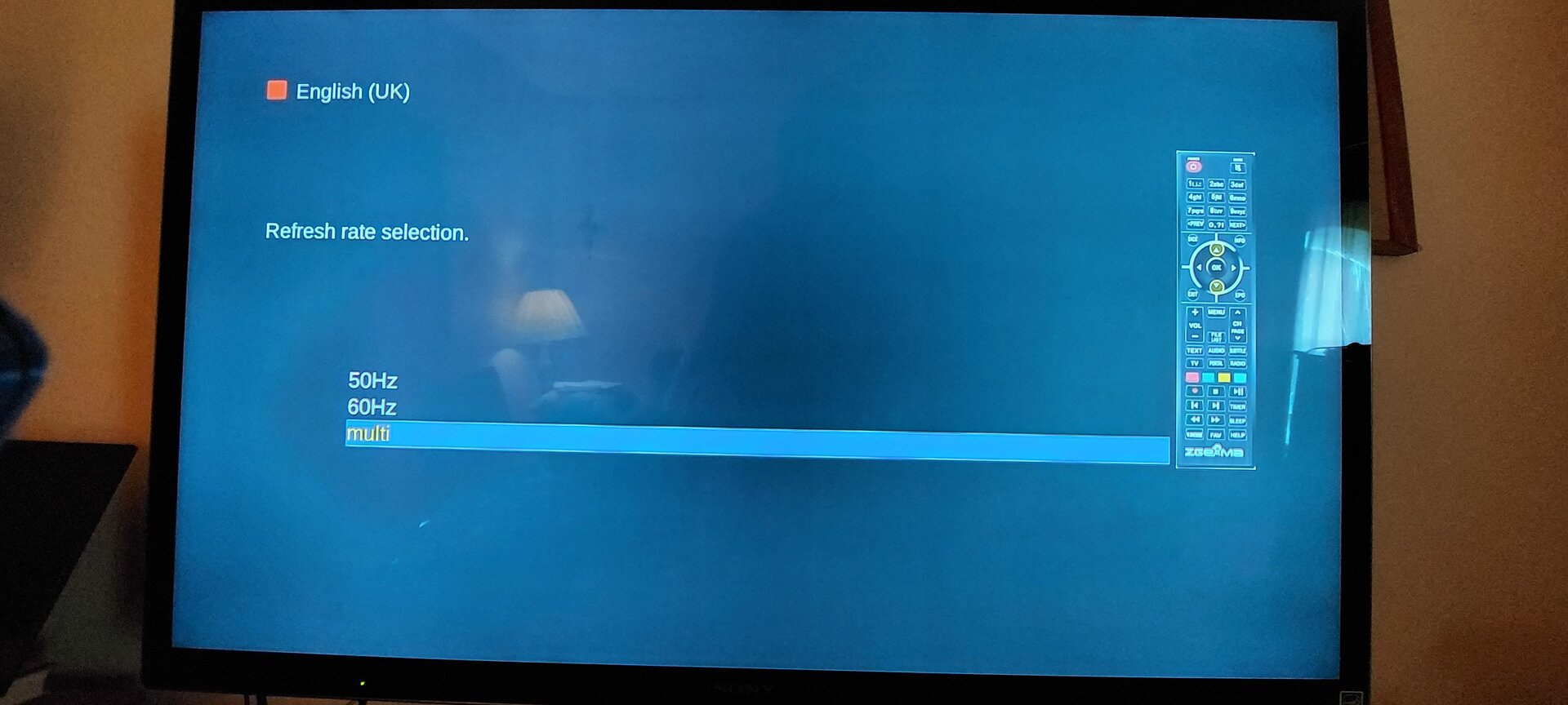

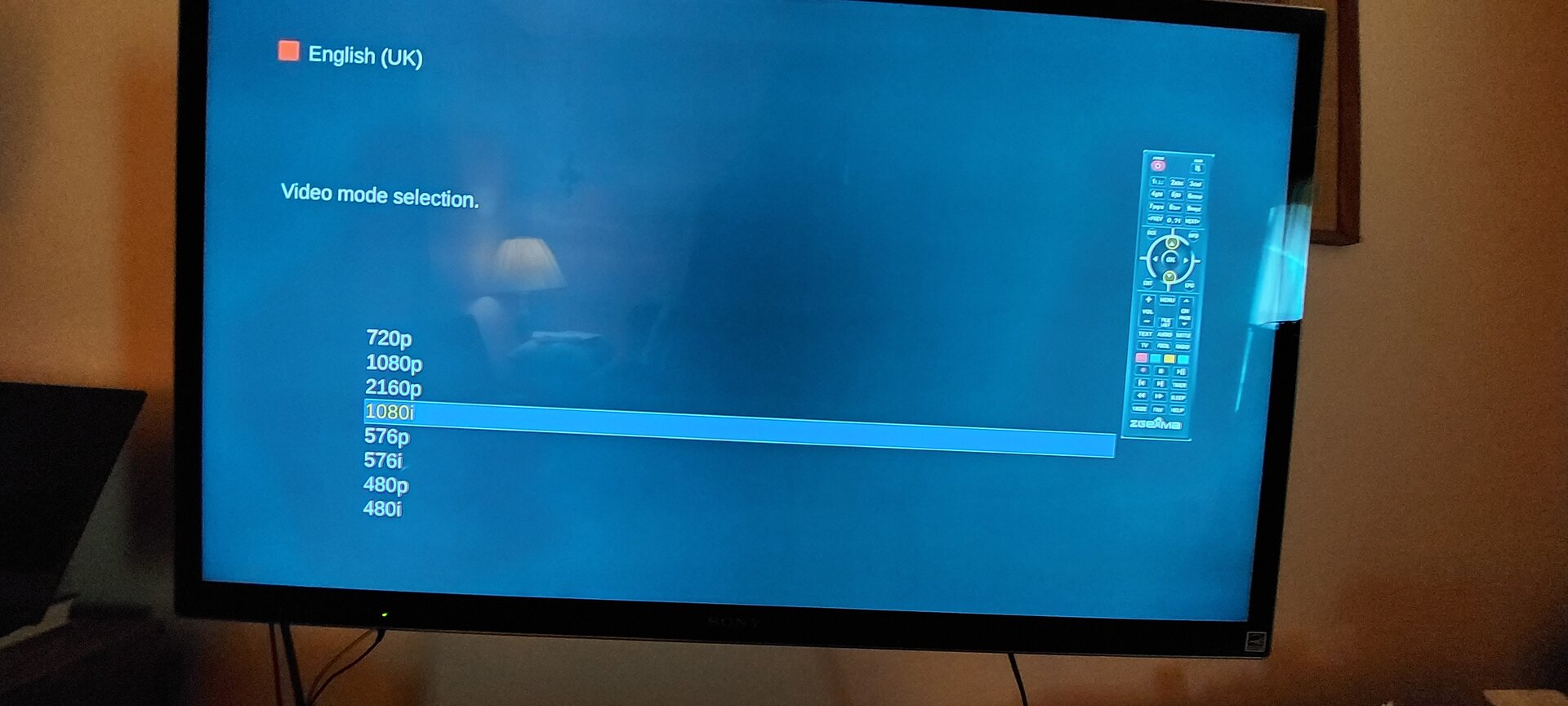

To clarify. When you flashed the image and it came up to the initial setup screen for video resolution. You did have a picture? "When I flashed the software it took me through the setup" has me a little fuzzy.
Are you getting through these steps and then the video craps out or not.

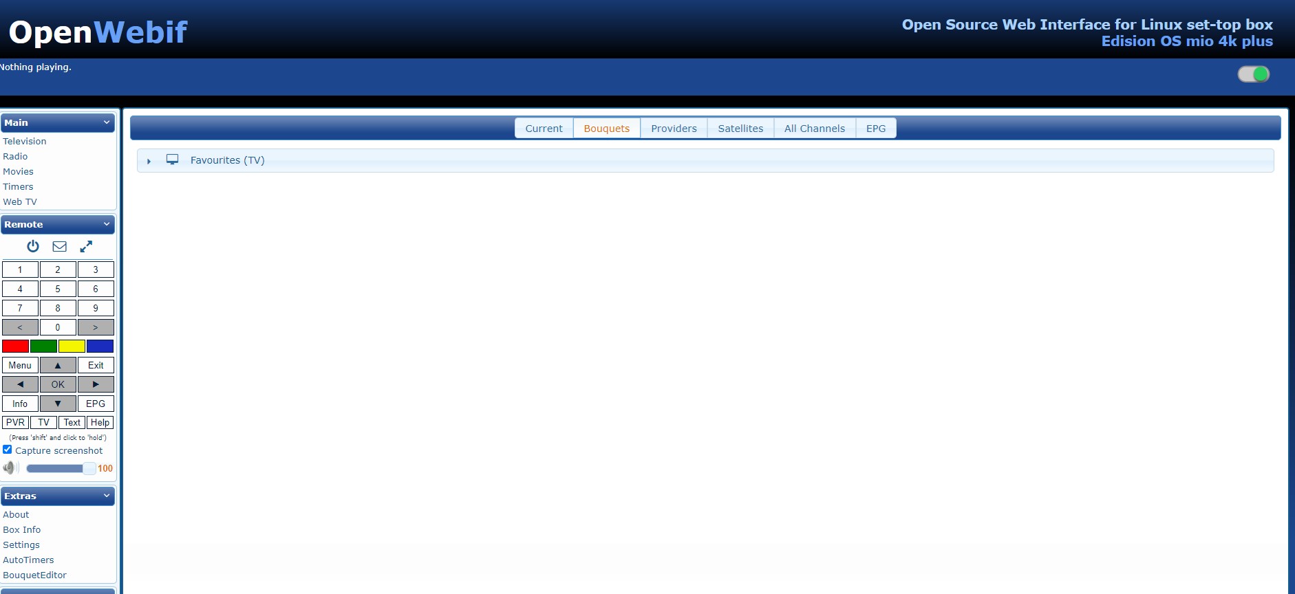

Fine when using WebIF. Yes, It goes through the setup menu when connected with ethernet, not HDMI. After flash, directly to setup as you show, but viewed only with (WebIF/ethernet).
NO Video when using HDMI output.
Upon power up, splash screen, then black screen, then TV or computer monitor indicates no input.
