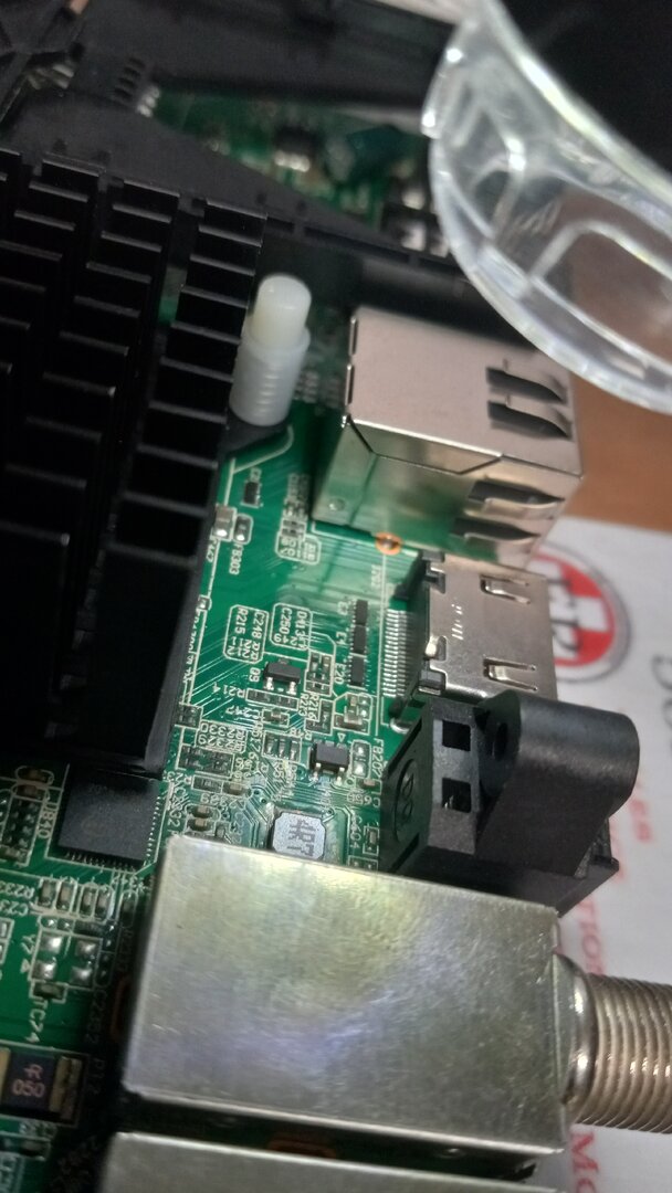

Dang.While the cover was off it would have been cool to see the pcb layout. Especially if there is an HDMI controller IC between the Broadcom and HDMI port.

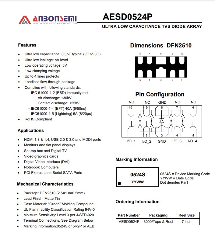

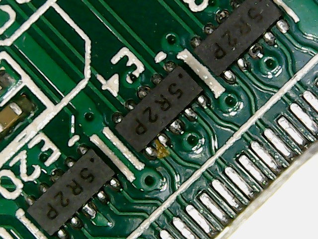

5R2P Diode array circuit too tiny for me to work on... maybe in my younger days.. chip dimensions 2.5×1.0×0.5mm.. line 40 of these chips up the long way and you would have the length of a cigarette..

Got it here. HDMI data on several lines is dead dead dead. Several TVS were shorted. SOIC runs blazing hot and was pulling around 1.8 amps. Cause? Bad cable? Or the same as X Box, PS.......hot swapping or plugging a loose HDMI cable back in when you notice it's loose with the juice on. Webif works fine. Until we overheat and go into current protection.
