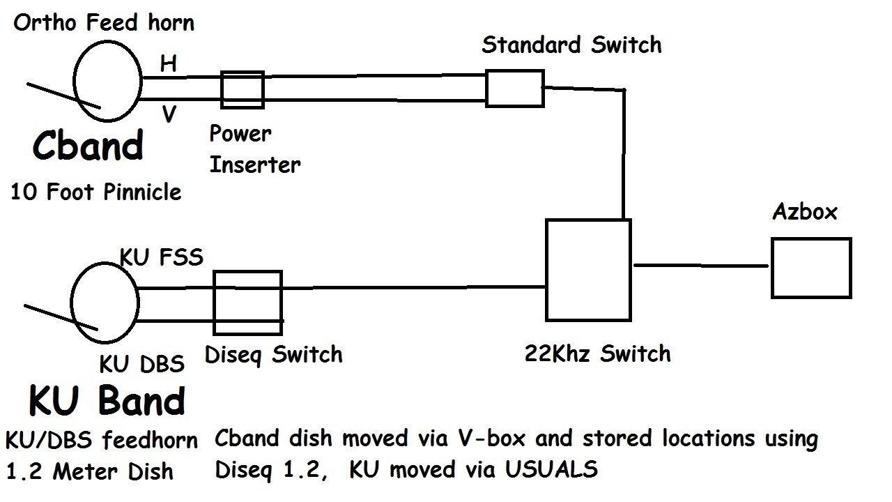

Maybe that's the problem is that I got a very old version of the software. I love jazup! Much better than Azup. The goal was to get the unit to dual boot as I have my setup stored with the older kernel. One specific thing that I didn't like is you couldn't do a combination of 22 khz switch, with other switches. I have a more complicated setup as I control everything through the AZ box. (see attached) To bad there wasnt a way to transfer stored positions through my Vbox back to the azbox with the enigma firmware. That would save me alot of time! Setup.jpg
22khz is controlled by lof switch. enigma2 has no problems controlling my diseqc and 22khz switches. once you have rc11 installed, updates can be done online.
