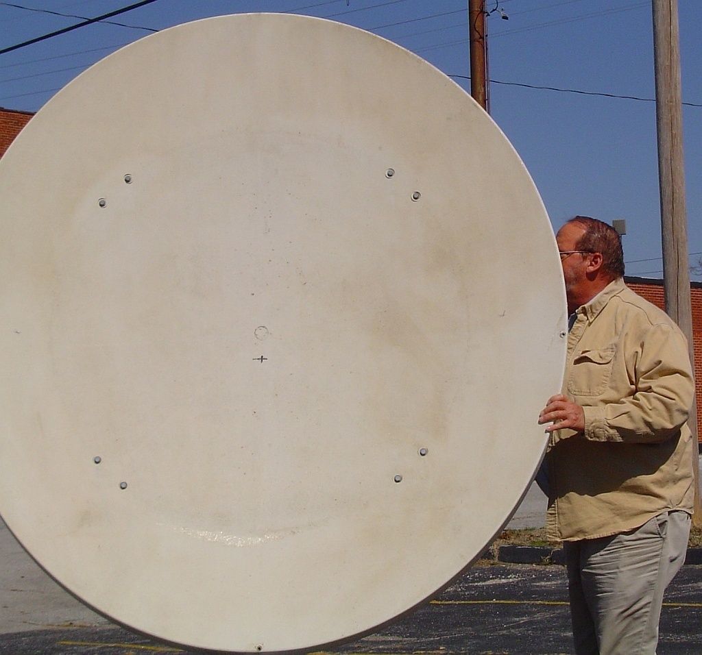

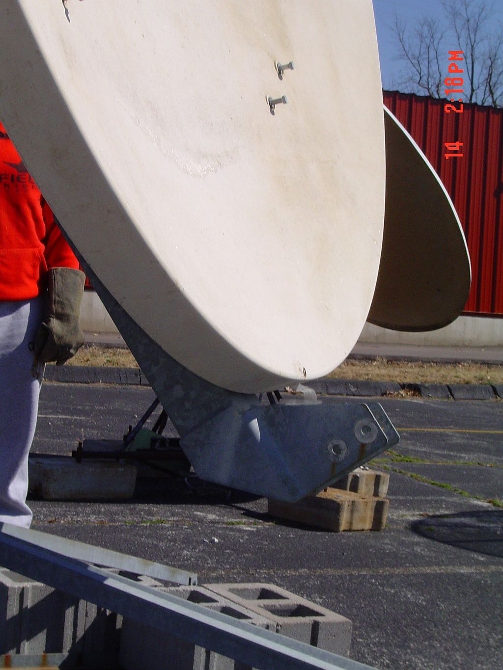

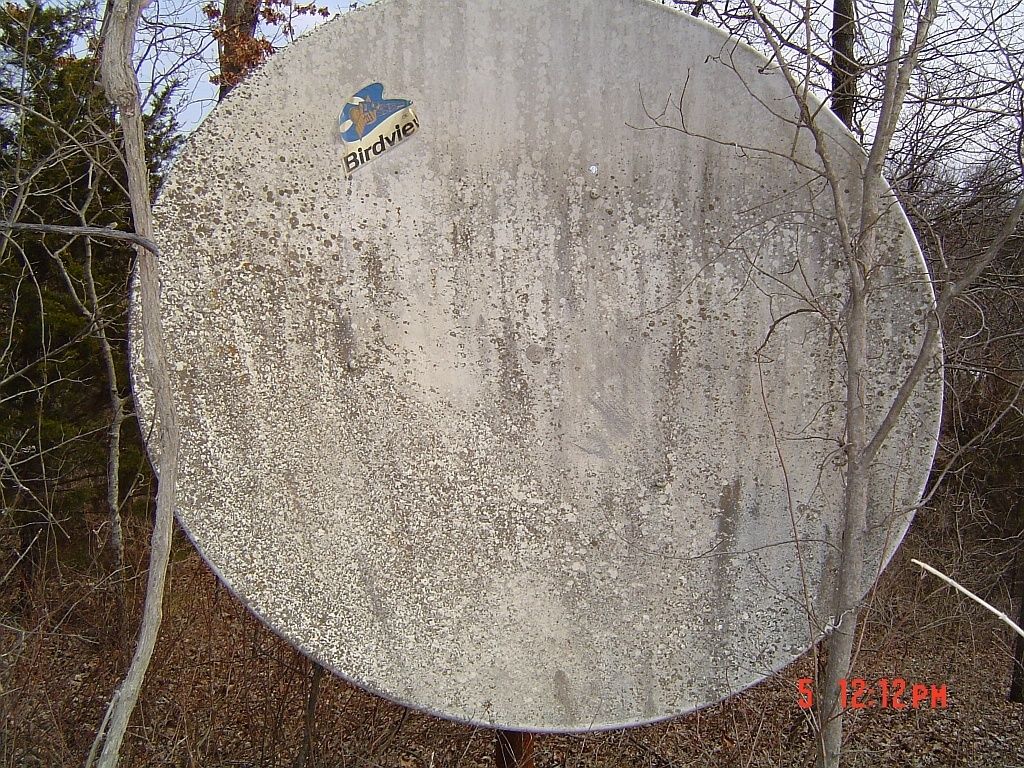

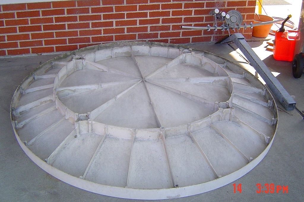

I will replace the scanning dish on the ground with a solid Birdview dish I found and wrote about a couple of months ago. Another reason for the change is that the H-H mount on the Birdview will allow for travel over to 30W all on the same dish. The Perfect 10 can see 30W, but because of the actuator, it won't go that far over.
I spent the morning tracking down the owner's phone number and have left a message asking about it. I also called and left a message with the owner of another Birdview solid in St. Louis that I wrote about several months ago. Of the two I am pretty sure I can pickup at least one. :cool:
The one in the pictures below have no support arms or scaler, but that shouldn't be too much problem to come up with using all-threads and a flat piece of aluminum or steel.

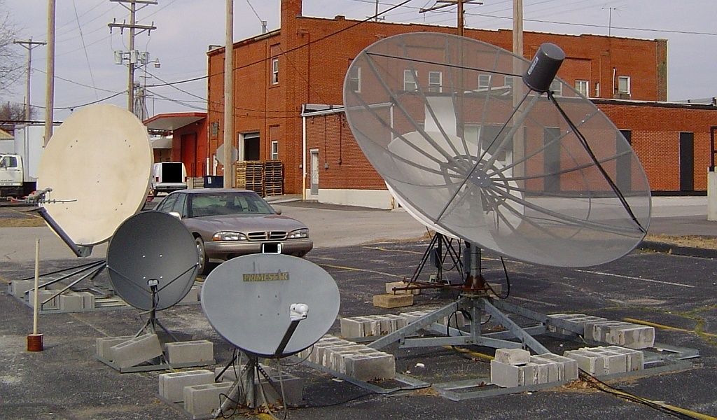

The Prodelin will go on a permanent mast about 2 foot to the right of where it is now, and it's NPRM will go to the roof for my 10 foot Unimesh dish.
I need to have some physical labor to keep building my strength and this will be the perfect interlude for the Ku project.

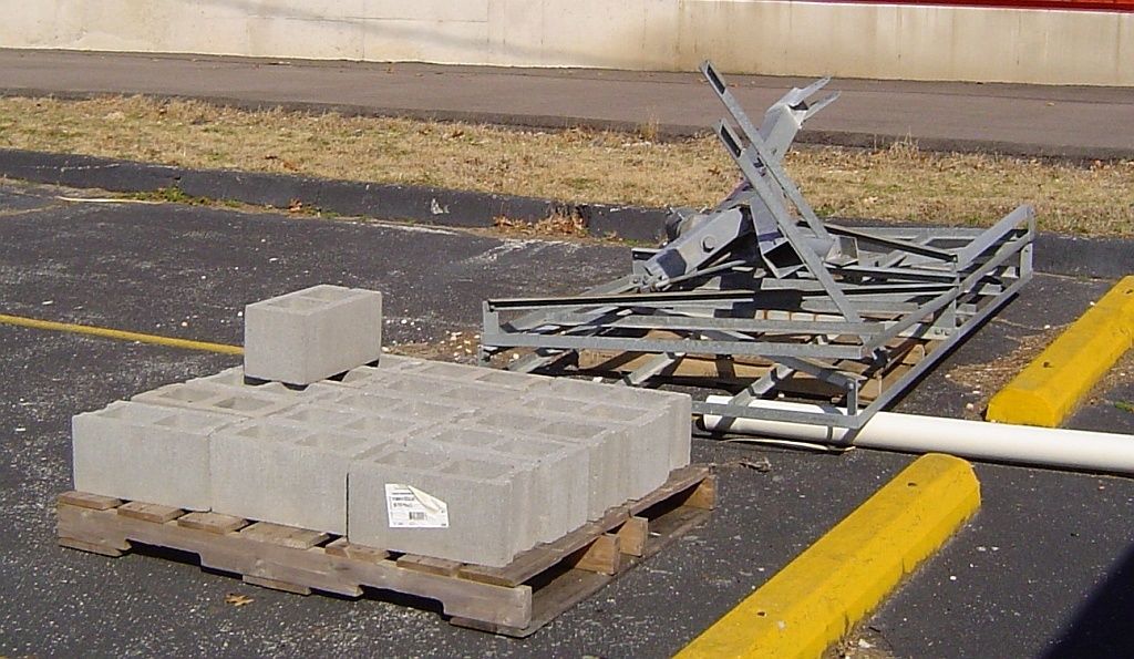

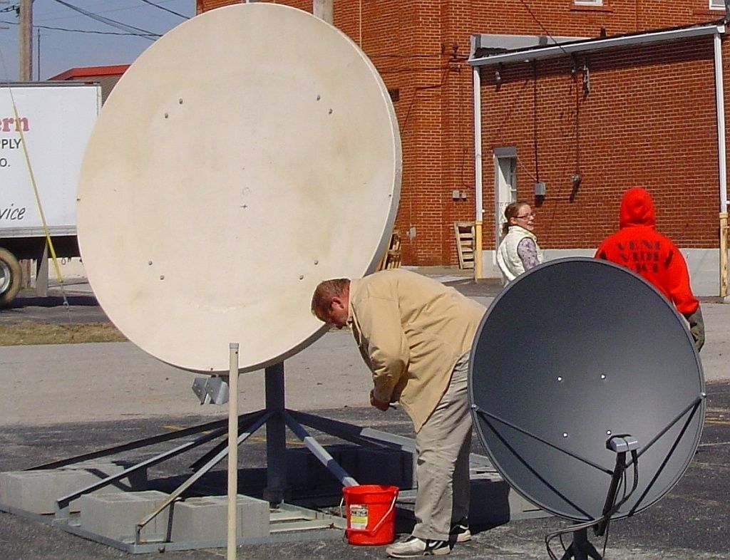

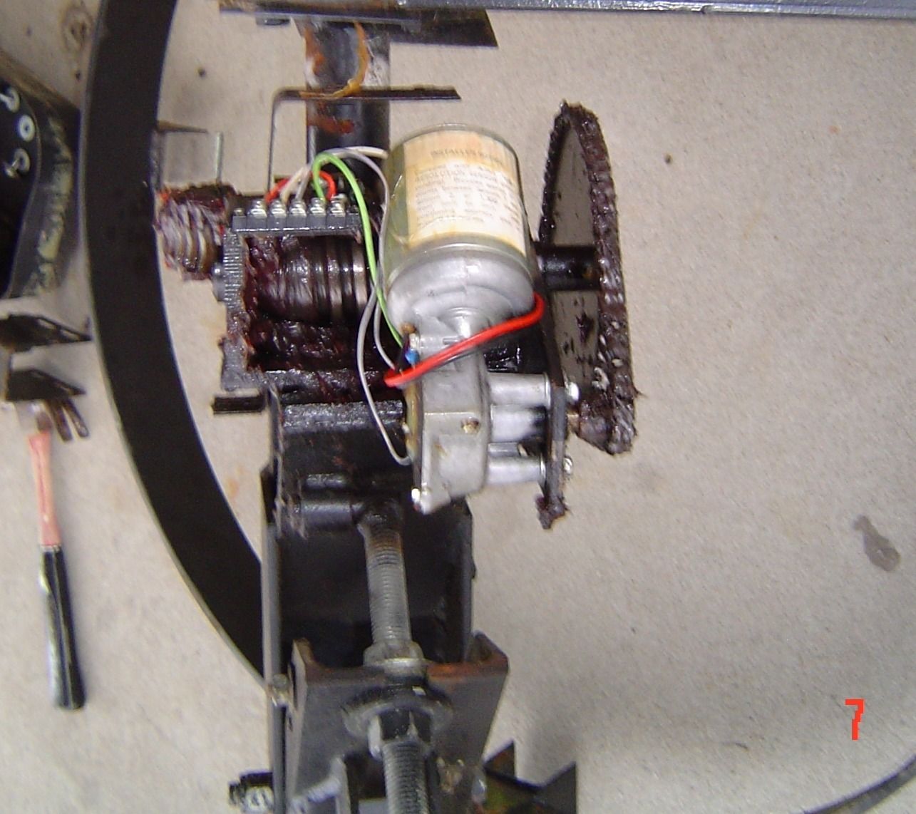

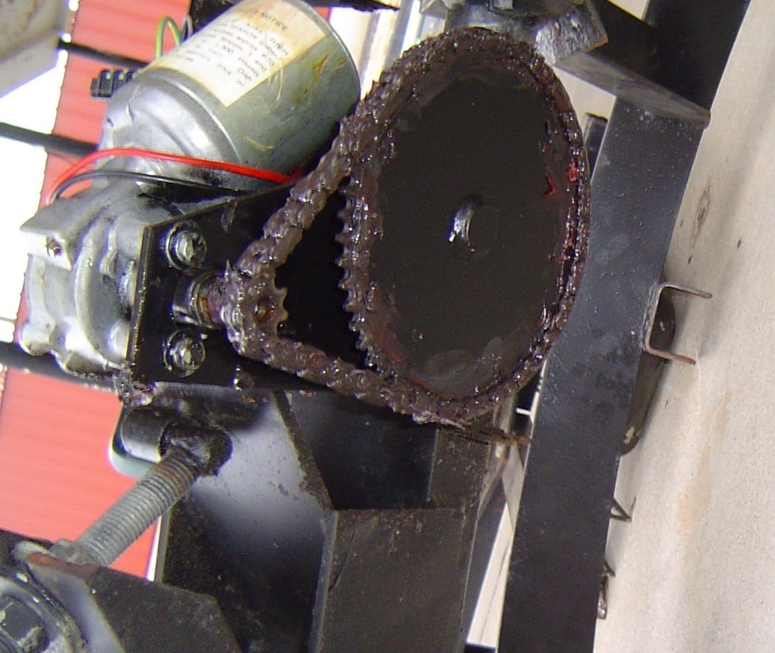

Here are the pics of the proposed two NPRMs and the Perfect 10 I will replace along with pictures of the Birdview I took today.
bv-foley-solid.jpg bv-foley-solid-rear.jpg bv-foley-solid-rear2.jpg bv-foley-solid-logo.jpg

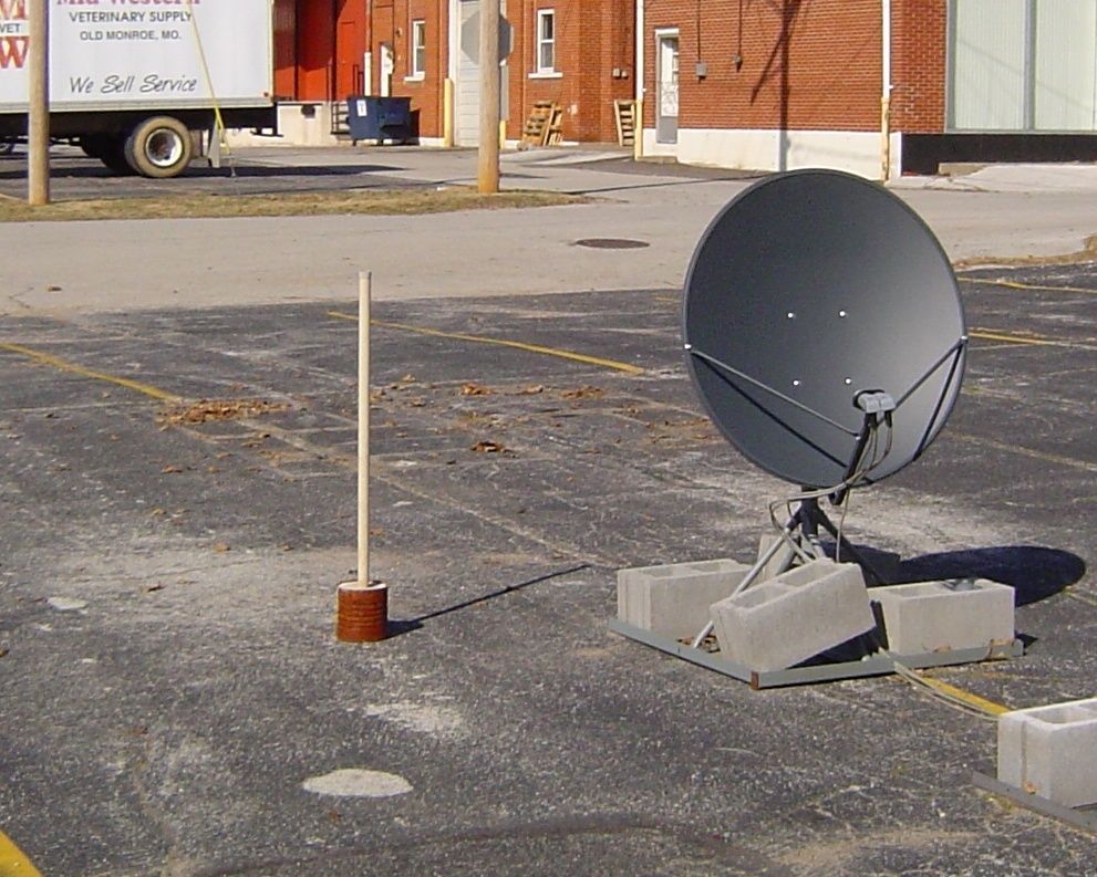

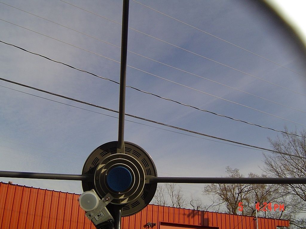

Well, I went out to prove to myself that the Perfect 10 could indeed "see" Hispasat at 30W. That's a 13.9 degree elevation for me here in Mid-America.
I un-hooked the actuator and had my son hold onto the dish and move it over to the position, and sure enough I got Cubavision at about 80% SQ, so a Birdview in the same spot and the same height should be fine.
I snapped a picture through the center hole in the dish, just so I could see what the dish sees. :)
Here is the pic:
I would love to do that with my parking lot, but they wouldn't last long with the traffic we get every day. I might have been able to get away with a cband over in the back corner but I just had a storage container dropped there, so I will have to make due with the lonely primestar dish I have for my office. Linuxman should have his own tv show, because he always has some interesting ideas and it is great following his adventures.
Nice keyhole shot Linuxman! Looks like about the low-limit in that direction, because of the building. A mountain has me block to the east, and trees, though I did find out I can hit intelsat 805. I think I might get to 55 with some tinkering, soon as the pollen count drops back down to something that don't make my head split so much.

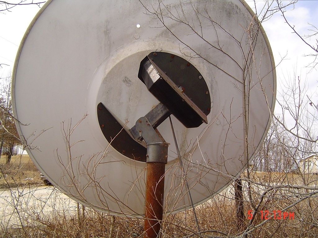

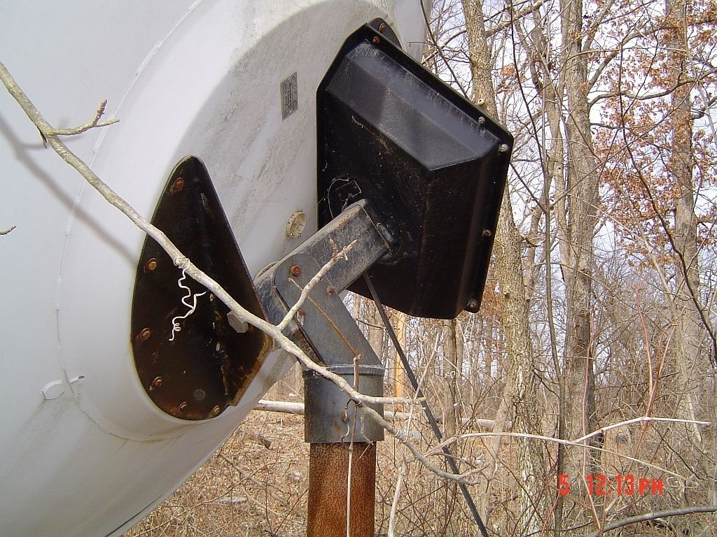

Fred, I see that Birdview has a hole in it. I'm guessing it's where one of the struts used to be bolted up? But even if it's not, I can think of nothing that should hinder it working at full capacity. With or without the hole?
ya made me look !
heh ! Ya made me look ! - :cool:
That hole on the BV is to bring the coax down from the LNB to the rear of the dish.
They all have it.
If you look closely on the back side, you'll see three funny little circles (slightly larger than the hole) located just outside the backing ring.
Those are where the LNB support struts screw into the front of the dish.
Can't really see 'em in the front shot, due to all the dirt.
Thanks Turbo. I believe that is the low-limit from my ground level. It just goes to show you what you can "see" over if you try. :)

Thanks Anole for explaining about the cable feed hole in the Birdview. You keep right on inspecting Al. An extra pair of eyes is always a good thing. :cool:

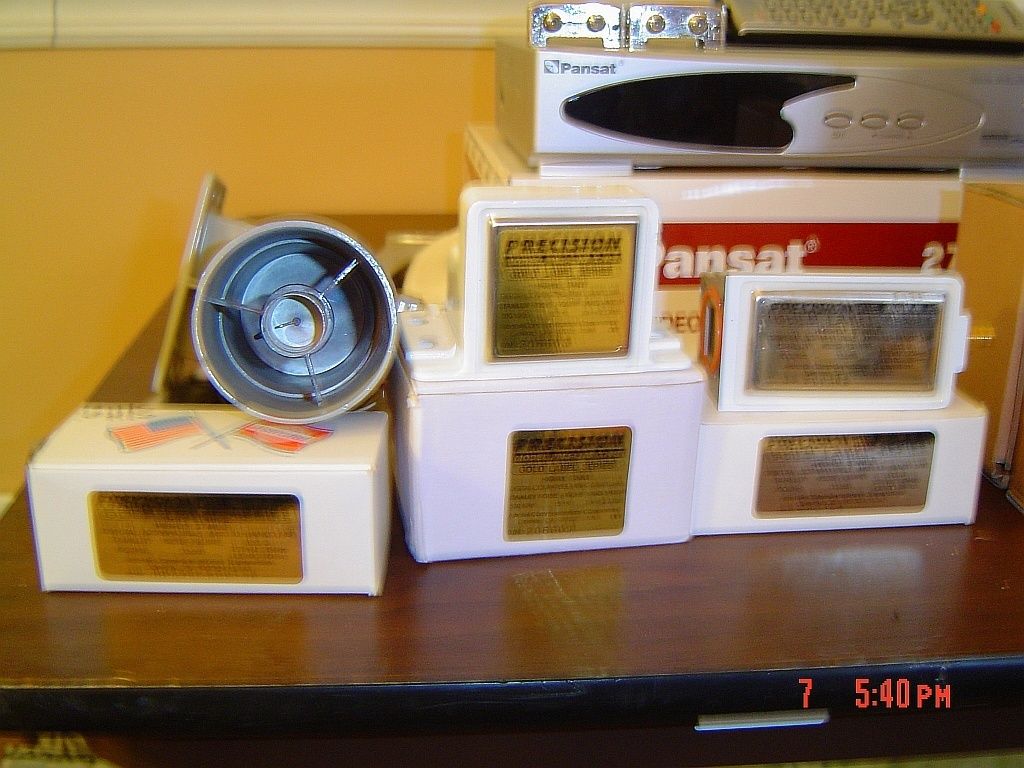

Then he asked if I wanted his old LNBs that he had been saving since 1995, and I said sure, why not thinking I was going to get another pile of older C-Band LNBs. He brought out several boxes of LNBs both C and Ku and I almost fell over. Some were almost brand new. He said he upgraded every couple of years and bought better brands.
We continued talking and he asked if I already had a dish, and I explained to him about my dish farm, 4DTV receivers, and MPEG2 receivers.
He said, hang on, I have an old MPEG2 receiver that I want to get rid of too. So into the house he went, and came out with a Pansat 2700a. I asked him if it worked, and he said yes, but all the channels went scrambled, so he quit using it. I suspect what it was used for, but didn't say a word. :cool:
All the extra LNBS, Feed-horns, and the Pansat, he just throwed in the deal. My car was pretty well loaded, and my son and I headed for home after thanking him profusely.

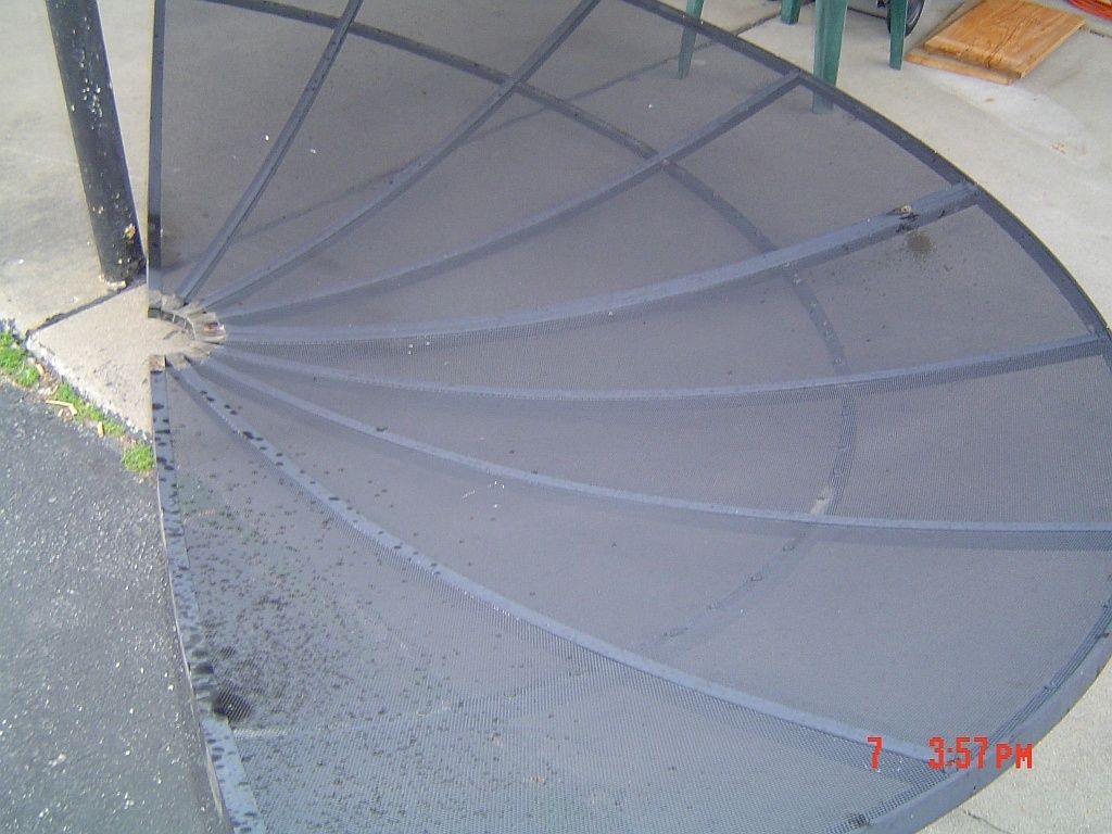

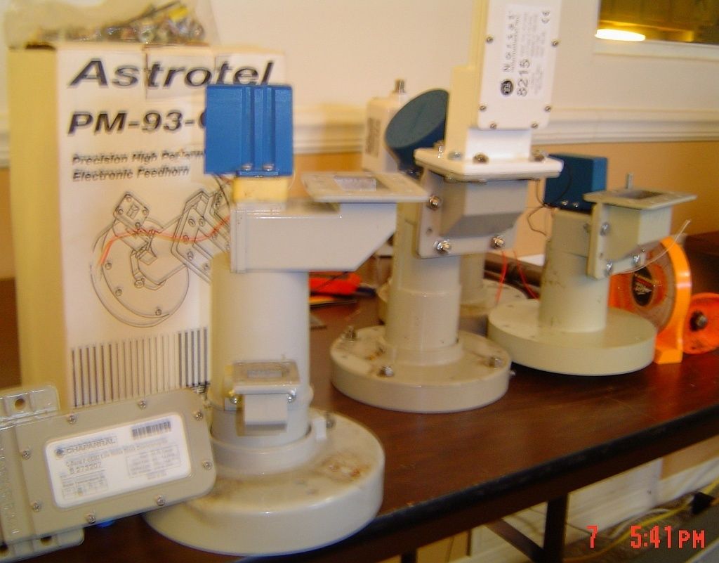

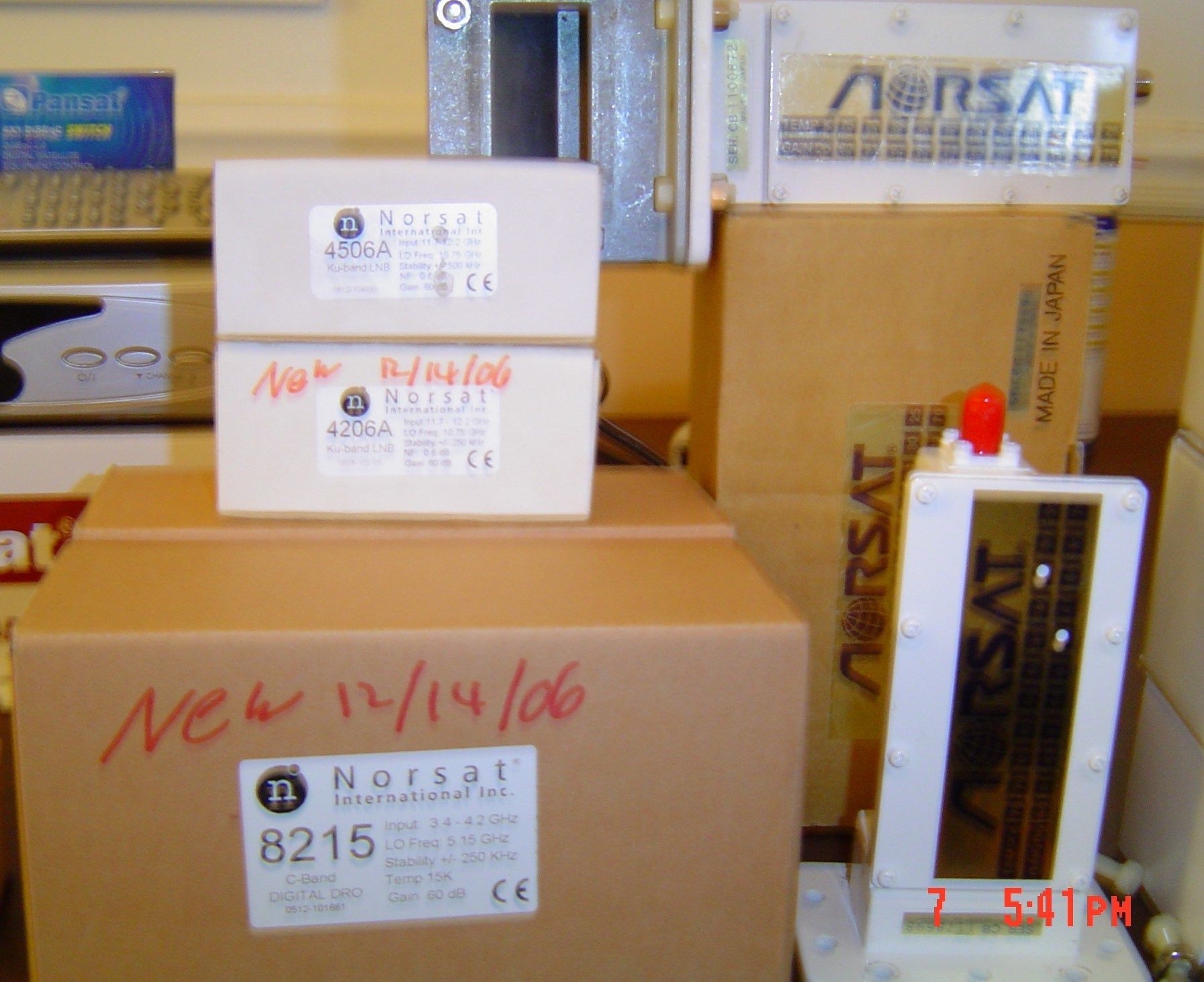

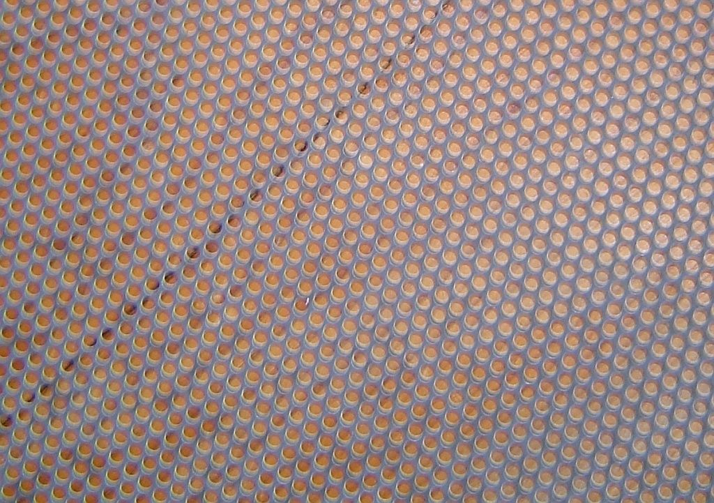

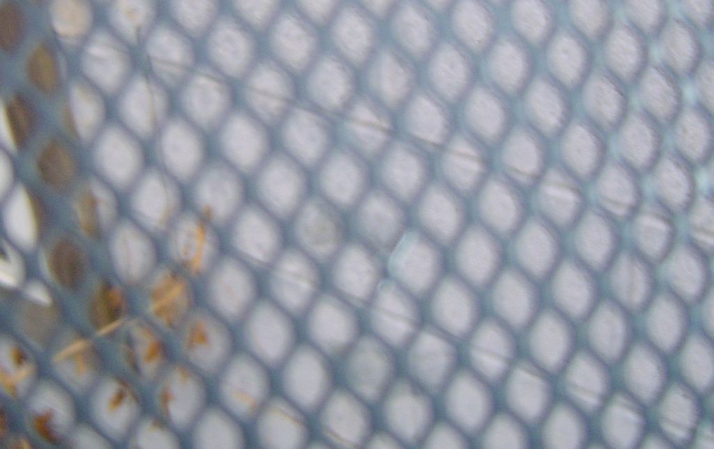

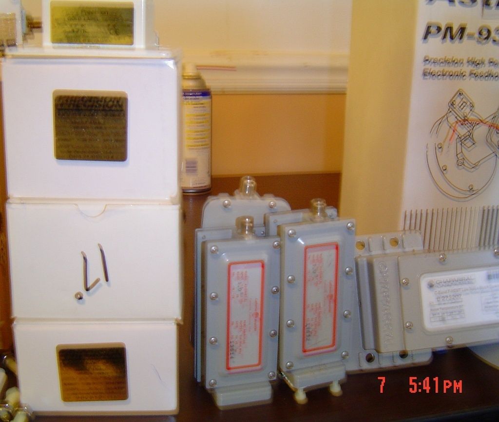

The dish turned out to be a perforated Unimesh 10 footer with the huge mounting ring for the AJAK mount. The co-rotor that came with the dish has a Norsat 8215 C-Band and a Norsat 4206a Ku lnb on it.
I got 2 Astrotel PM-93-C/Ku feed-horns, one new in the box.
Two extra Norsat 8215's, and two extra Norsat 4206a's, 3 or 4 Astrotel Prcision Gold label C-Band and Ku band lnbs, Cal-Amp Ku LNBs, and 2 Chaparall 20K c-band lnbs.
I also got another patent infringing Chaparral co-rotor which I could hardly believe when I saw it. He wasn't even using it because he had bought the newer one.
I couldn't believe what I ended up with after starting out to just get the dish and mount. So as I have said many times, usually when one door closes, another opens up with even better possibilities. :D
Here are the pics of everything including screen shots of my regular Unimesh mesh and the Perfed Unimesh mesh holes:
big-ajak.jpg big-ajak2.jpg big-ajak3.jpg exp-unimesh.jpg perfed-unimesh.jpg perfed-unimesh-half.jpg mid-ajak.jpg mid-ajak2.jpg precision-patent-infring-corotor.jpg norsat-c-ku-lnbs.jpg mixed-c-ku-lnbs.jpg c-ku-feed-horns.jpg

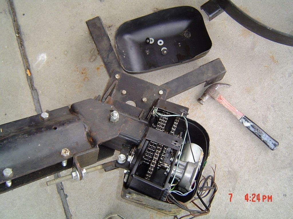

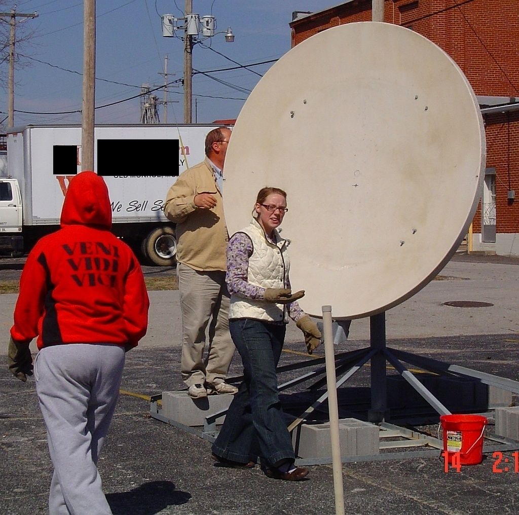

My son is gone all week-end, so I got some help from my daughters taking the Prodelin down and getting ready to drill the hole for the pole that it will set on. My wife was running the camera shots of me and the girls. One is 22 and the other is 18. The 22 year old has the glasses on. She came home from college this week-end, and wasn't planning on helping with dishes, but got roped into it anyway by the 18 year old with, "If I have to do it, you do to". :)
Here are the pics of the Prodelin coming down and being stowed for a few days.

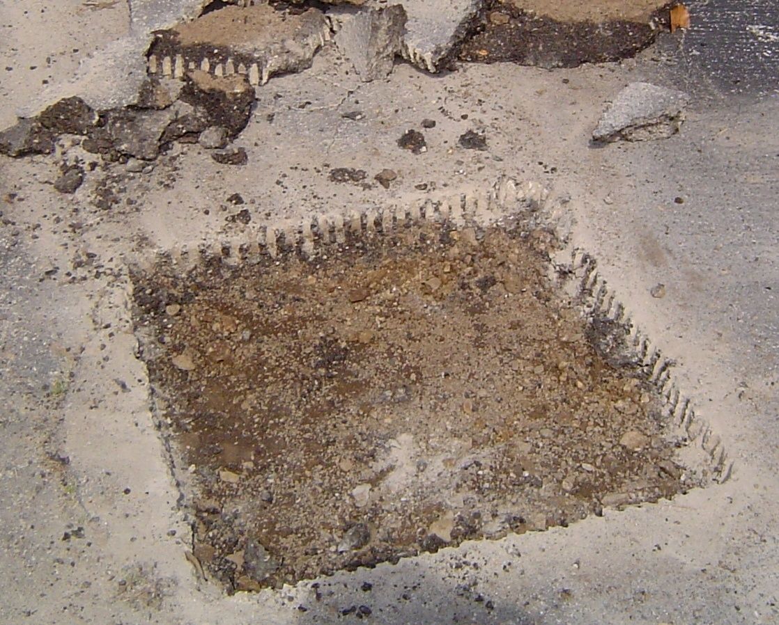

When you own a parking lot, this is what you have to do just to dig a hole.
I drew a 2' X 2' square on the asphalt and started drilling with my hammer drill and a masonry bit. I had to drill all the way around the square, and then using a crow bar and hammer, start cutting the left-overs from the holes 3 or 4 inches from the corner where I started.
I then managed to start prying it up. It comes out in chunks, but cracks right along the holes. I will have my son dig down so that the slab part is 4 inches thick.
Once I have the scanning dish down, I will do the same thing where it is now standing.
I then have a tractor with a 10" auger lined up to actually drill the holes down 3 feet.
Here is a picture:
