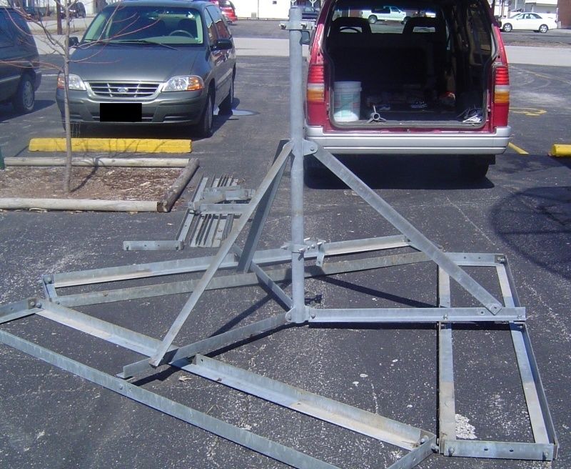

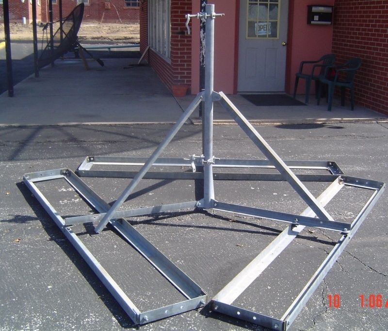

I picked these up this morning to put two more C-Band dishes on my roof. I didn't get them free. :(
I went to look at the one which the guy wanted $150.00 for, and discovered he had two, so I offered him $240.00 for both of them.
Those of you who know the prices of these things, let me know if you think I got a good deal or not. I think I did, but there is one draw back.
The center mast is only 2-3/8" OD, but it is schedule 80 pipe. It is 5' tall which I can probably cut down at least 6" and maybe a foot depending on the size of the dish I end up mounting. As you can see, there are holders there to put a bigger mast alongside of the existing one. It is 9' across from a triangle point straight to the outside of a flat side. It is made for laying blocks in for ballast. Each outside panel piece is 8' long.
My plan is to put a piece of 2-7/8" OD schedule 80 pipe which ends up being just shy of 3" over the existing mast about 18" down from the top and weld it at the top and bottom. That should allow me to put most 7.5 - 8.5 foot dishes on the mast with no issues.
So let me know what you guys think!
If you have any suggestions, feel free to throw them out there.
If you think I got took, tell me!
Edit: Forgot! Here are the pictures:

Hey thats cool. I think it was worth it! I mean, if that was the mount i needed I too would have spent that. I'd be scared about the size differences (whats your pole mount size) for my 4 inch, solid aluminum 9 footer, and steel frame work being supported on that. But you've already got it all on there, right? Installed and on the roof? Wow, i'd like to see that picture!
Like the dish in the background :) Is this all at your place of business? So no cband at home?
Good luck on the inexpensive 4dtv :D Cheffwan was trying to bid on cheaper 4dtv's as they went by, but ended up with the $300 range. I think its worth the other $100-$150 to get the warranty and everything :D
PS I spent $70, just on the new steel pole I got before, so twice that for an engineered frame sounds spiffy.
Not a bad deal at all, new they cost a pretty penny, many things you can do to get a bigger pipe on it, rip the middle out go to a local welding shop and get it made, or you can weld a bigger pipe onto the other pipe, basically get a pipe made to go on maybe 15"-25" (depending on your dish mount) with holes like a dish mount at the bottom slide it on the smaller pipe and bolt it in maybe even weld it, and if you wish you can weld or bolt some other bars for more support.

Nice find Fred! I think you got a good deal for them too. I hope the one sleeve will be enough? All my BUD's (10'ers) have 3+1/2" pipe fittings, well one is 4" and one is 5+1/2". If your 7+1/2' BUD's polar mount will fit the less than 3", thats fine. I also have a 5' BUD (don't use it for C-band), it had a 2+5/8ths" fit (fixed mount). I changed it to a polar mount with a 3+1/2" fit.

It's hard to tell from the photos, how many cinderblocks will it take per side.
From what I have read on the Rohn Antenna Mount site, an 8 foot dish would need about 1000 Lbs to sustain a 60 Mph wind.
A concrete block weighs 40 Lbs on average so 25 should do it. 8 to a side on the mounts in the picture.
There is no way to anticipate every kind of catastrophe that could come. Prepare as best you can and carry good insurance.
