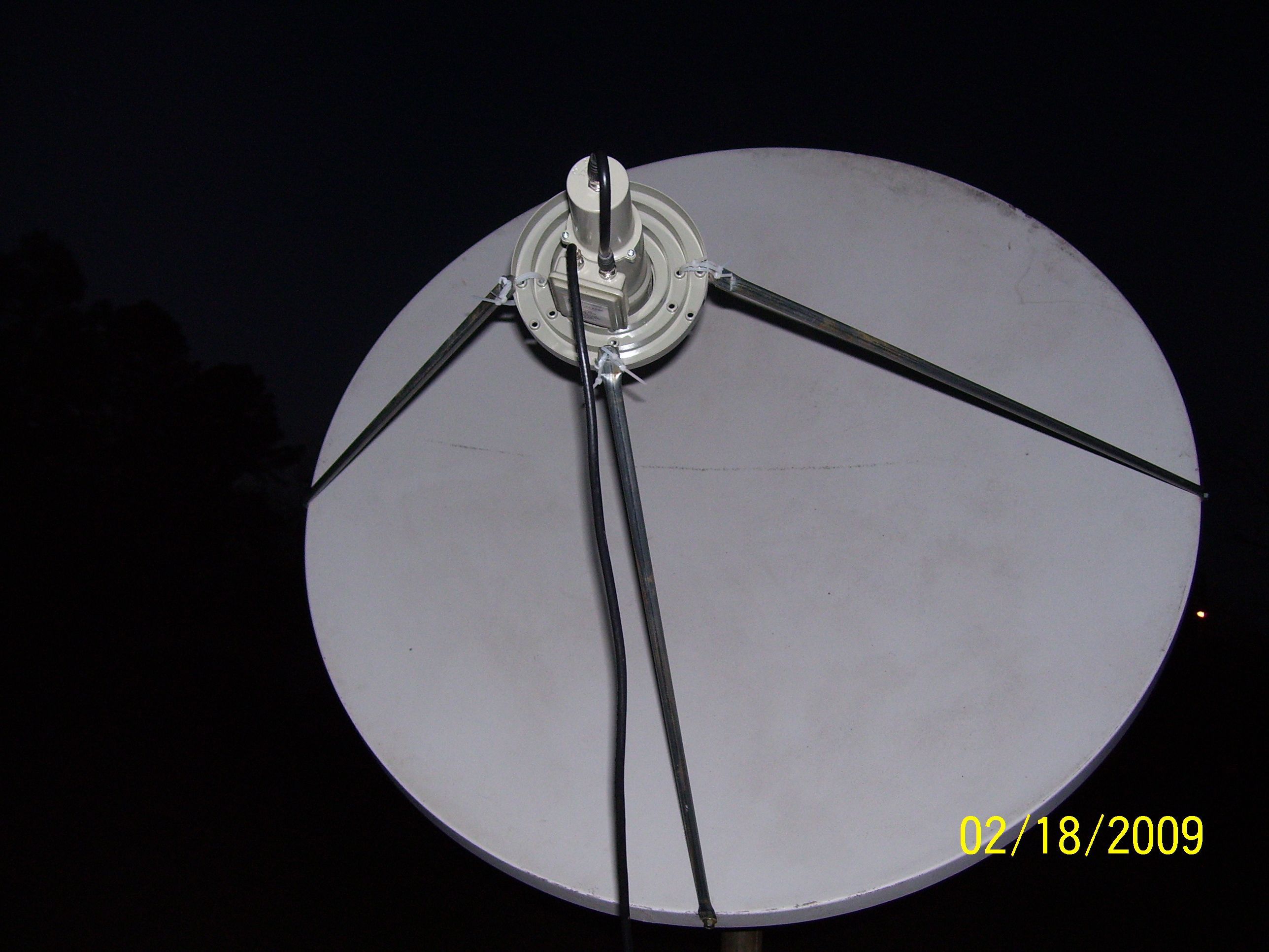

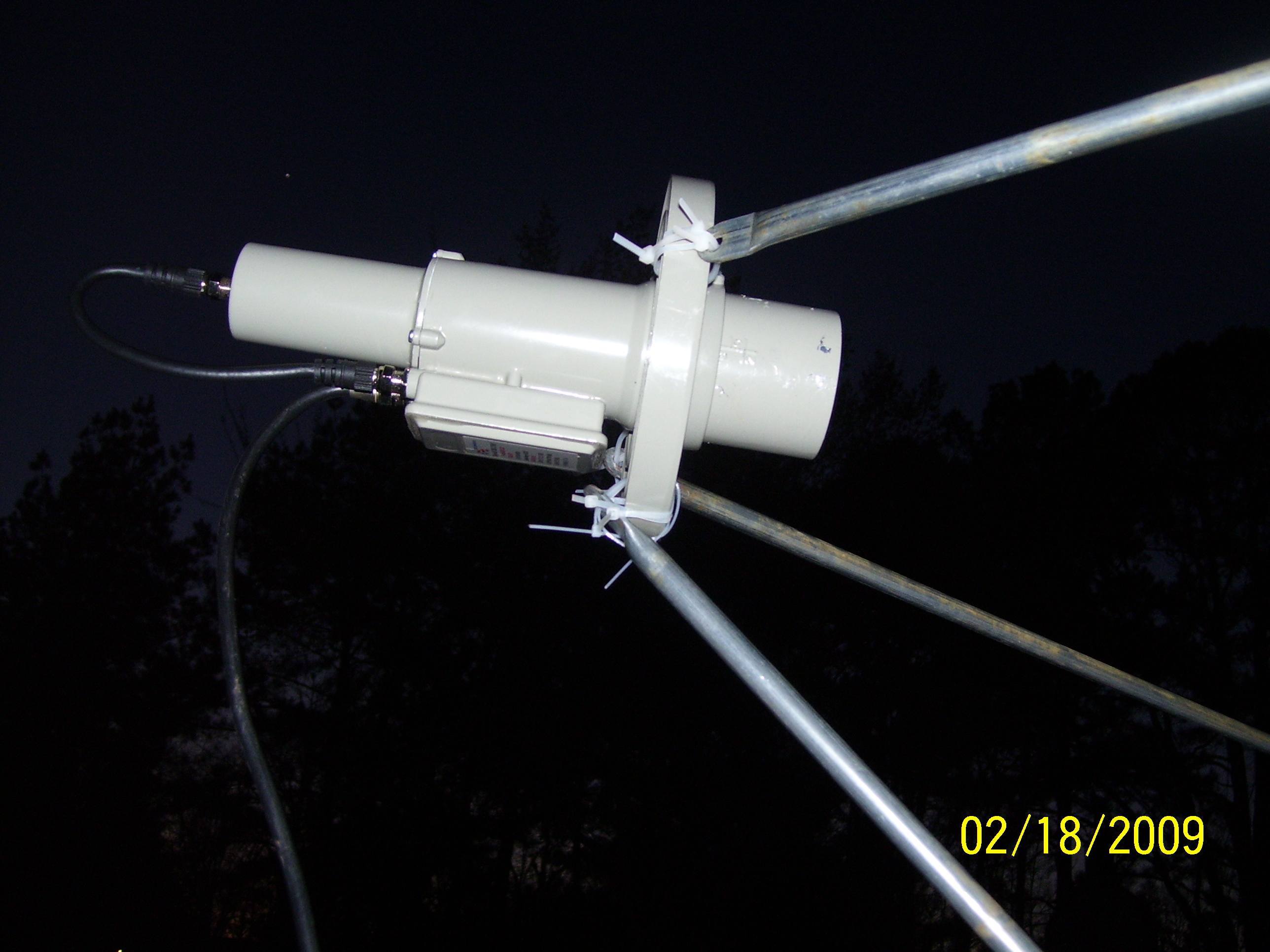

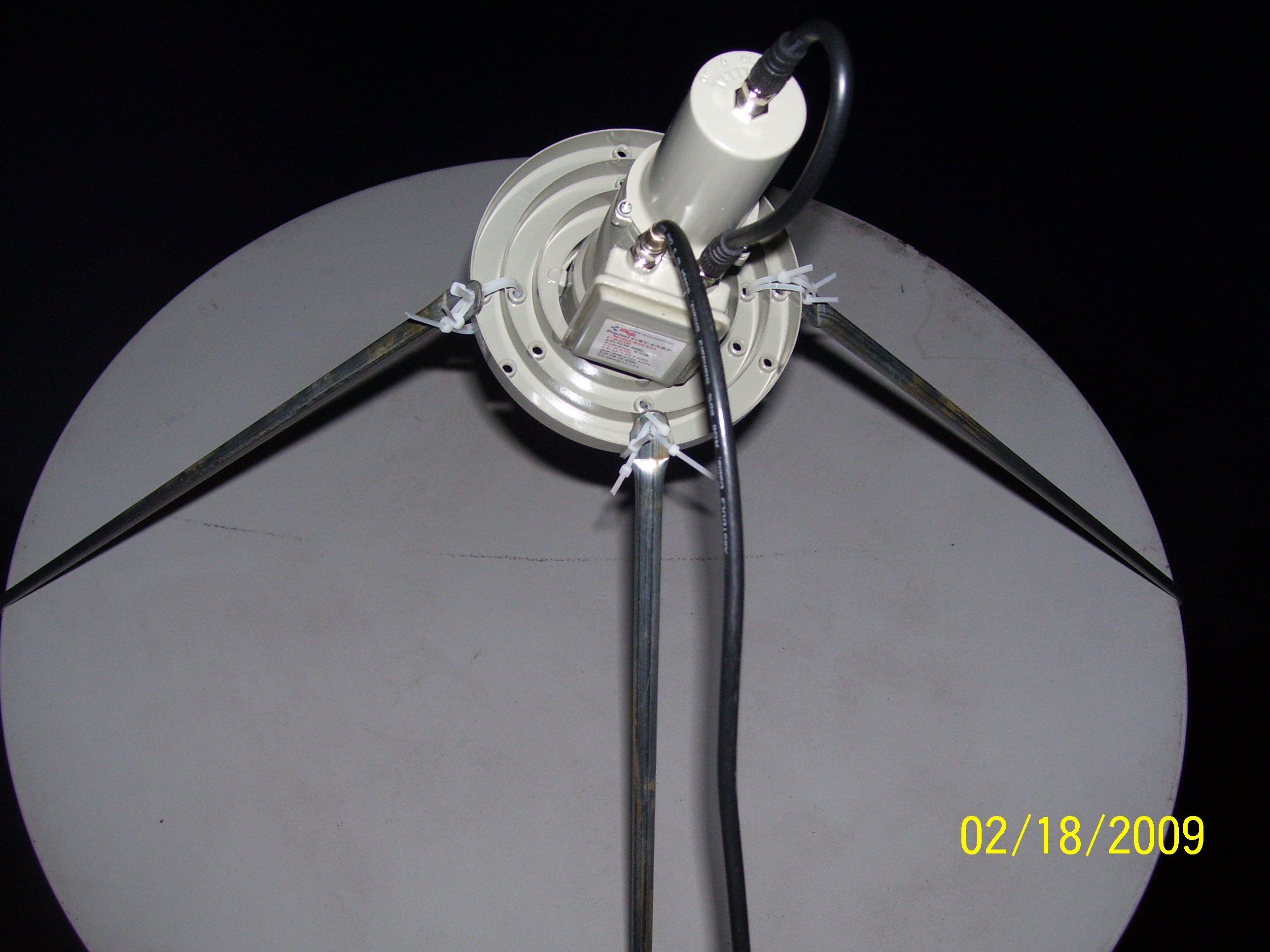

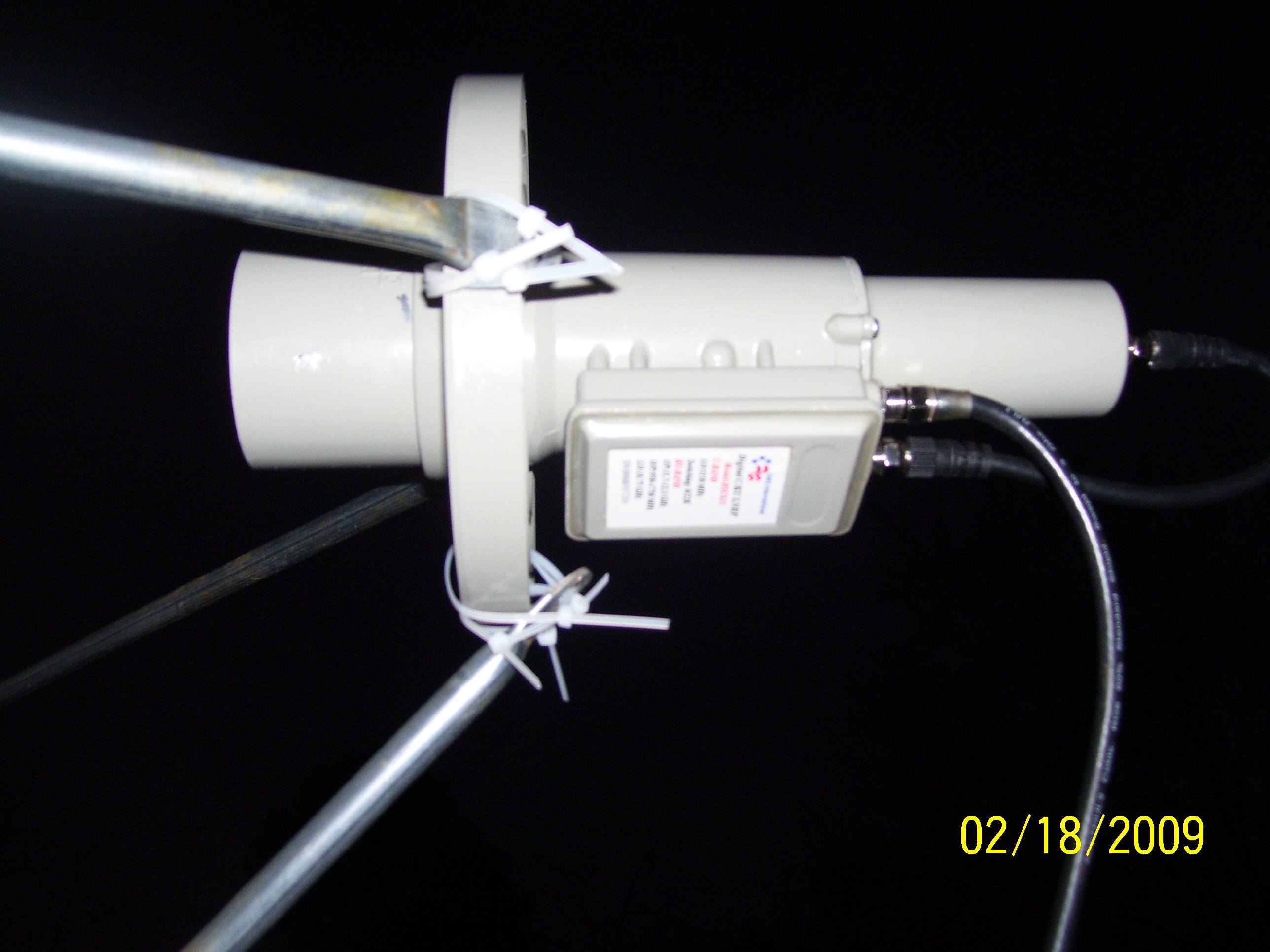

I got my new bsc 621 combo lnb today. Well I noticed right off the bat I couldnt get the arms to mount onto the feedhorn. I have a 1.2 meter channelmaster with the three support arms.
I ended up taking 10 tiewraps and just wrapping the thing to get it supported, and brother it is sturdy!

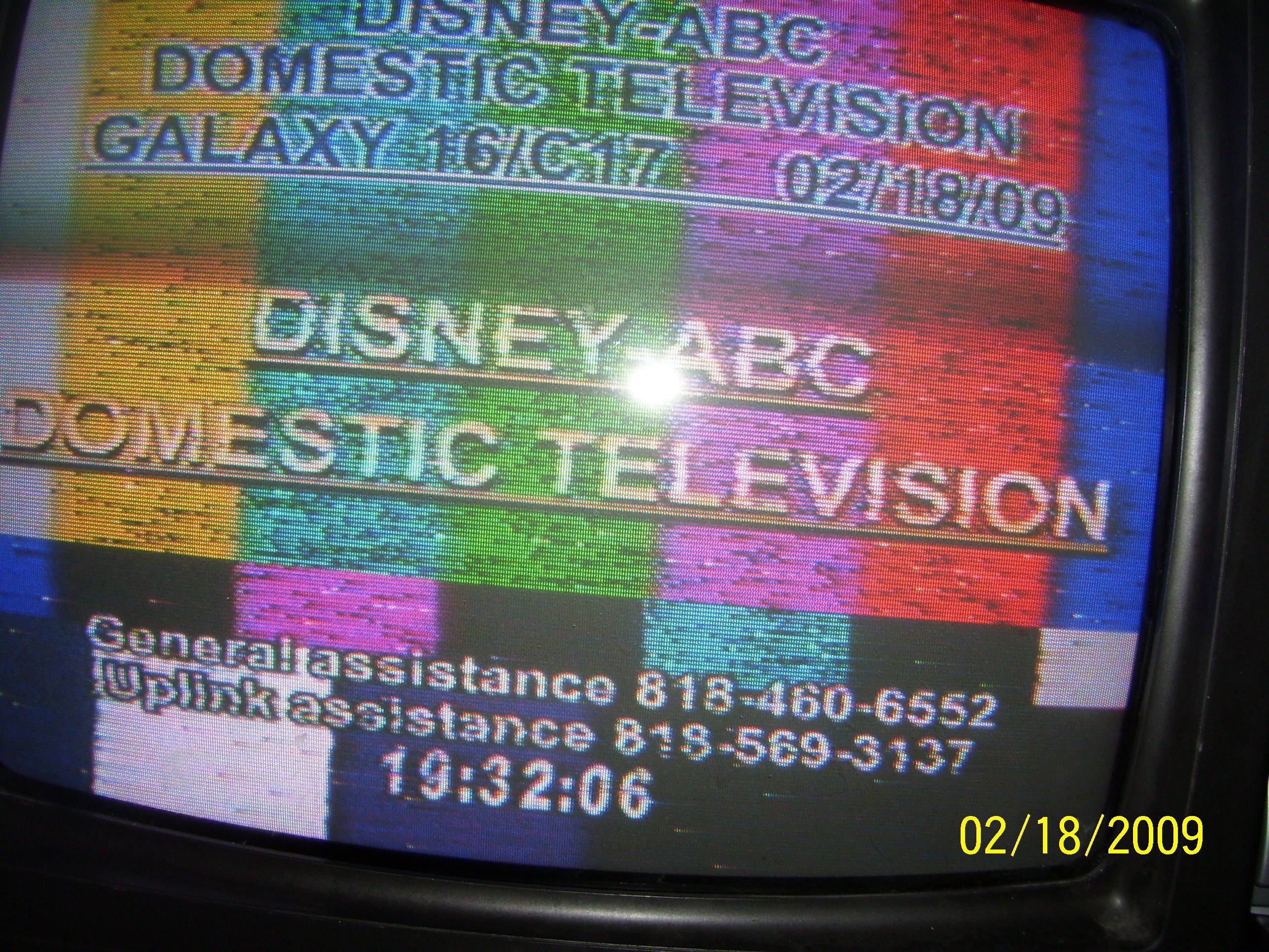

Well again for the hell of it I pulled a blind scan, and could you believe it! I hit 14 tps off 99 galaxy 16!! My levels on three tps are up to 78pct! and several others in the 60s! And I dont even have this setup well yet!

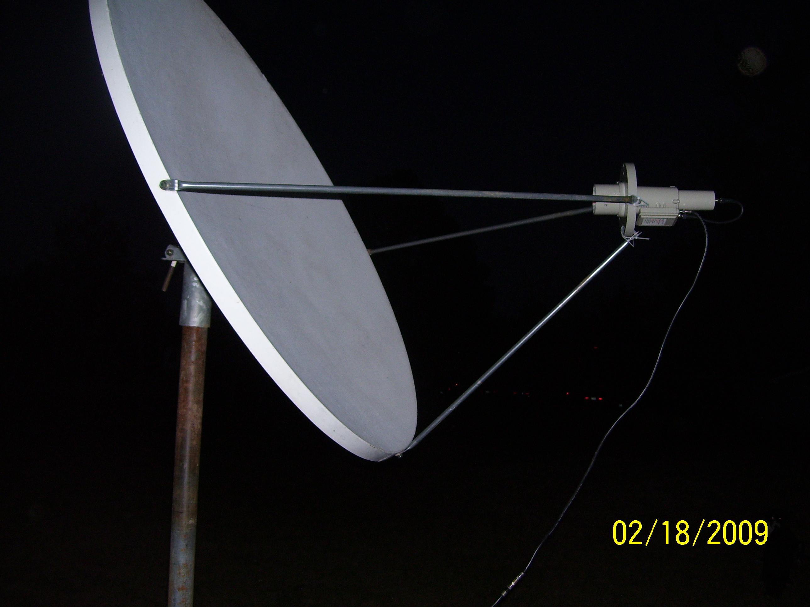

MY PICS OF MY 4 FOOT MINI BUD WITH THE BSC 621
HEY ICEBERG, HERE ARE MY PICS THAT I TOOK OF MY TEMPORARY ATTACHED BSC621, DONT LAUGH, IT IS JUST A TEMP FIX, I AM LOOKING INTO GETTING A BRACKET FOR THIS TO WORK BETTER.
HERE ARE MY PICS, IT WAS A BIT DARK, DIDNT GET HOME TIL LATE

yeah, i know! lol! I am just playing with it right now, hit satmex 6 at a high of 85 pct quality on the c band, though I know no spanish! I have just the satfinder so I didnt know what I was hitting, thought maybe I was hitting 123,
thanks iceberg
I tried dow, but couldnt find any info for non dealers. Do you think the geosat pro c band clamp would work? It looks like it to me.
I have the same dish and the lnb and I also have a geosat pro C band clamp. It will work I know it will but I can not figur it out yet. It is 2" higher than the lnb that came on my dish. so I am working on it. Did you just spread the arms and tie-wrap the scalar ring to it . I did not think it would work so I did not try that. I know I should think........ Looks real good keep up the good work
Yeah I actually tightened the arms really tight and tie wrapped them to the ring, that way there was no give in them. I tried like hell with the bolts to bolt the arms to the ring, but that wasnt going to happen! It is getting decent quality already, ranging from the 40's to high 80's on c band and hitting 50's and 60's on ku, so I can only imagine what it will hit when setup correctly, the focal point is off too and still hitting okay numbers.
I am very surprised in the c band numbers, I used to think there was no way to get c band on a minus 6 foot dish.:)
