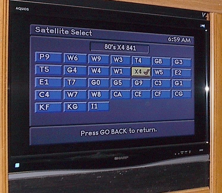

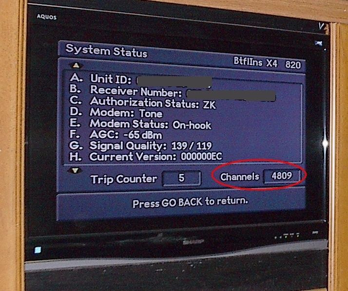

Important Do this now for next year
Sneak Preview :eek:
If you don't have X4's new map programmed in go get it now. This can be done by going to W5-600 and sitting there for a bit. You will see an increase in channel count. Then program it in at W5's position. The tile will sit left of W5. (see pictures) When done check the DMX channels and make sure they are working. There are more steps but they can't be released yet.
This needs to be in your receiver for next year for the conversion so go get it if its not in your 4D.

4782 after an accidental "master reset" intended for my DSR 410. Sounds like all the available "stuff" is downloaded now before retiring the 4D and taking it offline?
If you want to keep all your satellite tiles as is you have to get them now on G1-3 once 1/4 rolls around they will be gone and probably never seen to that extent again except using 4play.
Channel count numbers will vary since some 4D's have older maps which actually give you more stuff, like mine 4809 :) I refuse to do A MR, I figure the more channels the better. The latest G1-3 Motorola maps are leaner. Too bad we can't archive these maps someplace.
I have been sitting on W5 600 for about a 1/2 hour with my 920. My channel count is sitting at 5030. Tried to get X1 after unplugging receiver and plugging back in. Do I have to do an MR, I am not at 1920 yet sitting at 1714 so I should have lots on room left.

I think I'm picking up a different X4. It's showing up to the right of W5 instead of the left like you said and my channel count is only 4782 and my X4 DMX is in the 900's and I do not get the 820 shown in your pic. (DSR-922).
I can only go by what my 922 shows. Some are getting the 410 channel numbers some are getting the 4DTV channel numbers. I think it has to do if you had the original old ku X4 map in the DSR or not, mine did. I don't think that will be an issue next year except for channel numbers. I kinda like having the 4DTV numbers since I'm more familiar with them.
I think there will be variables but as long as we can subscribe that shouldn't be an issue. From our testing it looks like the guide will not work if you retain all functionality. If you need that to work it looks like the 4D needs to be a X4 brick. (I think I'm saying too much for now)
