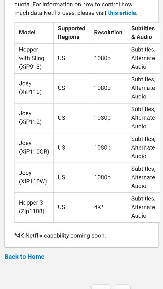

4k is included in my Netflix subscription, but I am still not getting it on the Hopper. Is anyone getting Netflix 4k via their Hopper? I called Dish and the representative had no idea what I was talking about.
This maybe a rhetorical question is your tv uhd? Also what is your internet speed? You atleast 25 mbps. Try this search 4k or uhd on the search i found content that way.
Yes, my tv is UHD. I get Netflix UHD from my Roku 4 and from the Netflix app on my tv . My internet speed is 60 mbps. I can watch in UHD on another device, but if it available from Dish, I should be able to get it. from them too.
So im guess the content i pulled was not 4k.

Until Dish gets the HDCP 2.2 implemented as they did with U307 for one day, you won't get 4K Netflix. Hopefully a new upgrade will come out soon and get it working right.
