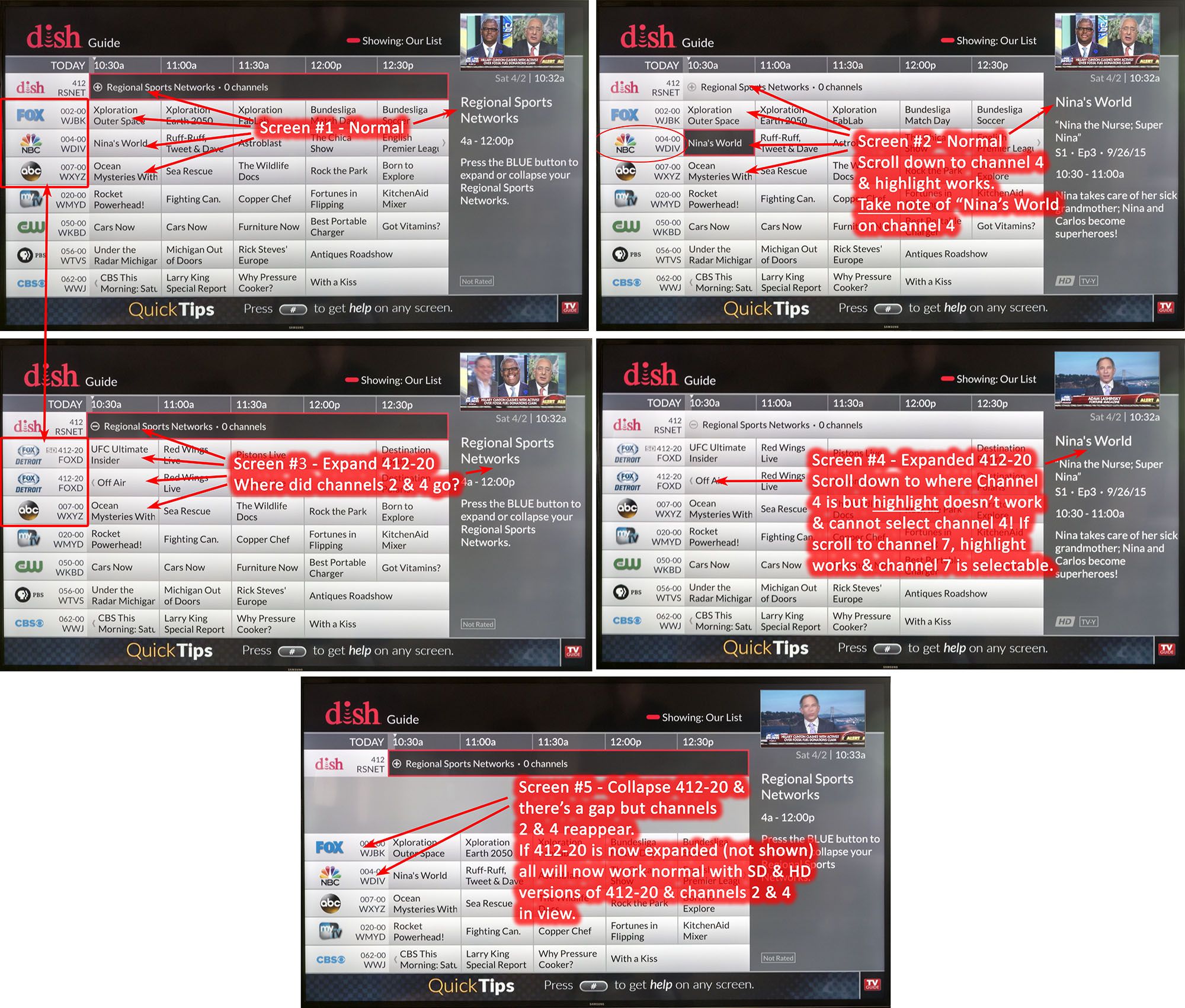

Anyone having this issue? I live in Michigan & Fox Sports Detroit (FSD), channel 412-20, is our local sports package.
Using the menu to get to 412-20 shows FSD highlighted (identified as Regional Sports Networks) in black (Screen #1).
Scroll from 412-20 down two channels (Screen #2) to WDIV Detroit, channel 4 (NBC) & menu is working as it should.
Scroll back to 412-20 FSD, then expand 412-20 to reveal SD & HD versions (Screen #3) & channels 2 & 4 disappear from menu.
Scroll down twice (Screen #4) & neither 412-20 SD or HD will highlight but the menu apparently thinks it's over channel 4 even though it's not visible or highlighted. The channel cannot be selected.
Scroll up to 412-20 (Screen #5) & collapse 412-20 & there's a gap where SD & HD versions should of been but channels 2 & 4 reappear. Expand 412-20 now & all will be normal with both SD & HD versions of 412-20 & both channels 2 & 4 in view.
I know this will be eventually addressed by Dish & is just a quirk. Just wondered if others might have this as well?
I had this issue as well but reversing the sort order seems to have resolved it.
Odd, but true. Like you I reversed the menu & cannot duplicate the issue. I never thought it would make a difference but it does! :)

My two H2s do this as well with U204 software.
Notice it chops off channel 2 and 3 of my locals.
