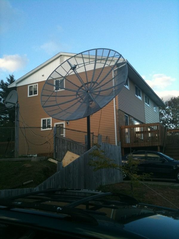

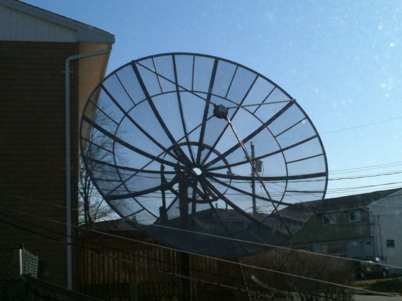

I've been thinking about how to do this for a few days. The scalar on my dish is held in place by a large clamp which is suspended from four struts. And the struts are installed on the vertical and horizontal planes. I knew this was inconvenient as soon as I installed the ortho but what's done is done.
Dunno if the picture shows it too clearly or not. This is before the ortho. I'd take a closer one but I'm currently visiting inlaws and I'm going stir crazy.
