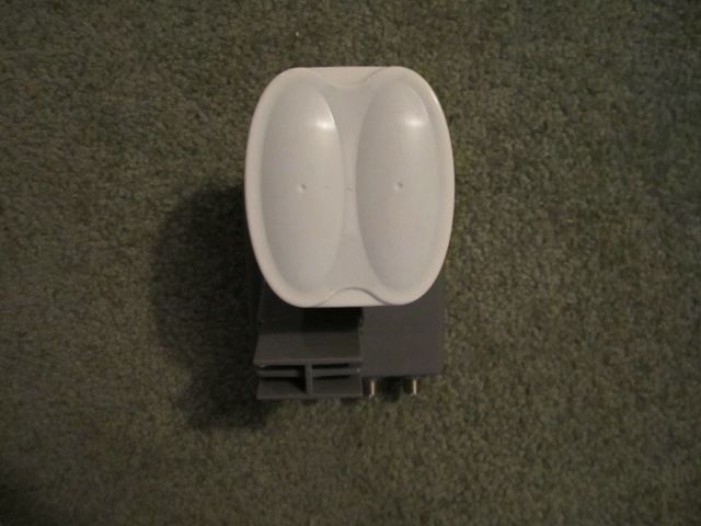

I, i'm new to the site and also new to FTA, i have an old 36" PrimeStar dish that i would like to use for fta and was wondering if this receiver will work with this dish.
X2 M1-HD FTA DVB-S2 PVR Mini HD Satellite Receiver
Will the original LNB be ok or would i have to get a new one, i have done some reading and understand that i would need a diseqc switch in order to use both horizontal and vertical.

What is the make/model # of the LNB?
If 2 outputs, one labeled V and the other H, use a multiswitch to get both polarities. If single output it may be single polarity.

That model has separate Horizontal and Vertical polarity outputs.
As Fat Air pointed out, combine the two ports with a 13/18v multi-switch. The LNB "H" port connects to the switch 18v port and the LNB "V" port connects to switch 13v port. Connect the switch output port to the receiver LNB IN port.

Don't use a standard LNBF with the dish. Performance suffers greatly as the scalar shape doesn't match the dish. It will only use/see the center of the dish. The front of the factory one is that particular shape to see the whole dish. Been there / done that.
That explains it then. I had always wondered why a modern LNBF with presumably better specs would not perform any better, and sometimes even worse than the old original one from the factory. Maybe it has to do with the shape of the end of the LNB, if you look at that one on eBay with the exorbitant shipping charge it has that same end shape that sort of follows the curve of the oval dish. So maybe that is part of the reason.
I think the key is oval feedhorn. The NJR/Eagle Aspen lnb's look like they bolt to a horizontally oval feedhorn. Up here in Canada, Shaw Direct uses vertically oval feedhorns. xku 002.JPG
Yup. My 84e worked about as well as a 60cm dish when it's had a typical Ku LNBF on it. When I put the factory feed and LNB on it then easily outperformed my 70cm Channel Masters. (Not quite the performance of my 1.0 meter) My thinking is, about like an 80cm. May be the reasoning for naming it and 84e(?)
