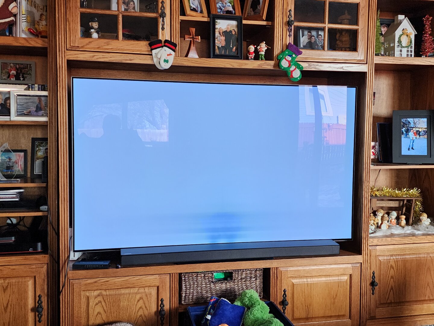

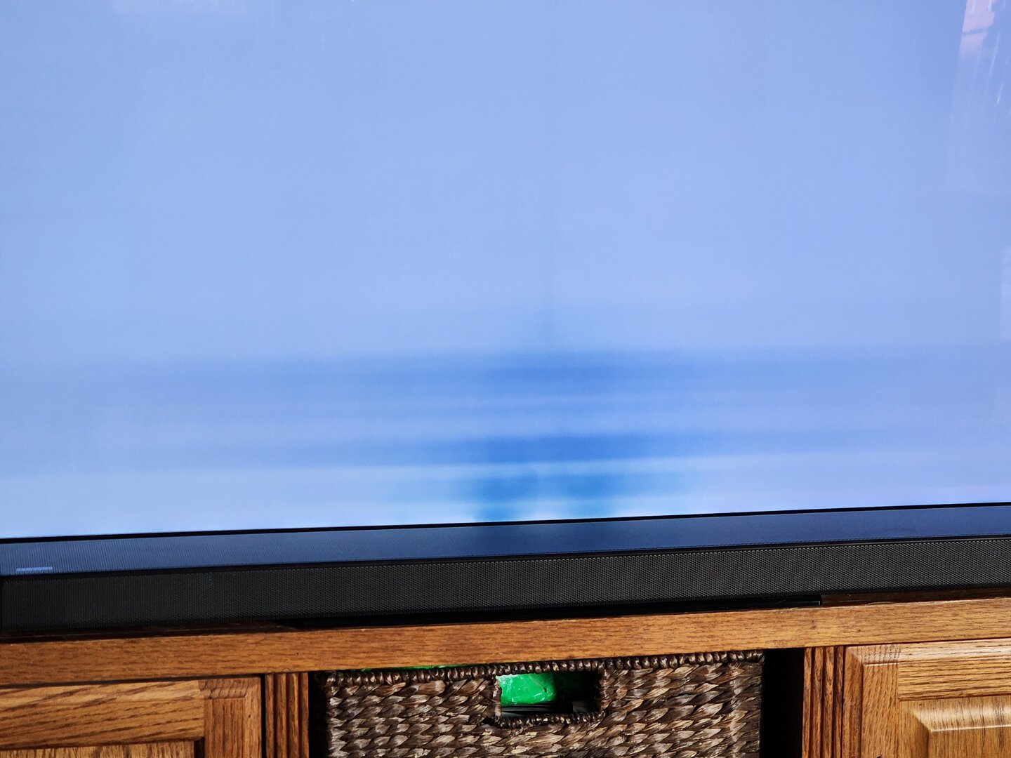

I bought LG OLD65B7P from Costco on Feb. 2018. In 2020 we started to see burn in we could see logos, they mute symbol and some unexplaned box in the middle of the screen. I contacted LG and they said they would replace the panel. It took a couple of months during covid but they replaced it and also the driver boards. Now again in 2022 we are starting to see burn in again. The picture quality is great on OLED until its not. I have the pixel shift turned on and ran the pixel refresh every two weeks after the panel was replaced but that did not stop it from burning in again. On mine it looks like the heat of the boards behind the panel eventually cause the pixels to degrade.
Probably going with Neo QLED for the next TV.

I'm sure glad Best Buy let me keep my OLED when I had the burn in issue. It still works great with the burn-in issue.
