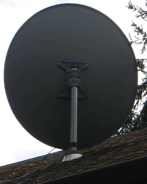

A friend of mine is considering a similar problem with a 3.5" od pipe through the roof as the most likely solution. In his case we are planning to build a very stiff pony wall between the ceiling joists and the roof rafters, and then anchoring the pipe with truck suspension u-bolts to the pony wall. By tying the wall across several joists and rafters, we believe this will provide a rigid mount. I used similar u-bolts to attach the same size pipe to the top of a reinforced outside wall to roof mount my 2.3m and it works fine.
A neighbour of mine has an 8' mesh dish on the peak of his roof. Though it's not used any more it's made it through some pretty bad wind storms in the eight years I've lived here and hasn't caused any problems that I can tell.
To be clear, the picture I linked to above was a mount done by GrumpyGuy. The one that I did was on a church with a 1.2 meter dish and a 2" pipe. It is a VERY sturdy mount. The pipe is secured at both the top and bottom of the truss near the peak of the roof. This allowed for about a 4 to 5 foot spread between the top and bottom u-straps. The dish has never moved in over 3 years.:)

Jim, wescopc can tell you exactly how he did it but I'm guessing the bottom of the pipe is attached (with u-strap) to a ceiling joist, and the top is fastened to the roof rafter that is directly above it.
You could shim the top (or bottom) of the pipe if you needed it, to get it plumb.
There are several styles of open or closed conduit hangers (or even perforated plumbers "tape") that would work well to hold the pipe.
You might want to put an angle or some sort of "shelf" on the bottom of the pipe to keep it from dropping, or drill a hole or 3 in the pipe and run some long screws through it into your wood members after you have it plumbed up.
Lots of options and possibilities for this project. :)
In the attic, I found a spot that had a corner 2X? that was used for nailing the sheet rock. I rested the bottom of the pipe on that right next to the bottom cord of the roof truss. To find the proper location in the roof sheeting I used a plumb bob to center on the spot I wanted the base to rest. I then drilled a 1/4" hole straight up through the roof and shingles. Then from the top side I used a 2 3/8" hole saw, going straight down using the 1/4" hole for my pilot drill. I then worked the flashing under the shingles. Took two of us to drop the heavy pipe carefully through the rubber on the flashing until it rested on the 2X? below. Went in the attic and plumbed and strapped the pipe in place. Drilled a hole through the pipe and the cord of the truss and inserted a 3/8" bolt with washers and tightened to prevent rotation of the pipe.
I used a 12 oz pop can with the top cut off to cover the top of the pipe, prior to attaching the dish, to keep the rain out of the pipe/attic. The dish U-bolts clamped around the pop can and mast.

That flashing looks like a standard roof jack for plumbing, available at any home improvement store/lumberyard.

Bought the roof jack/flashing at home depot. Standard for plumbing vents. I do not have access to the attic of the church - without getting a custodian to open it for me, I don't think it would be appropriate to ask.
