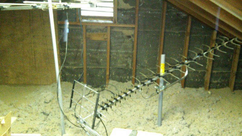

so I ended up installing the extreme signal yagi antenna in my attic, see photo - results quite good! I bought a kitz preamp (mast based) , with a passive monster cable spliter. I chose my attic, realizing I was sacrificing 10-30% signal because I promised my wife no more antennas on the roof (used to have a high mast and larger antenna) but I did add an 8' cband dish in my background, lol.
This antenna is a good one! long about 82 inches long and slightly tricky to assemble but mfr. has an on-line video. oh the other antenna is an FM only antenna...anyone think their could be interference with the 2 so close together? thanks.
I'm interested in what you got with an attic install against *that* tvfool report - i honestly would have given up.
with the extreme signal yagi antenna and the kitx pre-amp. on my attic mast - I have been able to lock in 100% even in poor weather, CH.30 wvit and the 2 sub chs. , well the first few days ch. 20 reception was descent in good weather, low winds and borderline when atmospheric conditions were less optimal. What I was surprised in was that fox61 from Htfd. and antenna tv was intermittent to watchable depending on weather. I still need to play a round with aiming of that antenna a bit, maybe to give up on ch61 and move the antenna east southeast a bit to stabilize ch. 20 a bit while holding on to wvit but bring down the signal numbers a few notches.
mind you I am literally 1 mile east of danbury and like 8 miles from the Ny border near Carmel, NY.
My intention is to add a second bowtie antenna and aim it at wzme ch.43 which isn't far from me but is another lower power station.
If I recall correctly my tv fool report called for me to have a harder time locking in wvit.
I still can't pick up wtnh on high VHF, which is not a bid deal for me.
