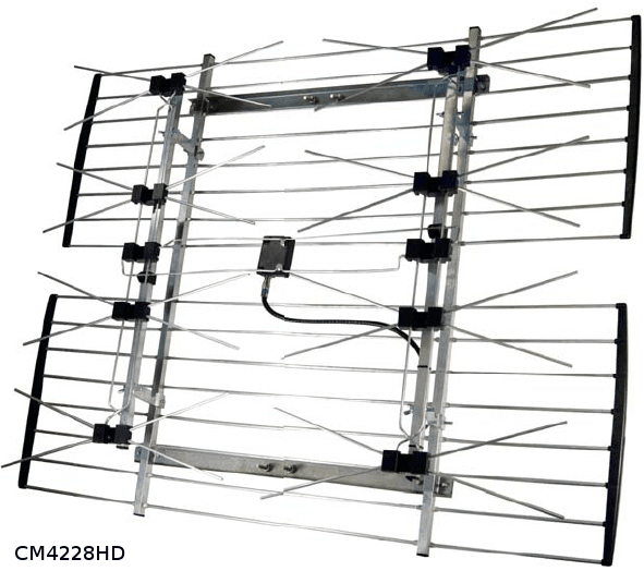

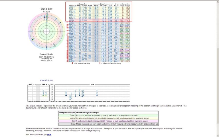

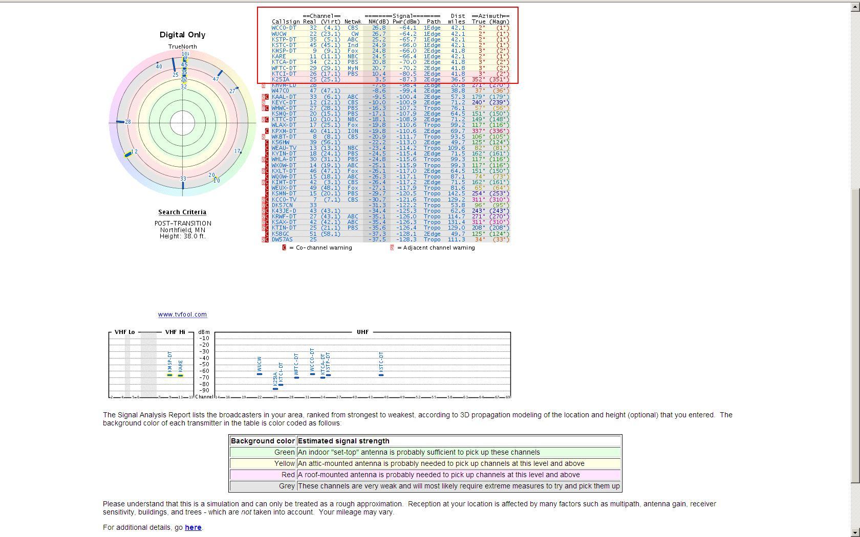

A CM4228 (soon to be renamed to the CM4228HD) installed just above the roof line and aimed at maybe 356° or there about; should work just fine in Northfield, MN. If you post your actual zip at TVFool you may get a bit better info; see attached. Stay away from gimmicky or specialty antennas; as they are more about looks and price vs function. And shop around; some places seem to jack up the prices for some of the most popular models. The CM4228 and the like should be just around $55 - $70; not the $85+ you see on some of these other sites.
