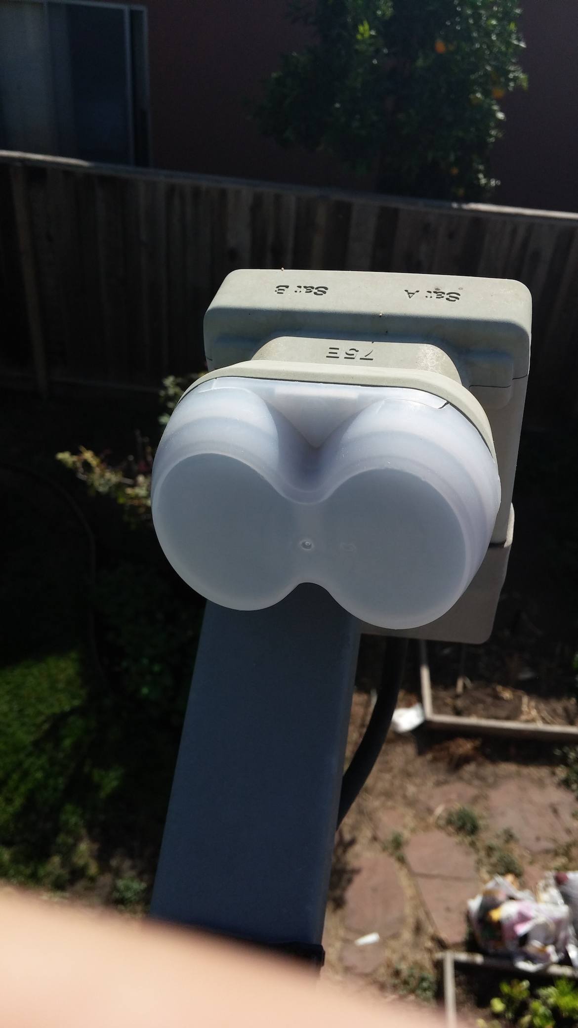

Do you know if I can buy a new LNB that will work with Shaw in the Bay Area? Here is a photo of it:
FYI, I have an older 26"x36" parabolic dish.
Thanks again,
Marc
From the labelling on top of the LNB in your photo it says you have the 75e dish, which agrees with your dish dimensions.
The part number on the label of the LNB will likely say STAR75-ASC-001. That LNB and dish size is becoming harder to find used with the recent addition of the G1 satellite, but they are out there. You need a Quad LNB for a 75e dish - a Quad for a 60e will not work correctly, and an xKu LNB opens up another can of worms.
My first thought for tracking one down would be to keep your eye on ebay and search the site here for brokers and installers in the area.

Update: Looks like the problem is a bad/deteriorated port on the LNB. I had a free output port on the LNB and switched one of the coax cables to it and this seems to have resolved the issue.
Thanks again Frenchophile, Jables, and tageekyyc for providing input/clues that helped me solve this annoying problem!
