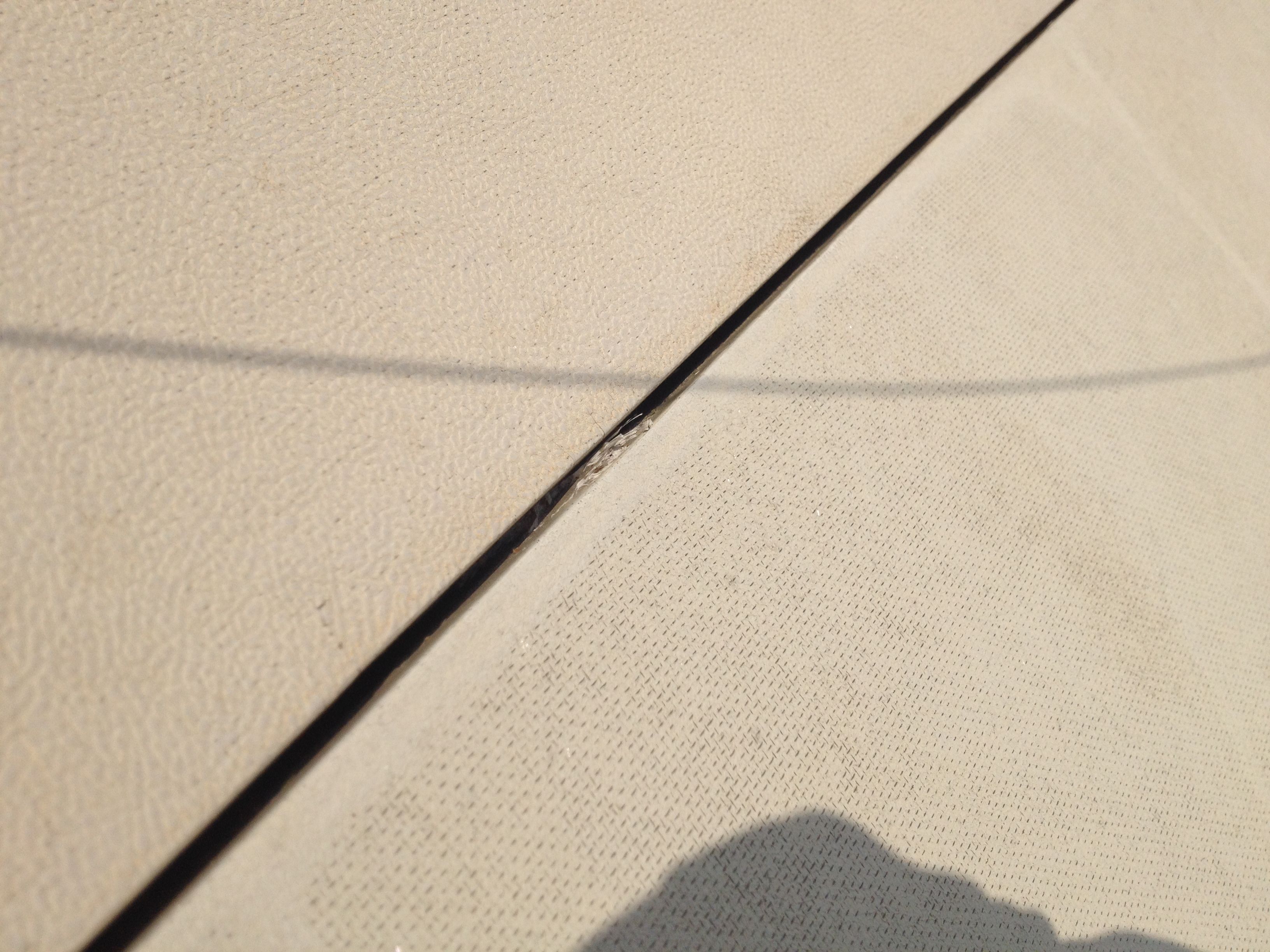

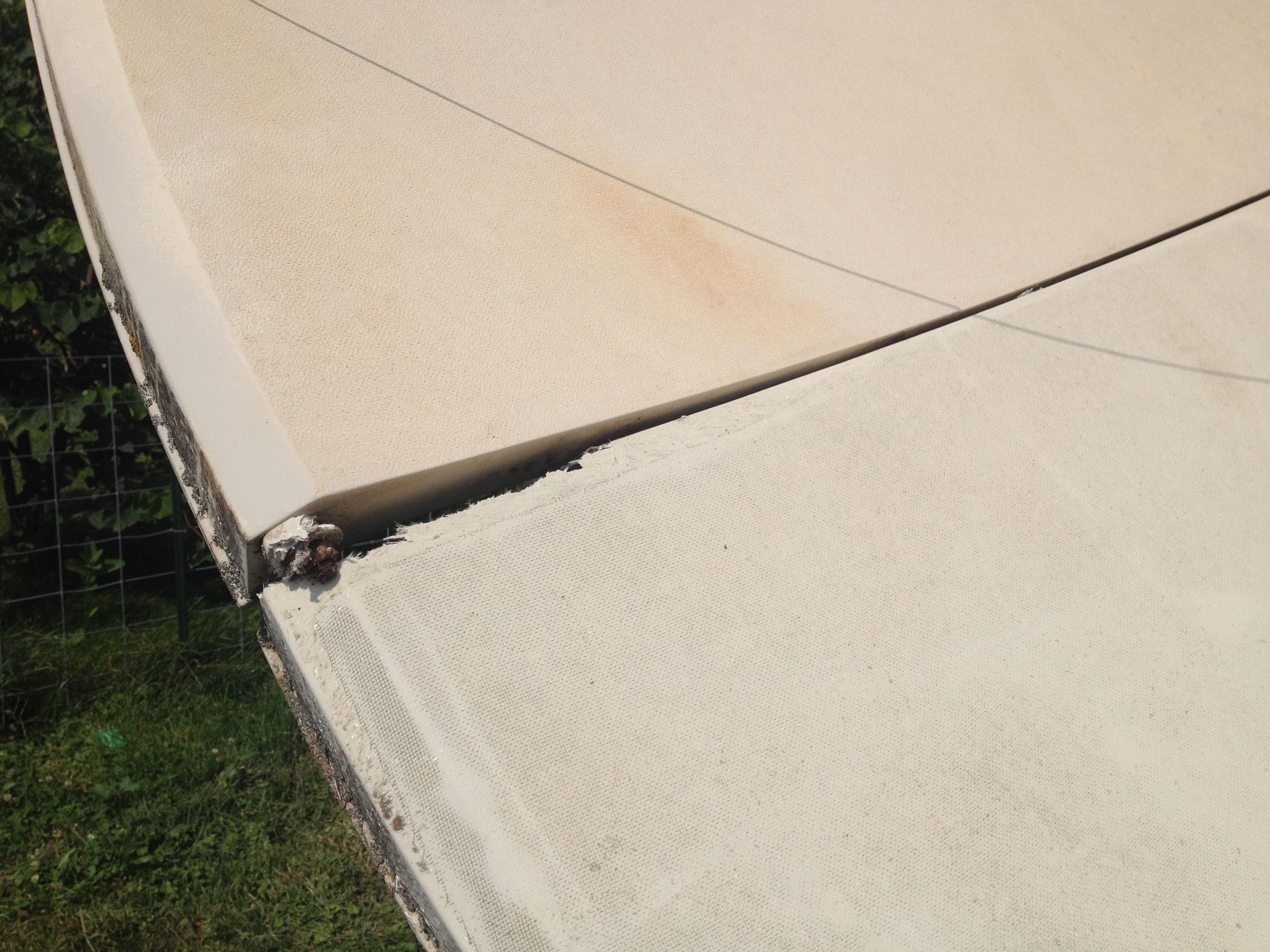

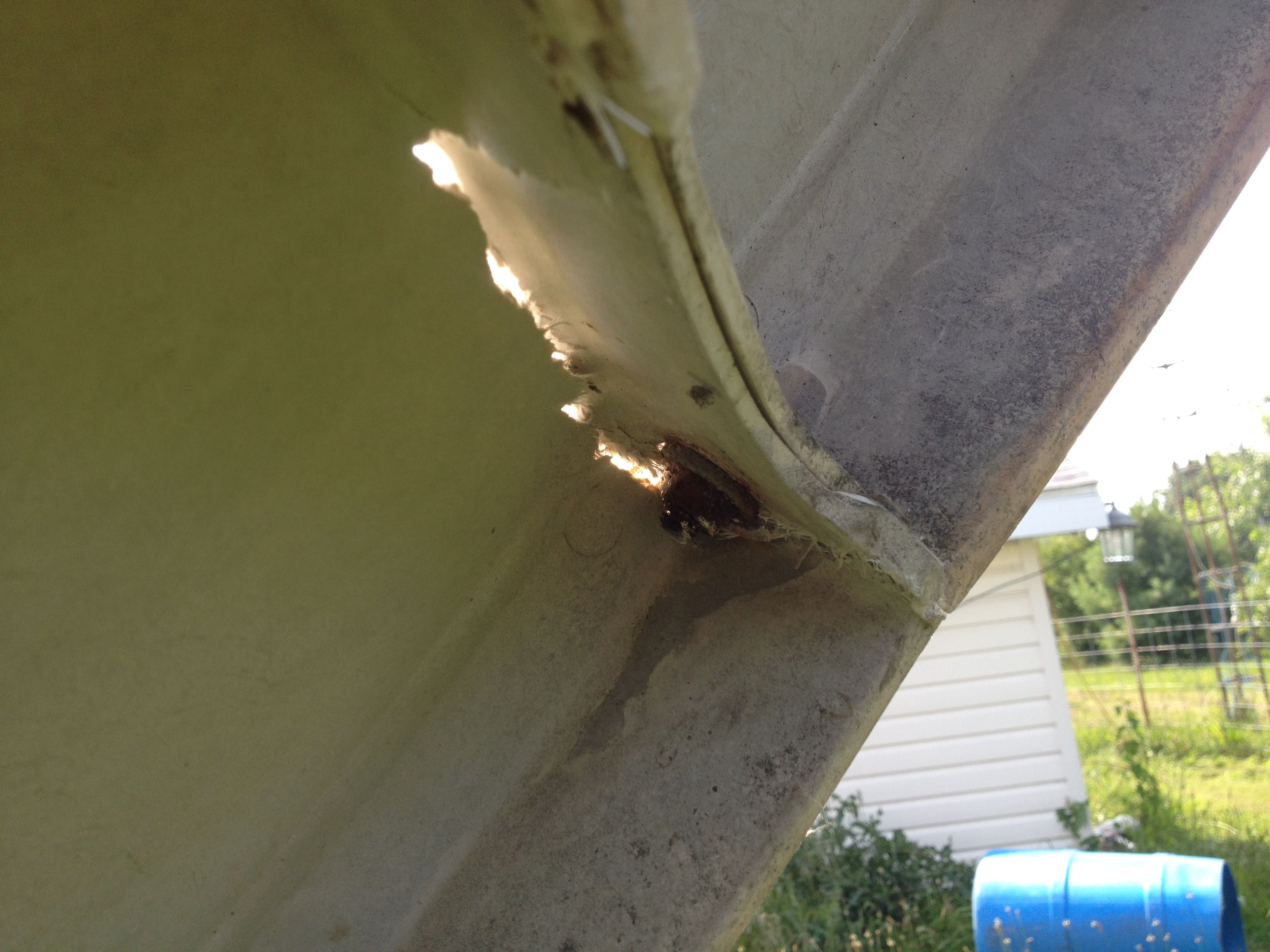

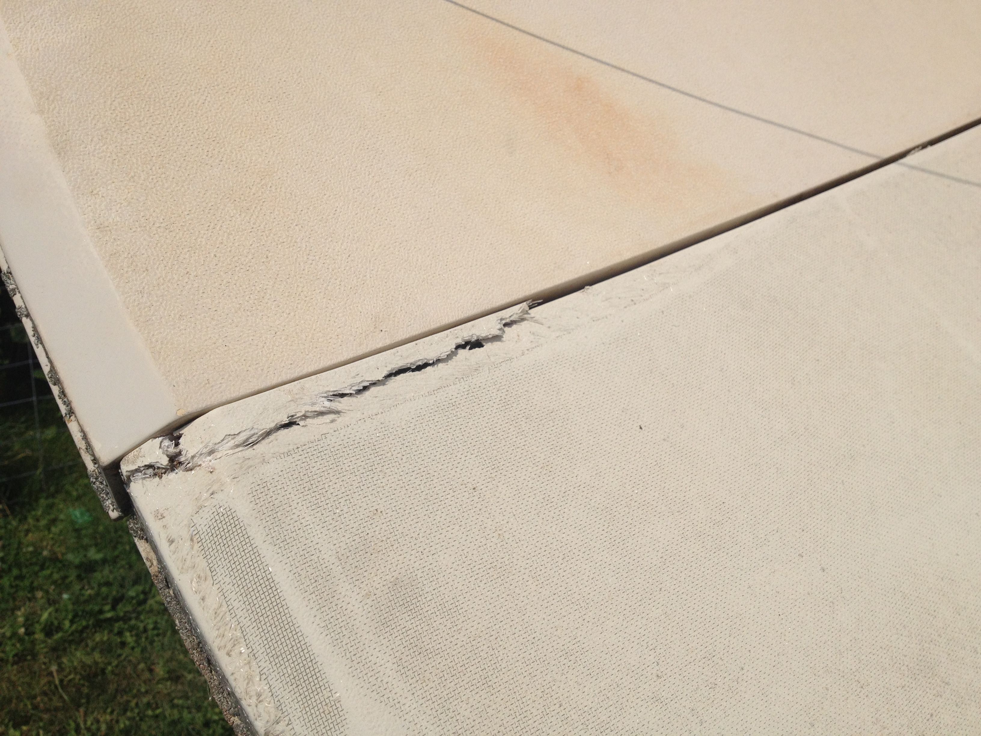

Today I noticed the fiberglass panels coming apart at the bolts. I found the piece that came off and did the best I could to put it back in place. I'll pick up some new bolts tomorrow and drill new holes. Any way I could make this repair better and prevent this from happening again later on? The last picture shows the next one that's wanting to break. We always have strong winds so I'm guessing that is a big part of the problem.
Sorry to see your dish damaged. it looks from the last pic like you may have a significant gap between the panels which suggests to me the bolts aren't tight .......that might cause the problem you're experiencing. Also it might not hurt to put extra bolts in where the panels come together. I rescued a old Channel Master 10 foot fiberglass dish that when I put it back up it had some cracks and tears like you have. I repaired them with fiberglass matt and resin. Mind you I had plans to repaint the dish so the less than stellar looking repair doesn't look so bad. Some food for thought.
often i thought of what i would do if i recovered a big old fiberglass dish like this . I had it planned to place metal strips on both sides of the backside fins that bolted together. aiding in supporting the dish sections . I still think its possible with this one, then just fiberglass repair the damage after its reinforced .
To do a proper repair, on that's going to last a long time, would require taking it apart. Grinding out all damage and replacing with cloth and resin. Not a quick and easy proposition. Appears that the mesh is showing - it's getting tired.
I 'd say it's time to retire it. Especially that you have 'backups'. I'd go with the Pinnacle.
