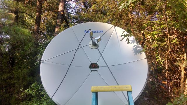

Now the reason for the portable mount. After I locked 116.8 I noticed I could go no further west as i would have been pointing into trees. No problem, cut some more brush and move the whole unit east.
You can see cut branches in the picture above.

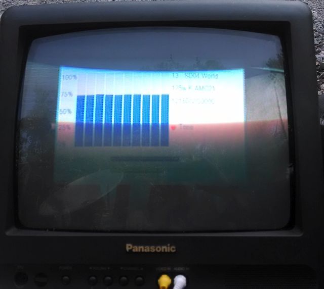

After I tweaked azimuth and elevation, I adjusted the skew dial and POW, steady, rock solid 72%!
I'm not sure how bad this old Ku LNB will drift, I have an SL1P on order from Wallyhts now that I know I have a workable location.
(KE4EST, how does the signal look? Comparable to your 1.2m?) This is the highest my MicroHD reads.
Some people get in the 80% range. Even on my 10 footer with a strong transponder, Low 70s.
Now you will see another reason that I need to be sure of location before I dig and make a dish permanent, and take the portable route first.

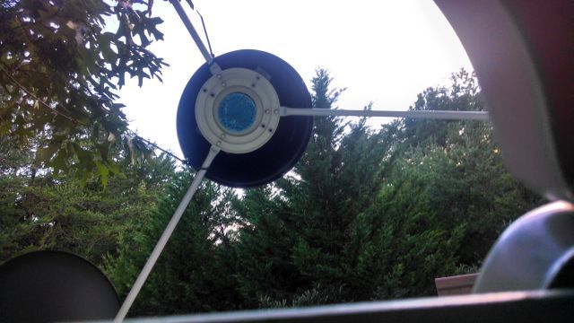

See the little bit of clearing I had to work with? The feedhorn cover is a little crooked but can you see the threading of the needle? You can also see why actuators do me no good.
An actuator for a 3 maybe 4 degree sweep of the arc? NOT. Multiple dishes/lnbfs do the trick for me.

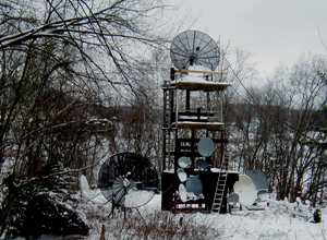

Yup, sure is threading a needle there - Have ya seen Mike's solution, a platform mounted BUD? global-cm.net right side of page

It is hard to tell from that picture of that TV, but if you are at 72 that is pretty good. I think I am right around 80% on the 1.2, but that should do you real good! :)
