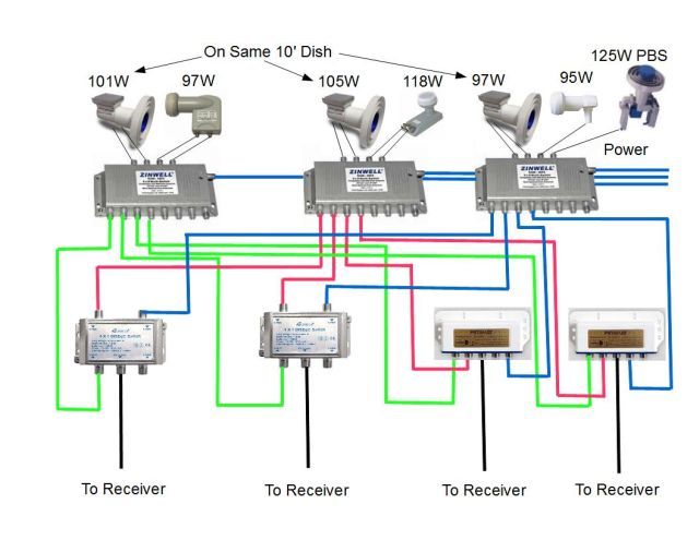

Time to update my wiring diagram.
I will wire the rightmost mutiswitch this weekend as shown:
97W C band, currently wired into the diseqcs, will join 95W and the 125W PBS Corotor on the third powered multiswitch.
So I will be up to 7 sats wired to the house system.
I still have an 8 foot KTI, probably going on 99W C band, another pay dish on 30W Ku, and one more converted pay dish location TBD. All diseqcs will probably be changed out with Amiko 8x1s at some point. All dishes are stationary.

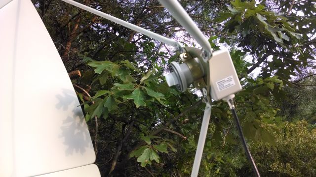

SL1P is now in place:
In these pics you can tell a little bit more how close I am "threading the needle" to get this bird.
The dish is in the trees and you can see the oak that is actually touching the dish a little.
Need to do a little more trimming.
Wired 97W C on a C2WPLL Titanium unit to my third Zinwell SAM-4803, H and V 22Khz off ports.
Wired 95W Ku CCTV mux to the H 22Khz on port. Wired 125W Ku to the V 22Khz on port.
Powered the multiswitch bank back up, went back in the house and everything tuned in fine!
Remember I got 77% Q out at the dish on PBS? Well with my extremely long cable runs,
the run out to the PBS dish is my longest run of all so far, I was extremely impressed
with the powered Zinwells in the fact I was also getting 77% Q inside the house!
I am impressed with the products used in this post and I feel I can recommend them highly so far.
If you have some long cable runs and want to run multiple receivers, or want to try prime focus Ku, Check out these products that member wallyhts offers:
SL1P Prime Focus Ku LNBF:
http://gotcband.com/collections/ku-lnbf/products/sl1p-geosatpro-single-standard-ku-prime-focus
Zinwell SAM-4803 Powered Multiswitch:
http://gotcband.com/collections/muli-switch/products/zinwell-sam-4803
I really like the Zinwells. They are big and heavy and built like a tank. The Zinwells
allow me to have very long cable runs, and allow me to share all my dishes to all my receivers
in the house. You can have up to 8 receivers with these. And as you can see above, you don't even have to exclusively use dual output LNBFs. If you have one LNBF of H only channels and another with V only channels, you can wire them like I did and share single output LNBFs on all receivers.
I am sharing out 7 sats throughout the house, without motors so I have instant tuning.
Now I have a total of 60 channels on all receivers!
