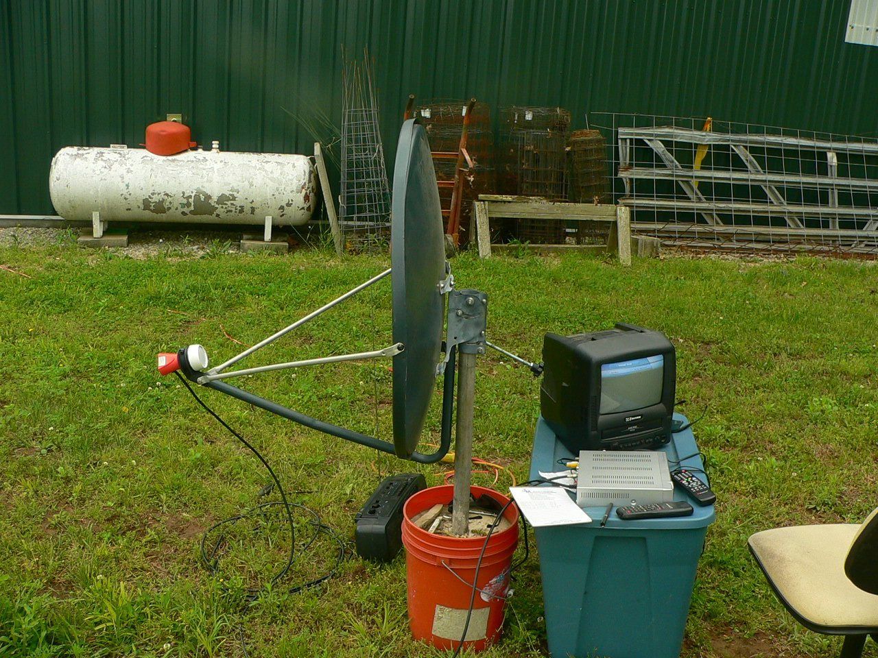

Nothing real exciting here, just wanted to show you all my first attempt at receiving Hispasat @ 30W from my location in Southwest Missouri (aka Hillbillistan).

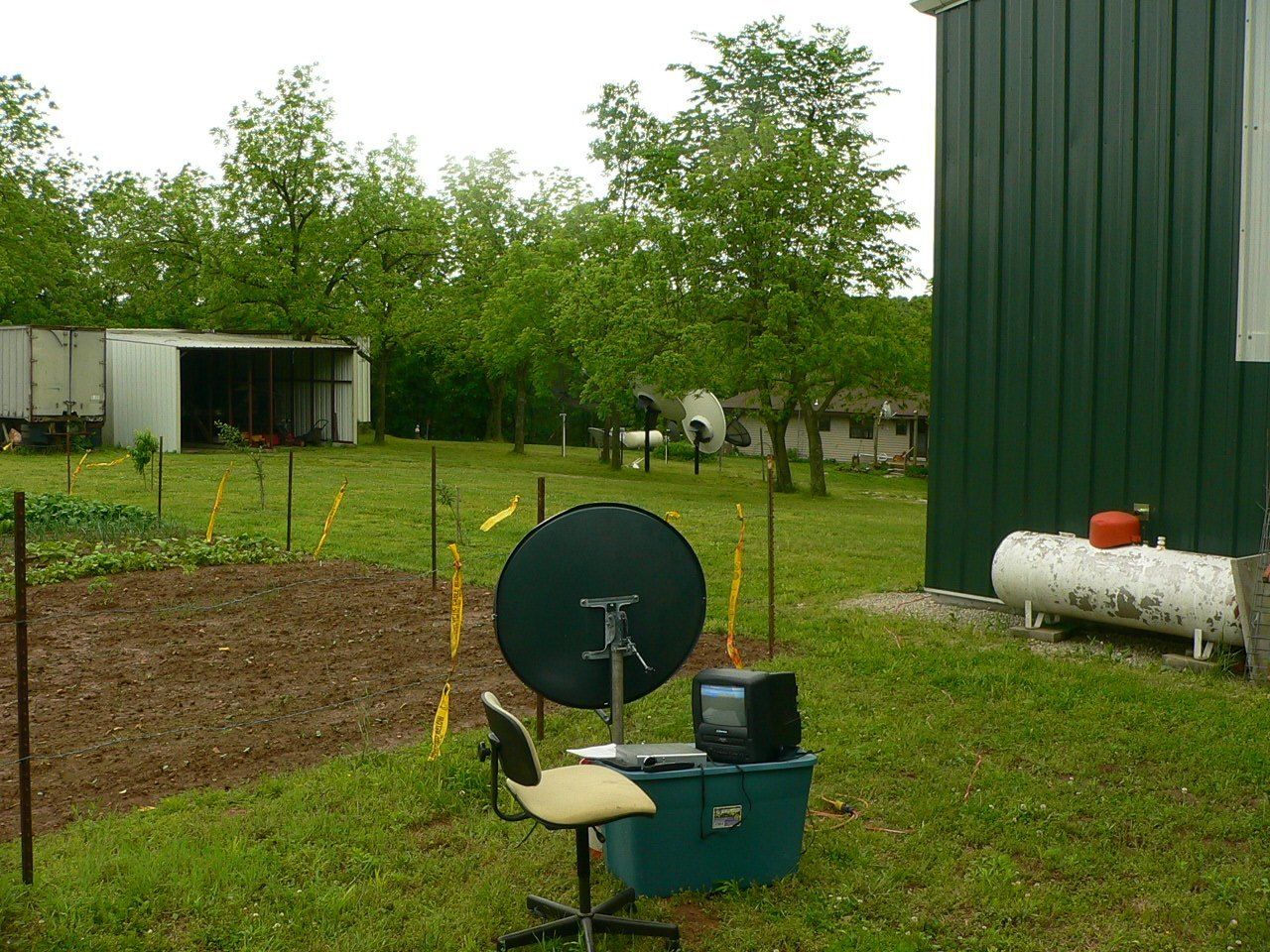

Dishpointer gave me an elevation of 12.2 degrees, the lowest elevation I have attempted from here.
I decided to set my trusty 5 gallon bucket of concrete w/1 5/8" steel pipe out beside our garden in hopes of getting good LOS, not sure how high over the trees and building I was looking but it was good enough.
Didn't attempt to plumb the bucket/pipe, just threw it down on a "level" spot, and adjusted the dish elevation adjuster as low as it would go, it was showing about 10 degrees on the scale.
After hooking up the receiver and skewing the LNBF (approximately 50 degrees), with a little azimuth sweep I had acquired signal in less than a minute, I think the "better to be lucky than good" rule applied that day. ;)
Picked up 5 transponders on a blind scan:
11883 V 27500 66%
11970 H 27500 63%
12052 V 27499 66%
12131 H 27500 66-67%
12172 H 27500 66%
I tried for a few minutes to bring these Q levels up by all the usual methods but that was all I could get.

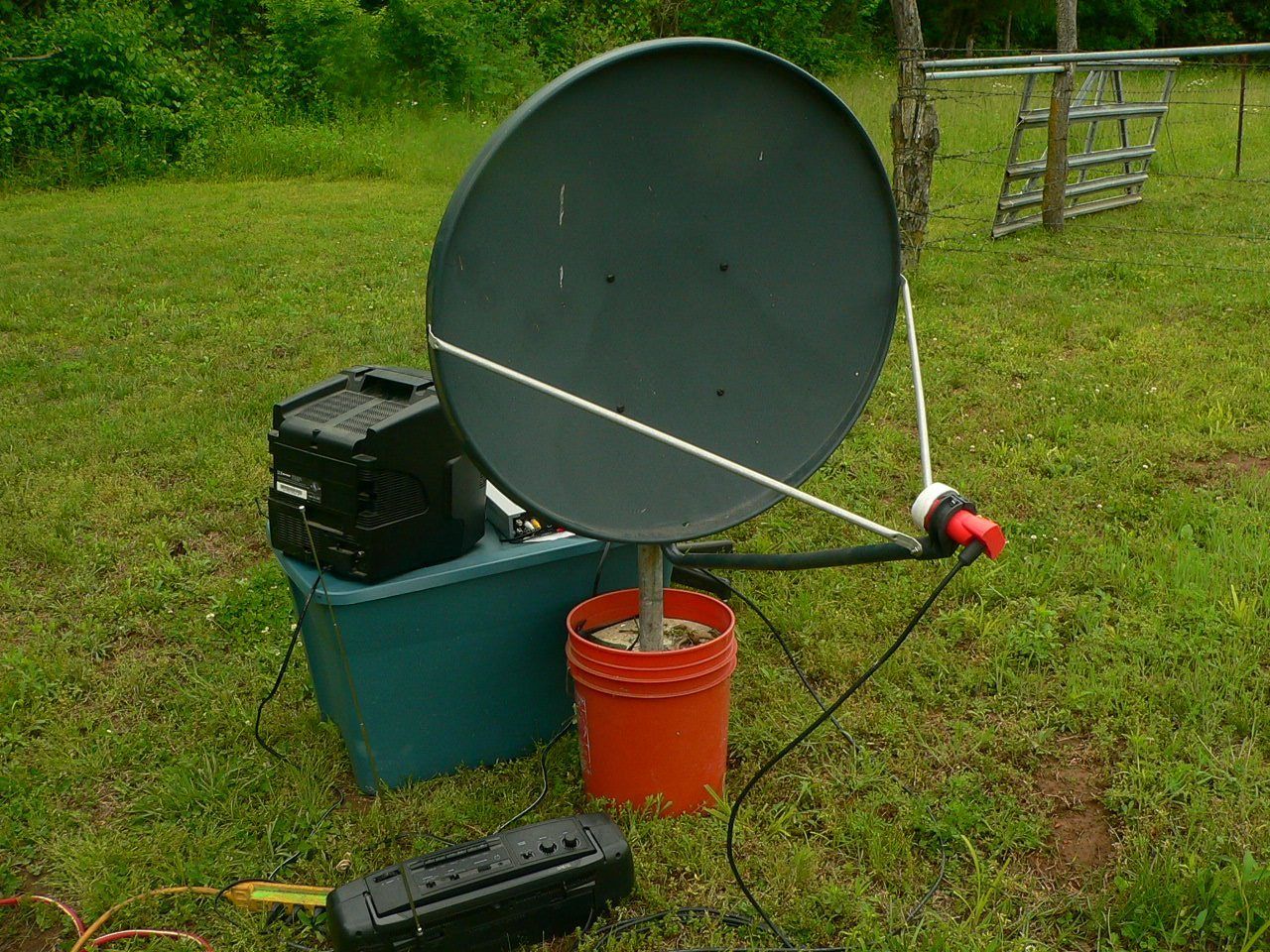

My equipment:
90 cm BJU offset dish
Coolsat 6000
Techsat Tracker II LNBF

kudos:
Love the red bucket, red LNB, and the long elevation screw adjuster. - :up
AND, it's low enough you can work on it while sitting down.
Now, THAT's what I call "arm chair FTAing" ! - :cool:
Thanks Anole, all I was missing was the big dumb red dog that usually "assists" me. Pretty sure he was laying on the back porch protecting us from the flocks of hummingbirds that attack our feeders there. ;)
My wife was actually going to pitch that fine FTA chair, but I rescued it! :eek:

Proud of you son! My house is literally one lot away from an easy clear shot at 30W. Wonder if I should ask my neighbor if I can mount a dish on top of his roof?
Great job Phlat! My elevation here is 23.3 so I'm gonna try this again over the weekend. (I think I found a spot that I can aim just over the trees! ) :D:up
