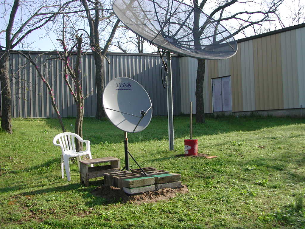

Finally had some decent weather and some time yesterday to make my first attempt at setting up a Ku dish. I had poured a 5 gallon bucket full of concrete to use for a temp mount but I was given a non-pen roof mount later that day, so I used it to mount my new 3ABN 90cm dish w/3ABN linear LNBF, a Coolsat 6000 and a little 13" tv made up the rest of my system.
With compass, inclinometer and paper with elevations/angles/skews in hand I started aiming, looking for 123W G23 to reveal the exploits of McGarrett & Danno on one of the Equity channels. After about an hour with no success I decided to take the LNB skew variable out of the equation and take a shot at my true south sat, 93W G26. Changed my elevation and azimuth, rotated the LNB to about 1 degree cw from 0, set the manual scan to 11865 V 3516.....moved the dish about 1/2 degree east and bammo, saw that beeyoooteefull green on the Coolsat's signal meters. :D
A couple minutes later I saw my first homebrewed Ku transmission...CBS Newspath. :cool: Also saw the Macy's channels and Ms. Rev. Melissa Scott on the Univ. Network, and was still sitting in the yard watching with a goofy grin on my face at dusk, when my wife and daughter got home. Said daughter said to said wife....I'm sure glad we live out in the sticks so no one can see dad sitting out in the yard watching TV".
Just wanted to share my experience, thanks to all who have assisted directly and indirectly, great bunch of folks around here and I couldn't have done it without your help. :)
Jody

Now that you got 93W check the elevation on that dish and match it up with what it should be (what the satellite finder shows). If 93W is your true south, you should be able to move across the arc from 89 even 87 over to 101 without having to move the elevation on the dish.
Once you get the hang of it, then try 123W. Move the elevation to what it should be and skew the LNB (roughball it)...The dish looks almost straight SW here in MN (my True south is also 93W) for G10.
Our golden retreiver thought I was nuts, I whooped it up when that first picture came up. :D
If the weather holds I'll try hitting some more sats tomorrow, today was lawn mowing and I reset my Visionsat to default and rescanned all my satellites after it's latest hiccup. The elevation scale on the dish seems very close to being correct and the offset of the dish seems to be about 26 degrees if my measurements are accurate.
Aiming for some sats pretty close to true south (and not having to worry about elevation) will help me to judge how to guage the LNB skew scale, it only goes +/- 20 degrees and I need about 33 degrees skew to hit G10. I'll let you know how my next assignment turns out.......:cool:
If you are going to try G10, turn the LNB to 20 (if in front of the dish facing it, turn it counterclockwise). That will roughball it so when you get on G10 you can always tweak it to best signal
For skew if its off by 10 you will get a weak signal, but will be able to find it. If your skew is 33 and you leave it at zero, you won't get anything
