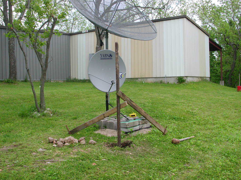

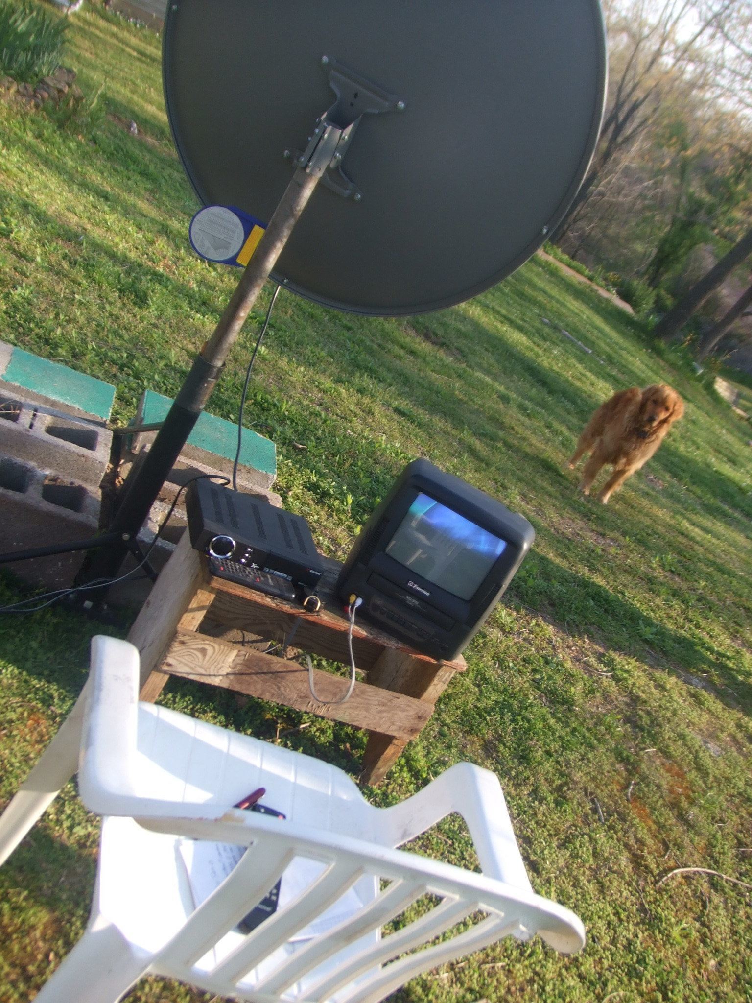

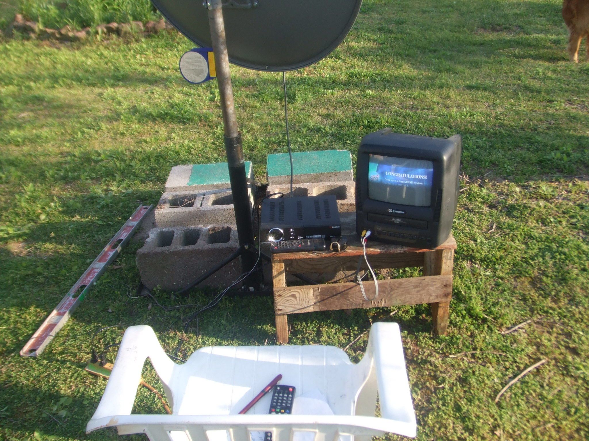

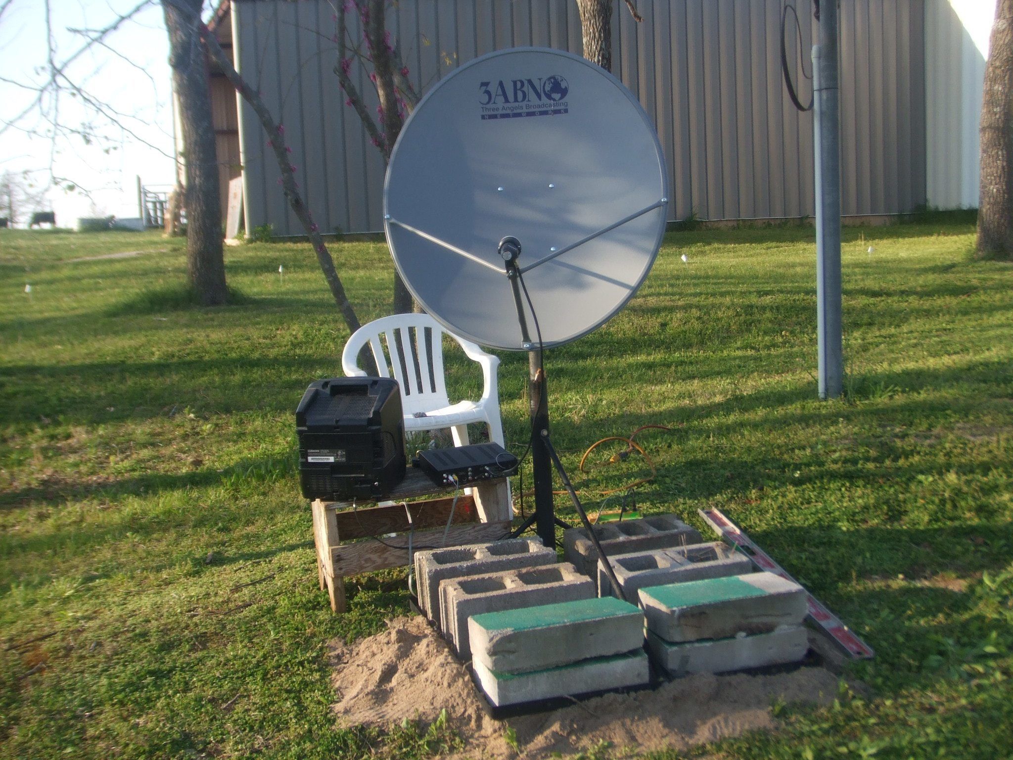

Not yet, this evening is the first chance with decent weather I've had to try again. In the last hour I've gotten good signal and pictures at 87, 93, 97, 101 & 105 (without changing dish elevation). Heading out now drop the dish about 10 degrees and take a shot at G10. :)
I was on it in less than a minute. :)
Here's some numbers for G10:
11718 V 27692 87-88%
11799 V 26656 94%
I'm thinking about splitting the spare coax out of my BUD ribbon cable and hooking it to this dish temporarily, then we could even watch it in the house! :D

looks good. I would check a couple more from thelist to make sure but you are on G10 :) CONGRATS!
I would :)
Yes, indeed! The tip you gave me about the tolerance on the LNB skew helped a lot, I was able to play with it this time and saw that it wasn't that critical. :up
when working near true south skew is not that critical. ON my C-Band I ghetto move from AMC1 over to G11 and dont even touch the LNB (I have a LNBF so I manually have to move the LNB)

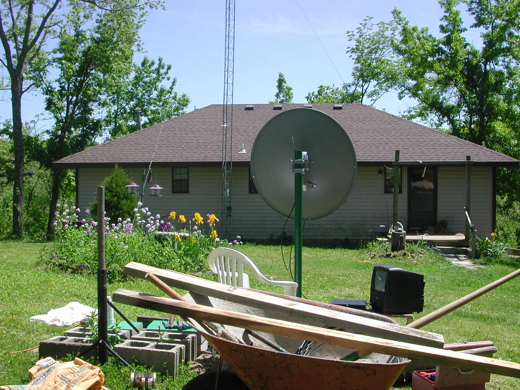

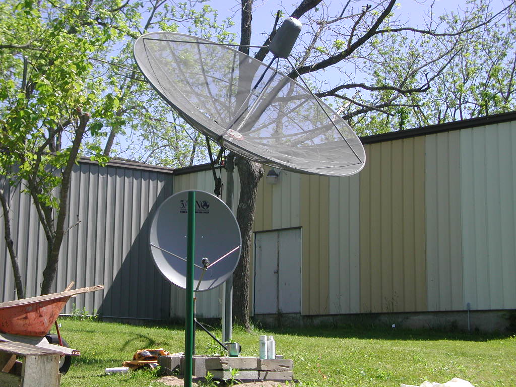

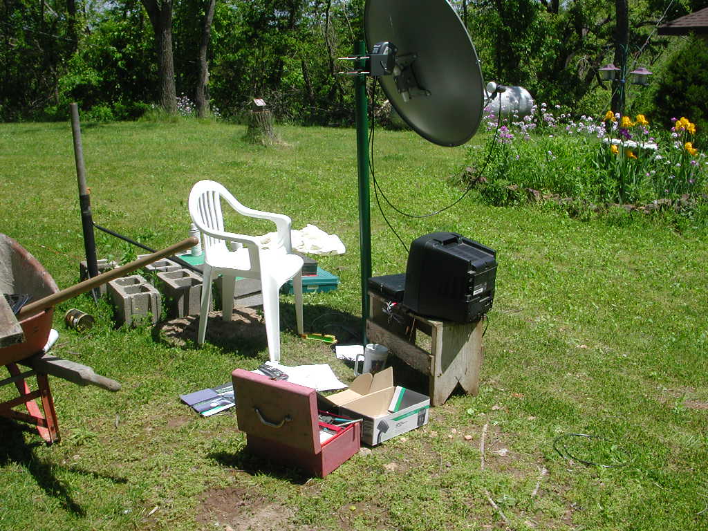

I got my pole set yesterday, cleaned and painted it this morning (Anole should approve of the color :D), and have mounted my motor and dish. I have gotten signal at my true south G26 @ 93W, and have been able to move the dish to others sats using USALS. It seems if I go very far off of true south I can't lock a signal, probably need to do some more tweaking, but I'm getting there. Here's a few pics of where I'm at:

Next step after I get this part lined out is to hook on to the spare RG-6 in my BUD ribbon cable, that should get me run into my house, not really sure how to hook things up between my analog receiver and my Visionsat, but I'll sort that one out (with some super SatGuy assistance) in good time. :)

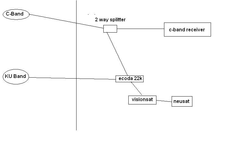

I'm thinking that "Add a reciever" diagram is for an an existing BUD with C and Ku LNBs and may not work for what I want to do. I need to be able to move my Ku dish with my Visionsat, and move my BUD with my Toshiba, but need the C & Ku signal coming into my Visonsat so I can see my C-band digital. Any ideas out there? :confused:

now to handle that tricky setup. You could put the 4x1 diseqc switch in the house where the 2 cables are. Hook C-Band to port 2 and KU to port 1. You're not really suppose to put the diseqc in between the motor and receiver and the switch will burn out quicker
What some have done is to use a Ecoda 22k switch...key thing is it HAS to be ecoda. They are magical :) They pass diseqc codes and motor commands
setup would be like this
C-Band--------------------------------splitter port 1---------------C-Band analog
-----------------------------------------splitter port 2------ecoda 22k on
KU Band---motor-------------------------------------------ecoda 22k off-----visionsat---neusat ;)

Would I use the 2 splitters with this scenario, could you diagram this for me? I have 2 or 3 diseqc switches and 2-3 hi freq splitters, if I could get this going with what I have on hand that would be great.

here ya go :)
the line is the divide between outside & inside. Like I say, temporarily you could use a 4x1 in the place of the ecoda and set up the visionsat menus for KU diseqc 1 and C-Band diseqc 2

here ya go :)
Thankee, thankee, T......I'm going to give it a whirl right now. :cool:
