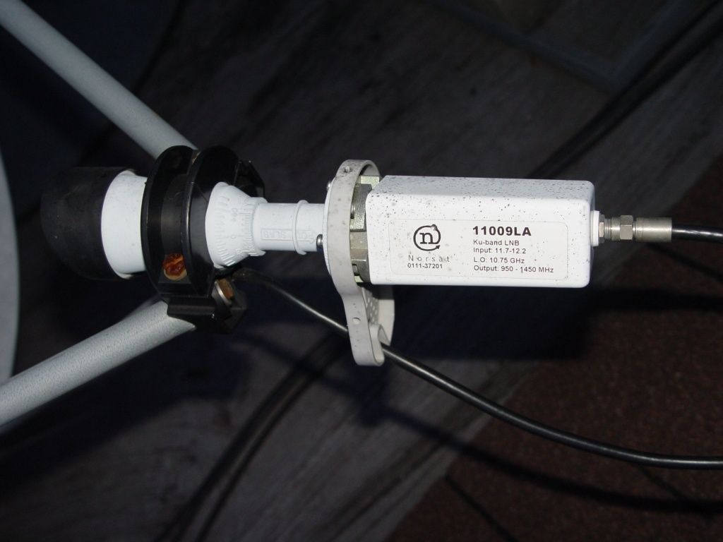

Like Iceberg said, that's a circular DBS LNBF. The dish was probably used by someone with DirecTV to combat rain fade. That LNBF will be useless for 99 percent of the FTA channels, so you will want to replace it with a linear Ku LNB(F), either universal or standard (standard preferred if you will possibly be expanding your setup to include more dishes in the future, since it allows for 22k switching).
You may also consider hunting down the original feedhorn assembly with separate LNB which is made for that dish, seen in the attached picture. Note: Since this picture was taken, I have replaced the single-polarity Norsat with a stacked FSS LNB from a Superdish.
