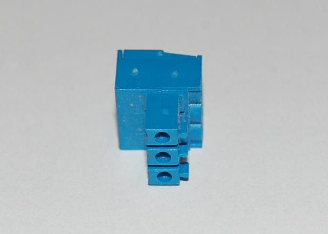

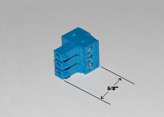

I want to order some of these through the Internet, but when I try to find them as "mini-Euro" connectors, I can't find them. Can someone please tell me the correct name? Thanks!

They plug into the back of a phantom power microphone preamplifier, input, output, and remote jacks. Must be fairly new, because it was part of a quarter million dollar sound system install, done by a nationally known audio company, specializing in state-of-the-art equipment. Job completed a month ago.
Sorry, I can't get a picture of the back of the preamplifier. I will check those online catalogs... thanks!!
Well it's as close as you can get to the Phoenix Contact Combicon, as described by rglore. About a 99% match. I wonder if it's some other manufacturer trying to get close to the Phoenix Contact product?
At any rate, I can now search locally with a correct name to use. Thanks, rglore. And thank you all.
Looks somewhat like a Euroblock, used for balanced pro audio interconnection. I suspect that's what it is, since you mention it was used in audio applications.
