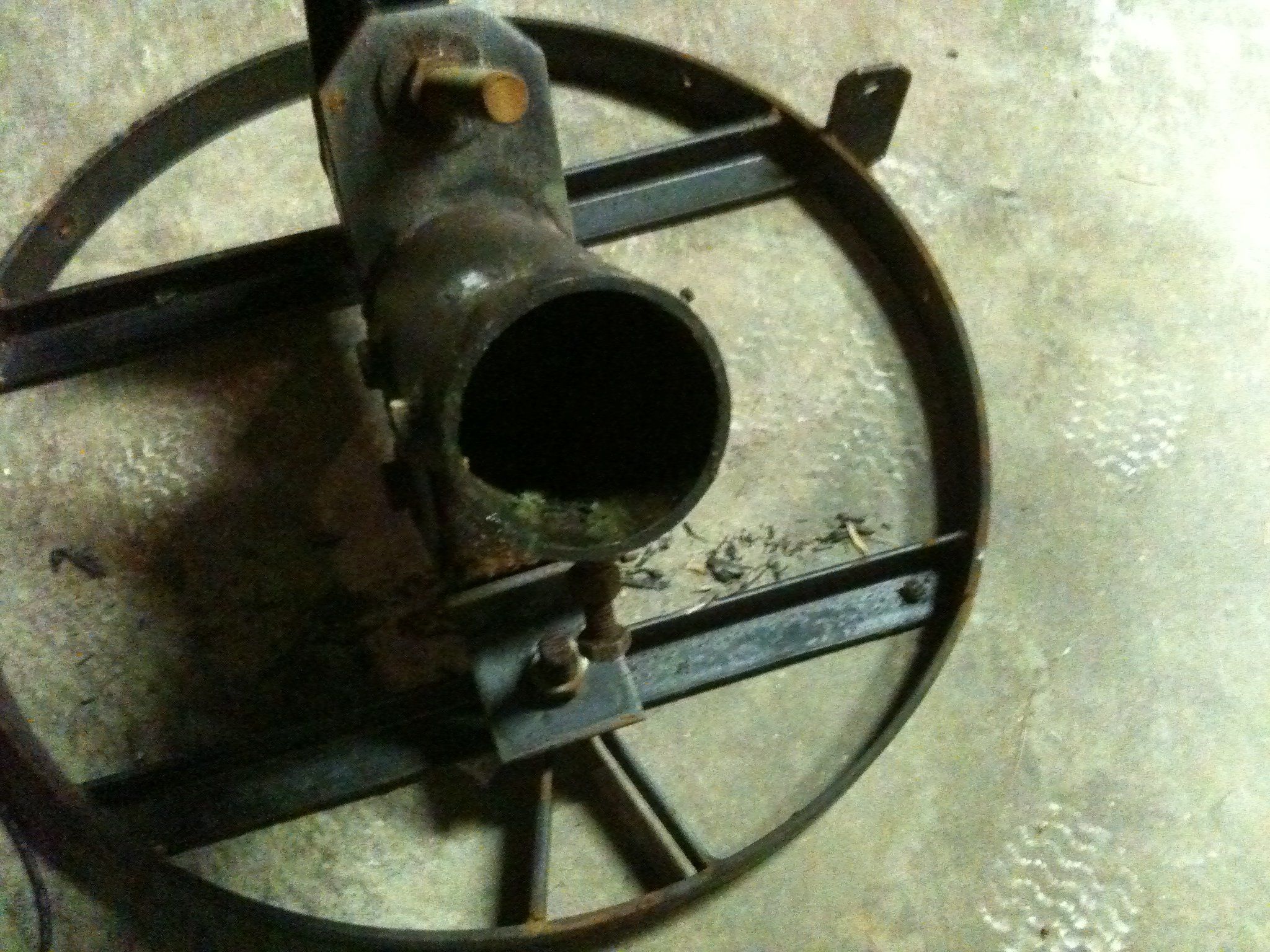

I have 10' Perfect 10 dish that I am about to mount. Is 3" the correct pole diameter or is 3.5"? Can I use 4" and adapt it down to 3 or 3.5? My friend has 4" pipe he can give me for free. Thanks.
Can you post a pic of your mount, where the pole goes into, so we can see the type of mount?
My mount measure 4" outer diameter. Here is the pic.
you'll need to measure the inside diameter of the mount. Make sure the outside diameter of the pole doesn't exceed the inner measurement of the mount.
