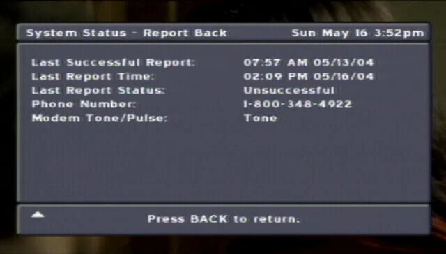

Here's a screen shot showing a successful reportback and this is using vonage.
You mean the one on 05/13? Great! Any idea what kind of baud rate your VoIP supports for modem connections?
