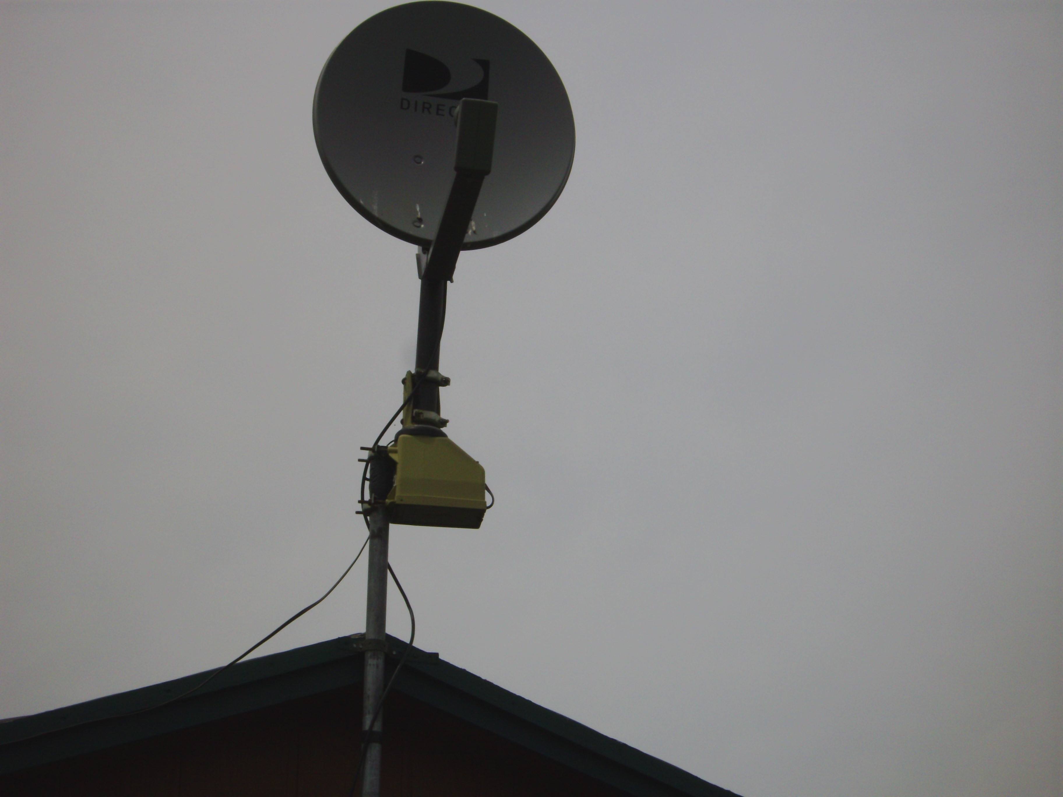

I've seen plenty of 18" dishes on old TV rotors here on Mille Lacs. Then they can move it rather easily
