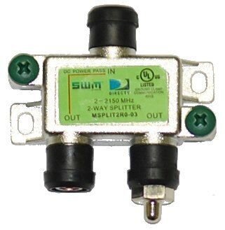

Theres a Red circle around the power locations.
Your talking about the splittrer involved, not the PI itself, right ?
The Power inserter has an In and an Out, thats it.
The way I set them up ( there are various ways to do this) is from the dish to the PI (labeled to LNB) then if you have more than 1 recvr, you'll have a splitter (this is a SWM splitter, not just any splitter) the to recvr side of the PI goes to the Power lug on the splitter, then I connect coax to any other lug on the splitter that goes to the recvr.
A swm splitter is marked to show which ports are power passing.
If the TV's are working.. It is.
The splitters Directtv uses only have one power passing leg, so the one its connected to (on the splitter) is it. It's also marked with a Red dot and a line (on the splitter).
This is why if you move the power inserter into another room, you'll lose Satellite signal on all your TV's, unless you also change the connections at the splitter.
