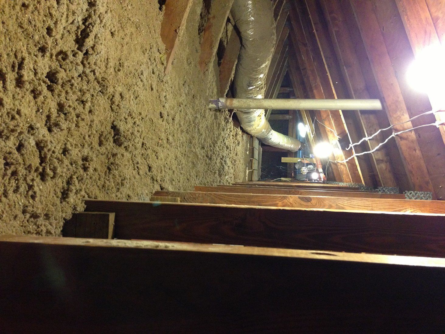

I have prepared the chart below (click on the PDF, ignore the "4 Joey" comment at the top, and please excuse the miserable handwriting), and prepared the attic as well. Coax from the roof mounted dish is at the end of the 26" wide pathway (avg ht 36"). I have run all the coax to wall plates, most of which are in use today.

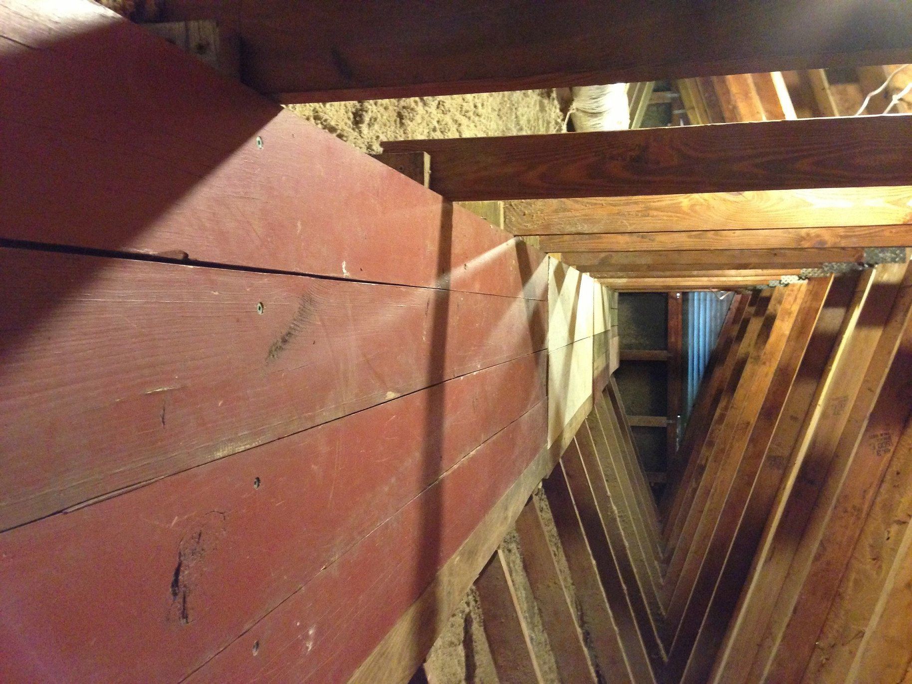

I determined to use just wood on hand and buy NOTHING (my employer ceased ops and I'm unemployed). Oddly, the few pressure treated planks I used, were the ones that immediately shrank in the attic heat, opening gaps. And it isn't even hot yet outside. Past the planks is a single piece of wood to sit on to work on the coax. You can probably left click to zoom in a bit. Most of the coax you see hanging down is to/from a OTA distro amp, four out. The Sat coax drops pretty straight down. Installer should be happy, if I convince him to put the duo node inside. There is a duplex outlet there, for the OTA rotor and preamp.
Crawlway, actually.

You can see the gaps between the boards in this pic. They were tight when installed. This gives a platform for work on the OTA & sat coax coming in from the roof. Previous pic showed the "crawlway" to the right of this picture.
Hey navychop, if your distribution point is in the attic you should encourage the installer to install the duo node there & not put it at the dish. It may require him to run a 3rd line from the dish, but that shouldn't be a big deal. With your equipment configuration everything can be tied into the node without additional devices. Imo less devices is less of chance for component failure.
Agreed! I hope to have him put the duo node inside, simple cable cut (I leave a lot of slack, for all runs- coax, romex, telephone and RJ-45).
The 3 lines from the dish hit a "grounding point" that does not "really" attach to a ground, on the roof. The three lines, plus other pre-run lines for future use, then go into the attic. And the three go straight to the receivers. The fourth, EXER, is in the attic now, but could be sent outside if that's where he insists the Duo node should go. Simple cuts in the attic can connect to a Duo, then out to the 2H/2J. All coax is labelled both at the grounding point/dish, and inside the attic. This should be a simple, quick, install. Or have I missed something?
