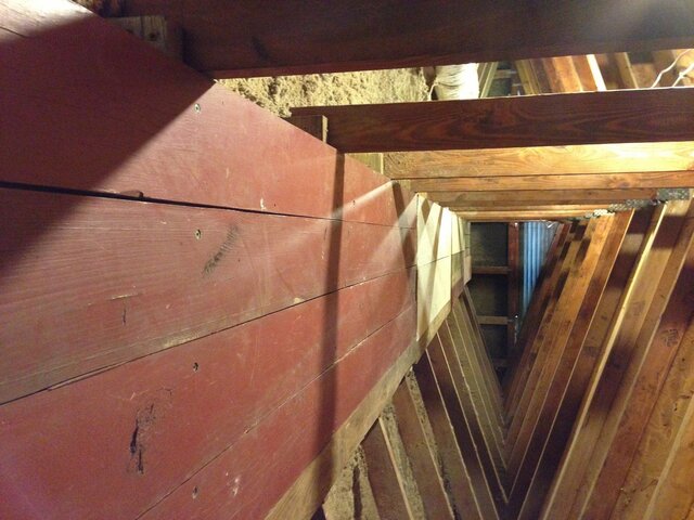

Must be nice to have all that attic space. :(
Can't use it due to heat, even after I put in the exhaust fan. Did blow in extra insulation which made a big difference.

I determined to use just wood on hand and buy NOTHING (my employer ceased ops and I'm unemployed). Oddly, the few pressure treated planks I used, were the ones that immediately shrank in the attic heat, opening gaps. And it isn't even hot yet outside. Past the planks is a single piece of wood to sit on to work on the coax. You can probably left click to zoom in a bit. Most of the coax you see hanging down is to/from a OTA distro amp, four out. The Sat coax drops pretty straight down. Installer should be happy, if I convince him to put the duo node inside. There is a duplex outlet there, for the OTA rotor and preamp.
Crawlway, actually.

You can see the gaps between the boards in this pic. They were tight when installed. This gives a platform for work on the OTA & sat coax coming in from the roof. Previous pic showed the "crawlway" to the right of this picture.

Wow I wish I had that cool walkway in my attic!:D
Wear a mask and put it in! Not hard. A few scraps of wood, or purchased, for cross beams. Use levels to determine left/right evenness, and between athwart-ships supports, and put 'em in! For greatest ease, buy 4x8s and have them cut them in half, 2' wide by 8' and go from there. You might need a few supports on both sides of a single rafter, but simple math will tell you where.

Not what I was referring to. My vaulted ceilings throughout most of my house means that most of my attic is a 3-ft crawlspace. Not something I can navigate, even to install an attic antenna. :(
