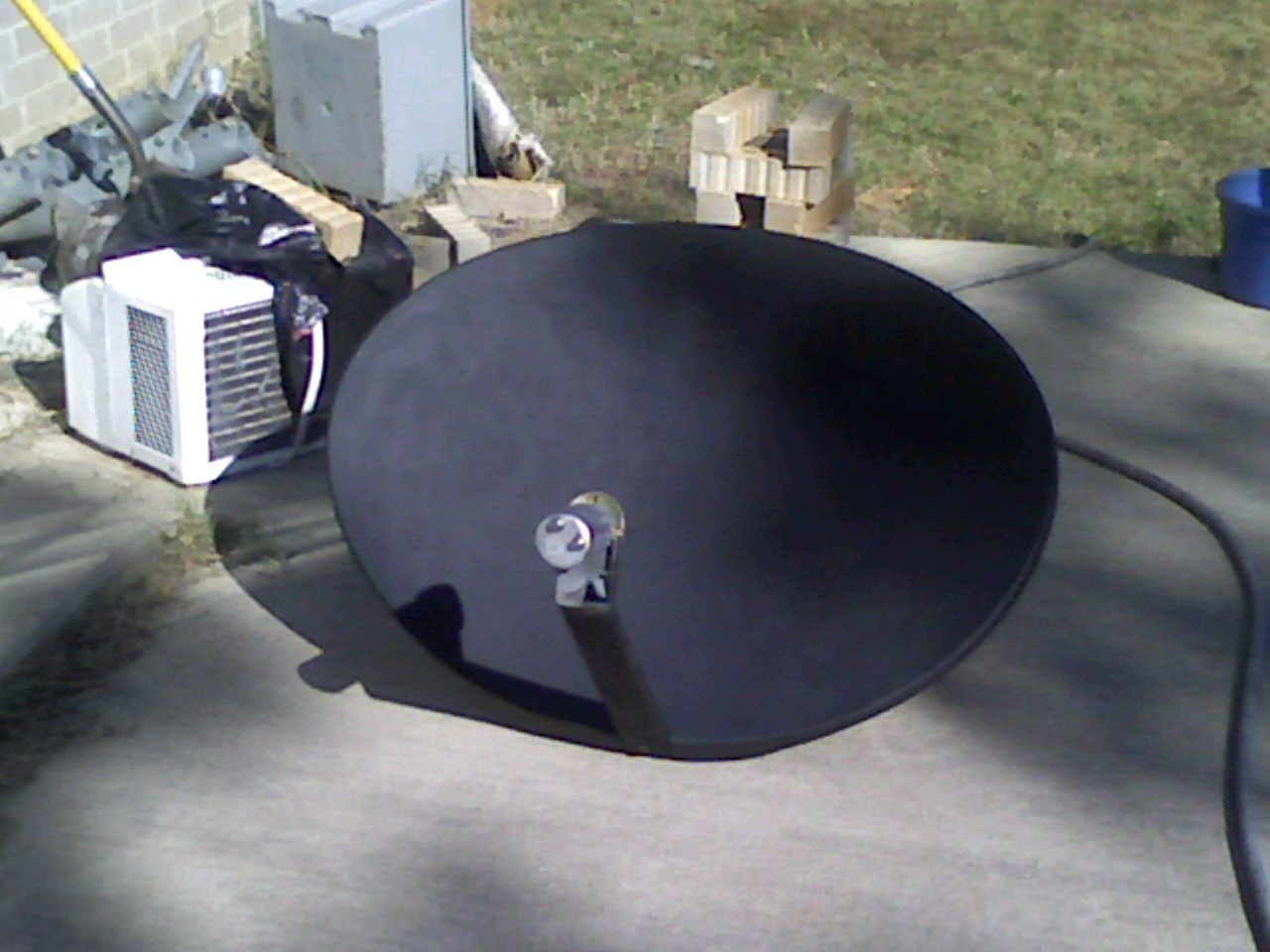

I have recently come across about 10 of the old primestar 79e and 84e dishes from my local cable company who was about to throw them in the trash as they are cleaning up the system site. I've also read that you can paint the dishes any color as long as its a flat paint so I have painted one of the many dishes black to test with. (pics will be coming soon of the dishes)

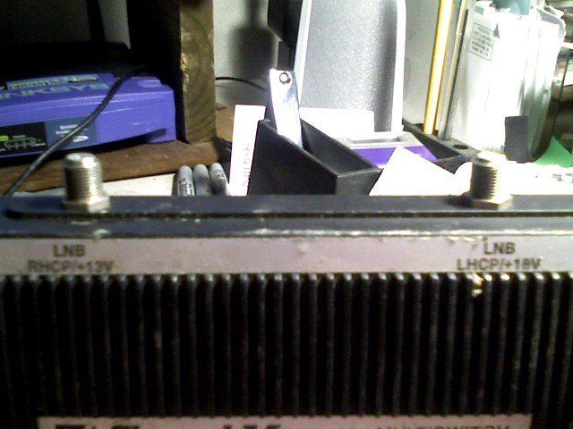

I have been doing some research for the last year or so on this forum plus others and have read constantly that these dishes are great for FTA. So I'm going to give it a whirl. Among some of the dishes that include the LNBF's I have come across several different types of lnbf's that were used on these dishes. all but 2 of them are the ones that have the V and H output marked. However the one in the picture below does not. I did a little research on the name and it "appears" that this is a more modern version of the primestar lnb's that combined the V and H outputs into one coax connector (except this one is a dual instead of a mono output) but would like some second opinions.

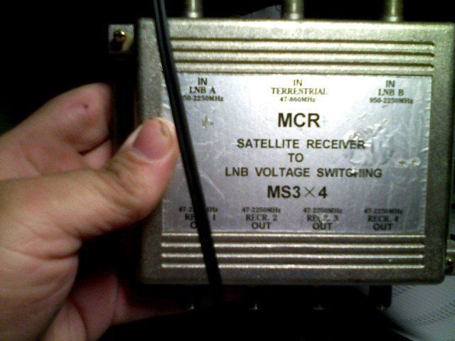

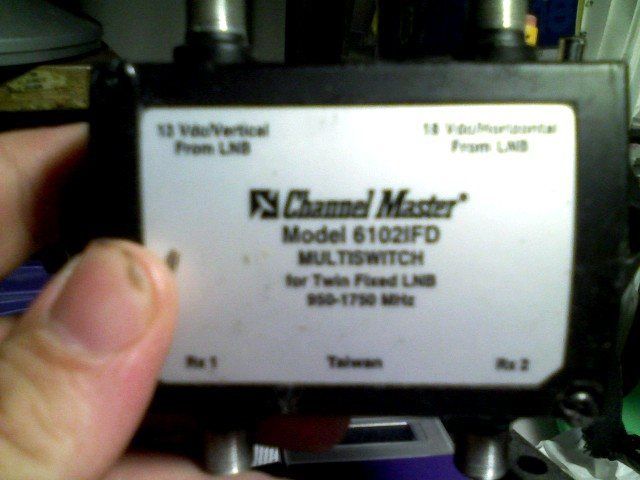

Also I have received several Multiswitches from the cable guy as well but am not sure if they will work. A couple of the dishes I picked up still had the channel master 2x2 switches still attached to the lbnf's so I know the system they used (he says it used to the the HITS service) was setup that way.
My question is will these switches work or will I need to buy some DiSEqC switches?

it looks like LNB might be a dual...no not the separate H & V but an actual dual LNB

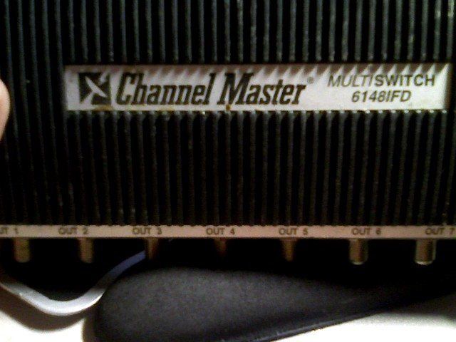

the switches are all multiswitches. They allow you to run up to 4 (or in the case of the last one 8) receivers off one dual LNB. If you use more than one dish you would need diseqc switches. Here are some diagrams about multiswitches
http://www.satelliteguys.us/1344314-post7.html
and the thread that shows more options
http://www.satelliteguys.us/fta-mpeg2-faqs/134124-switch-setups-simplified.html

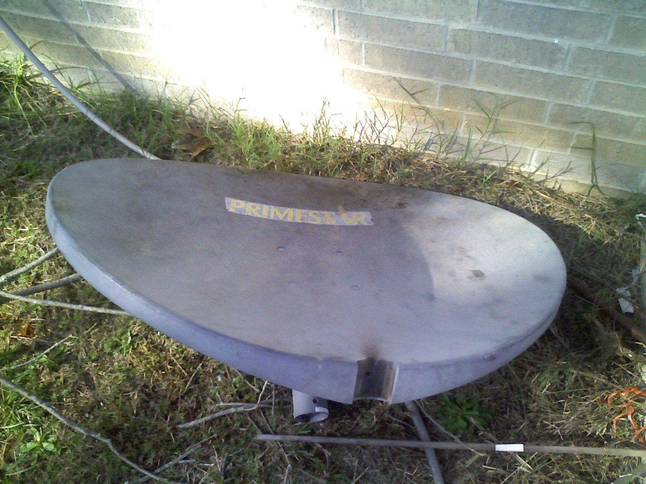

As promised here are pictures of the dishes. most of them are still in a pile but I took a picture of them anyway.

Nice collection, C
Gotta wonder why a cable company would have 'em?
Too small for their use...
If they took them on trade-in, they've sat on 'em for way too many years! :cool:
So, where ya located?
Buddy, can you spare a cup of Primestar? - :D
Wow Nice find. The P* dishes are great! I'm lucky enough to have one 90cm and love it wish I could find a haul like you did. One mans garbage is another mans treasure :)
The cable company here used them for "Digital Cable" because they didnt want to upgrade the whole city wide system to digital so instead they used these type of dishes for the HITS movie channels and others channels through the HITs system. he claims the dishes were pointed at G11 but they are all pointed almost due south so they had to be pointed to either G26 or G25. I live in a little town called Nashville Arkansas. At one time COX owned the cable system here but around 15 years ago sold it to Suddenlink/Cebridge Communications.

The dishes I got are not skewable themselves but I figured out how to skew the lnb after tinkering. you rotate the feedhorn and not the lnb so the screwholes and the bracket never moves. pretty clever way to hide the fact they are skewable.

I took a closer look at the MultiSwitches you posted, above.
Sure, keep them.
All depends on what configuration you decide to set up, but they could well play a vital role.
For a simple starter hookup, you might use one dish/LNB and one of those switches.
But, if you decide to use up to four dishes/LNBs, then those multiswitches might be aided by some 4-input, 1-output diseqc switches.
