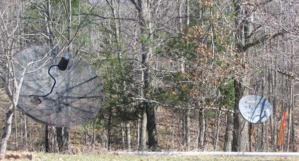

Primestar - It's a Boy! (warning graphic content)
Mother & son are doing fine.
Mama C-band had a 1.0x0.7 Primestar early this evening.
pic 1: mama & baby son. NOTE: this shows the offset of the primestar pretty well, both are pointing at AMC9

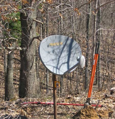

pic 2: close up of the bouncing baby-boy. NOTE: birth required use of the giant forceps seen in background :eek:

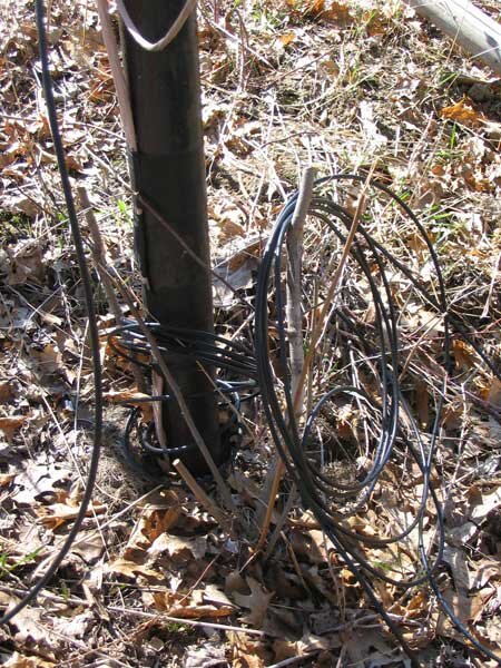

pic 3: WARNING, not for the faint of heart.. C-Band After Birth
Nice work=is that your angle-meter hanging on the pole? I do that all the time too lol.
Those primestars are great, and they really pull in RTN, and yep Black Sheep Squadron
was coming in fine.
yep.. angle finder hanging there.. I've read numerous times on here how accurate the elevation scale is. according to my levels this mast is pretty much dead-on plumb, BUT the scale then is way off.
according to dish pointer, AMC9 for me should be at 39.7.
But to get that sat, the built-in elevation scale shows over 42. Angle finder on top of the mount shows just a tad under 40.. go figure
