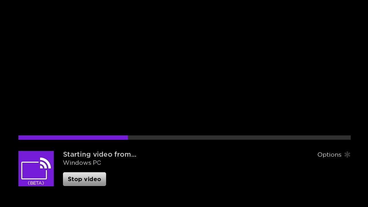

So I got a new Roku 3 for Christmas and I ran into a bit of a problem.
I followed these steps:
http://support.roku.com/entries/55901124-How-do-I-enable-screen-mirroring-on-a-Windows-8-x-device-
And I got to here:
http://support.roku.com/attachments...SMGRvMKM/?name=Roku_Stop+Video+option_Win.jpg
And then it froze. It froze with that graphic displayed on my TV.
Anybody know how I can get past this point so my TV mirrors what's on my laptop?
Also how do I know if my laptop has Miracast? I had assumed if you have Windows 8.1 you would have it automatically but I'm not so sure now.
If your laptop has windows 8.1 it will have miracast. It is not called Miracast though. Unfortunately unlike AirPlay this type of mirroring is called something different on every device. Often it's called something like Wireless display. Do you have an Android device to try out with the Roku 3?
Thanks for answering me guys.
I fixed it already. My graphics driver wasn't up to date and once I did that it gave me the option to "Add a wireless display" in the charms menu.
