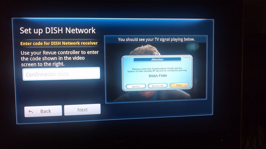

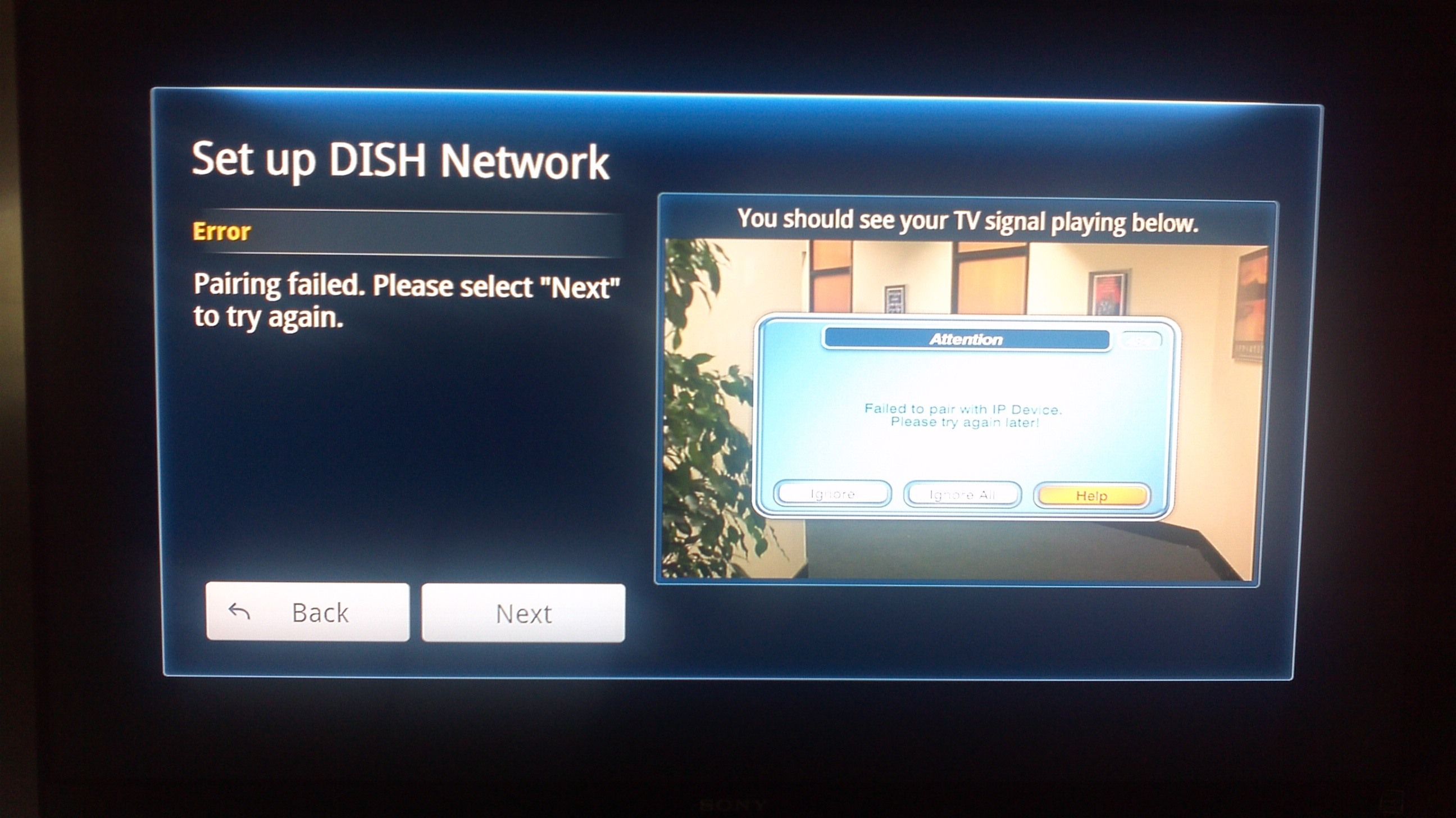

I just can not pair my vip722 dvr with my logitech revue with google tv.
I am attaching 2 pics showing the error I get.
Help !

On the receiver, go to menu-6-1-9-5-settings and make sure UPnP is enabled on the receiver, then try pairing the devices again.
If that doesn't work, try resetting the receiver, and Revue, and pairing the devices again. Let me know if this does not work
Using the Revue keyboard, access "HOME" and highlight "Applications". Select "Settings" then "TV Source".
Select any devices listed under "Edit configured devices."
Then select "Disconnect Device."
After you do this, you should be prompted to pair again

I just did what you told me to do, I get the same result.
Forgot to mention that I have both my devices conneted to my home wifi network.
When I enter the code dish network gives me, is that case sensitive ? should I type the space between the 2 sets of numbers or should I replace it with a dash ? I have tried everything...

When I go to Settings, Video Input, Configured Devices it gives me shows me in the "Select Available Source" the DISH DVR with the ip address and the DVR name. When I select the box it immediately does to "Add new device" and then I accept the DISH Network Experience. It prompts me to ender code for the DISH network receiver. I enter the code and it tells me fail every time.
