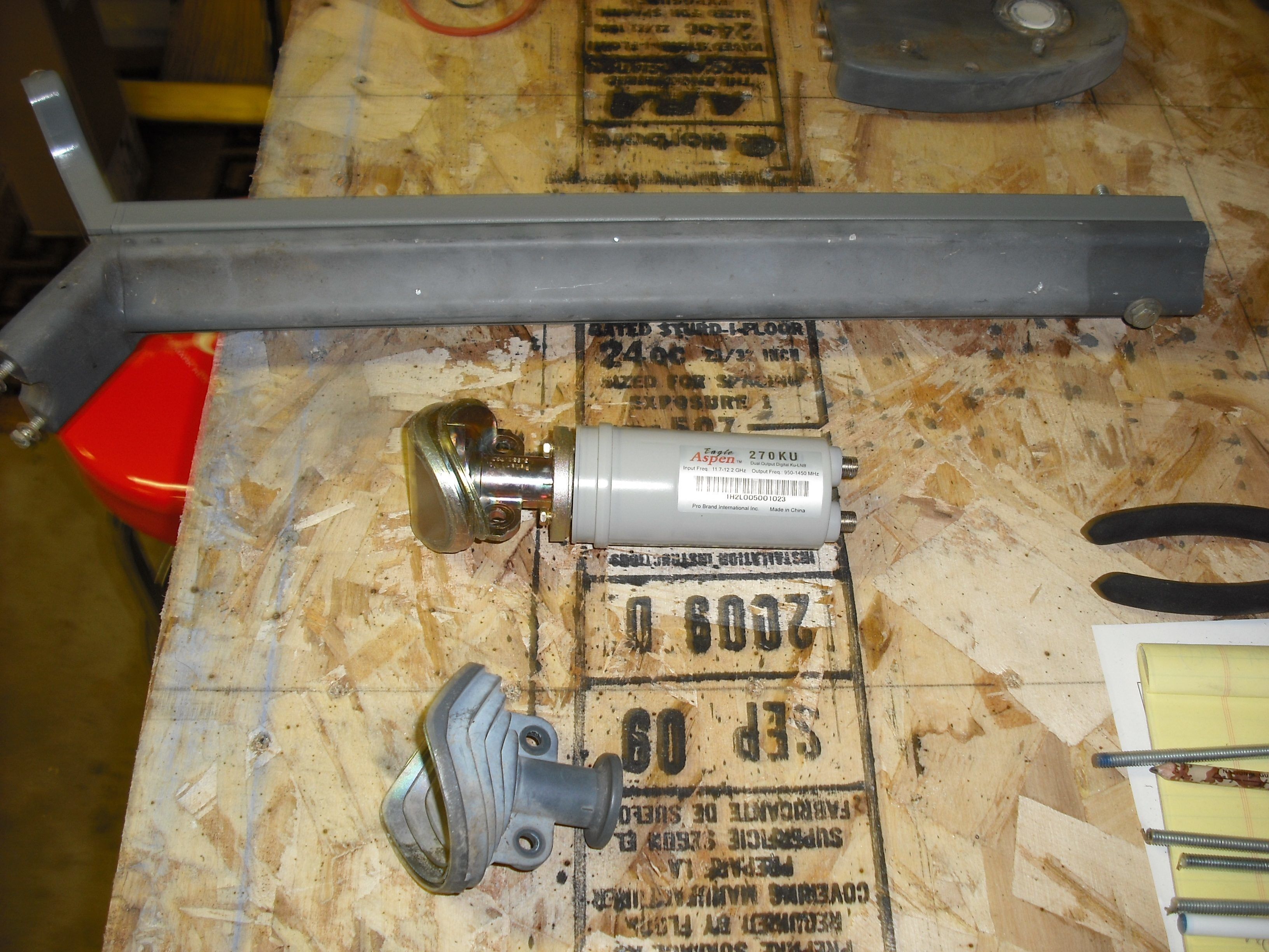

The LNB that came with my WSNet 84e setup had a brand new Eagle Aspen P270KU which features dual outputs each with voltage-controlled H/V. Here is a pic of the LNB (still attached to the smaller feed horn). After I get the larger feed horn cleaned up I will bolt it to this LNB.
Also I am attaching a pdf doc that has the specs of this LNB if anyone is interested.

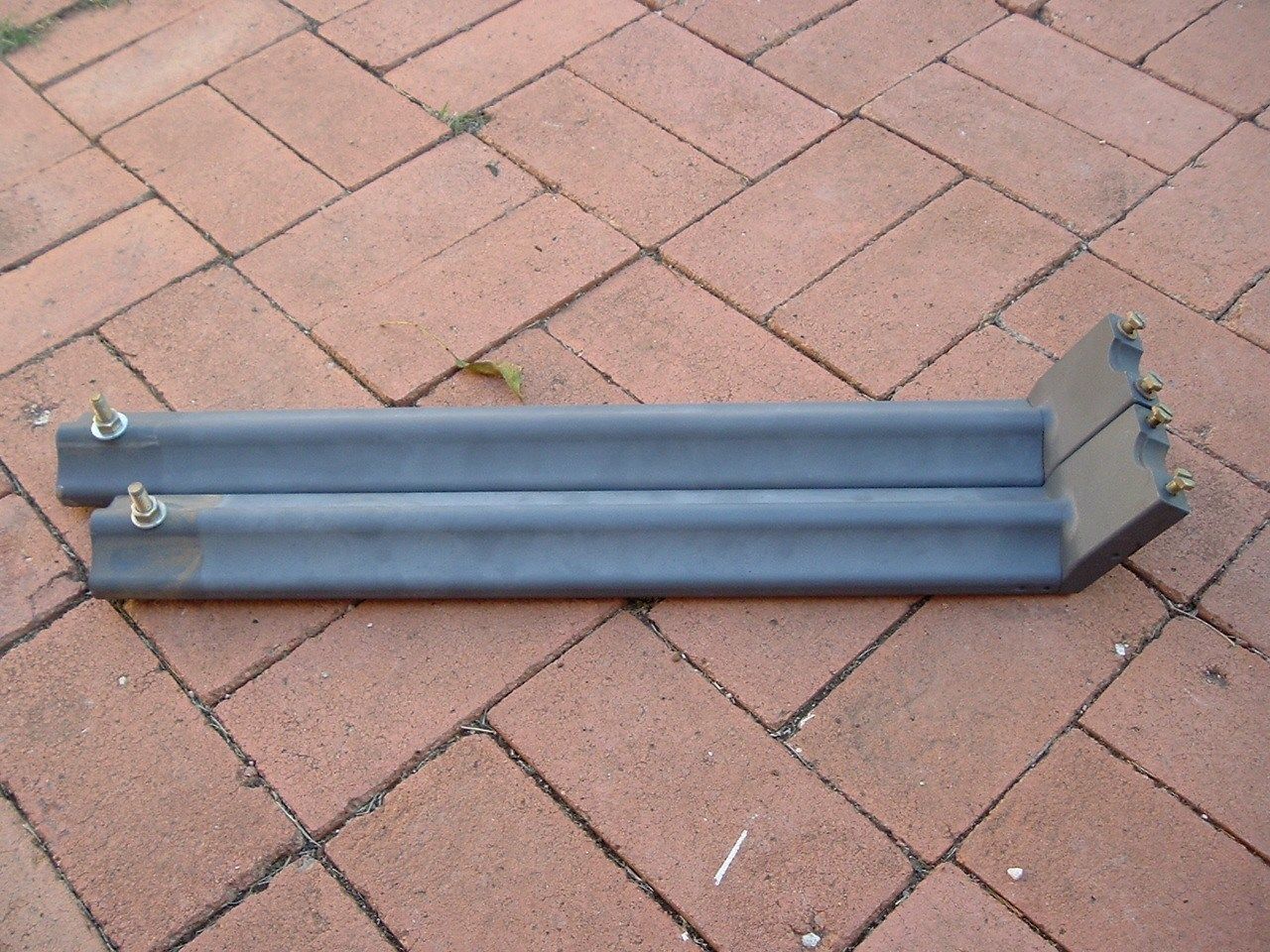

Thats great news...you can shorten one of your 84e arms with a hacksaw and drill a new hole in it for the mounting bolt thereby making it a 75e arm. You got to shorten it by 1 1/2" and the mounting hole sits back just about 1 3/16". The center insert threads with your mounting bolt and slides right out.

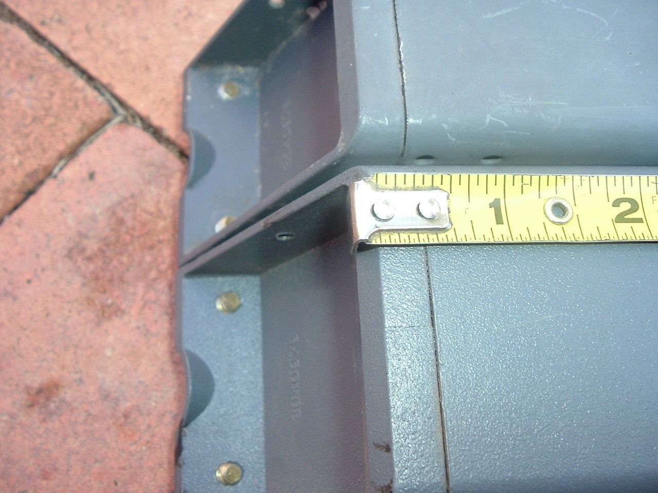

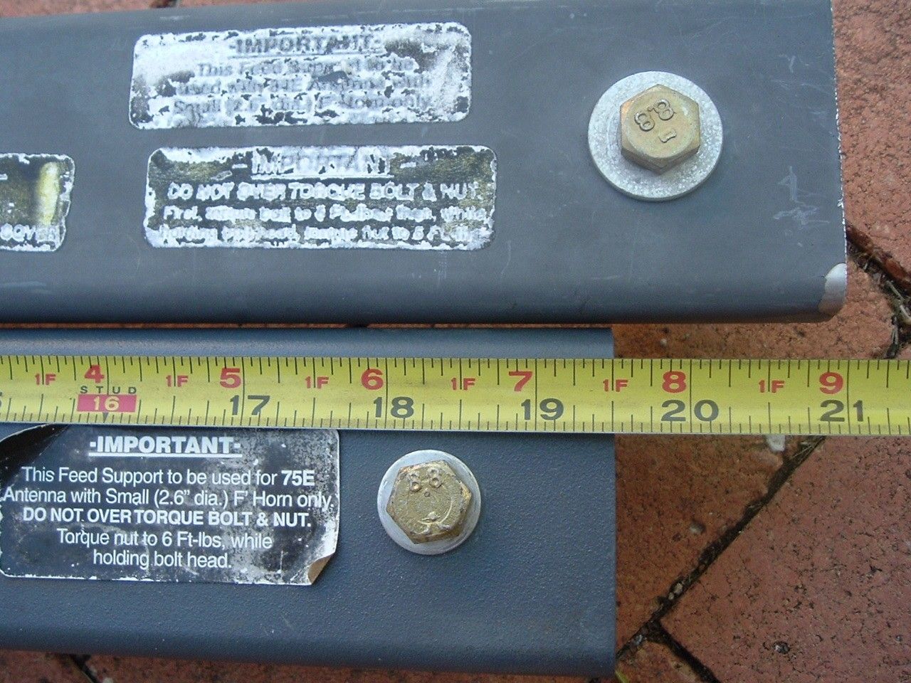

The only difference is the length of the arm. I have placed both arms on the patio next to each other in my response to you to take accurate measurments...they look identical in every other way except for the length.
Attached are some pictures...please note how the beginning of my tape measure catches some length from the slant on the LNB holder. Also note that the bolt is an 8.8 metric.
This probably goes without saying but I will say it anyway. In order to make this modification near factory perfect I would draw a line all the way around the arm; hacksaw from different sides slightly above my line and file smoothly so as to get a square cut. I would also drill pilot holes 1 3/16" down on each side from my square cut to make sure the holes for the bolt was straight. If you look closely at your dish you will see that the arm butts up against a lip on the back of the dish...measure the distance from this lip to the threaded hole to see if it is in fact 1 3/16". You want this arm to butt up tight to the lip so that it doesn't swivel.
