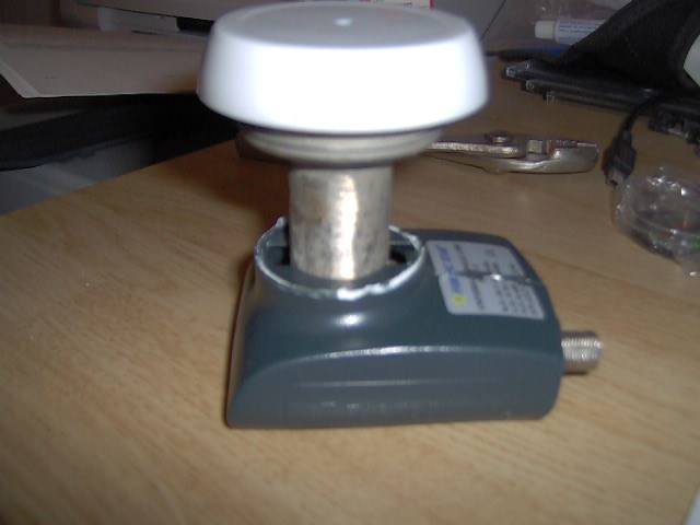

I use Sadoun duals on my Primestar dishes. You might have to gut the casing behind the LNB to get the 25mm LNB shaft
You don't happen to have a pic of this do you? You're talking about the casing on the new LNBF right?
Thanks.

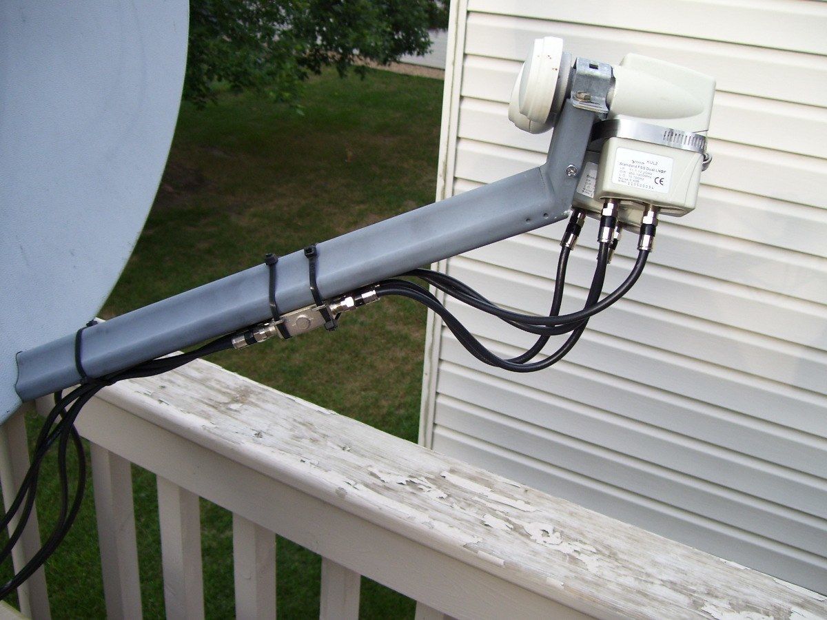

yes the casing off the LNB...right behind the eye. Use a clamp to bolt it to the dish

here is a better view of what a LNB would look like with that casing missing (different LNB but same concept)

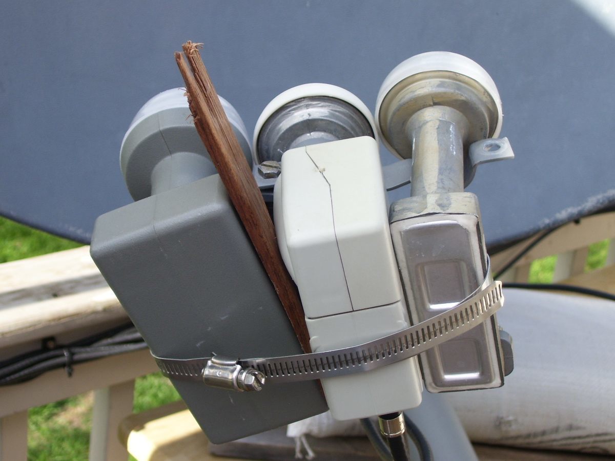

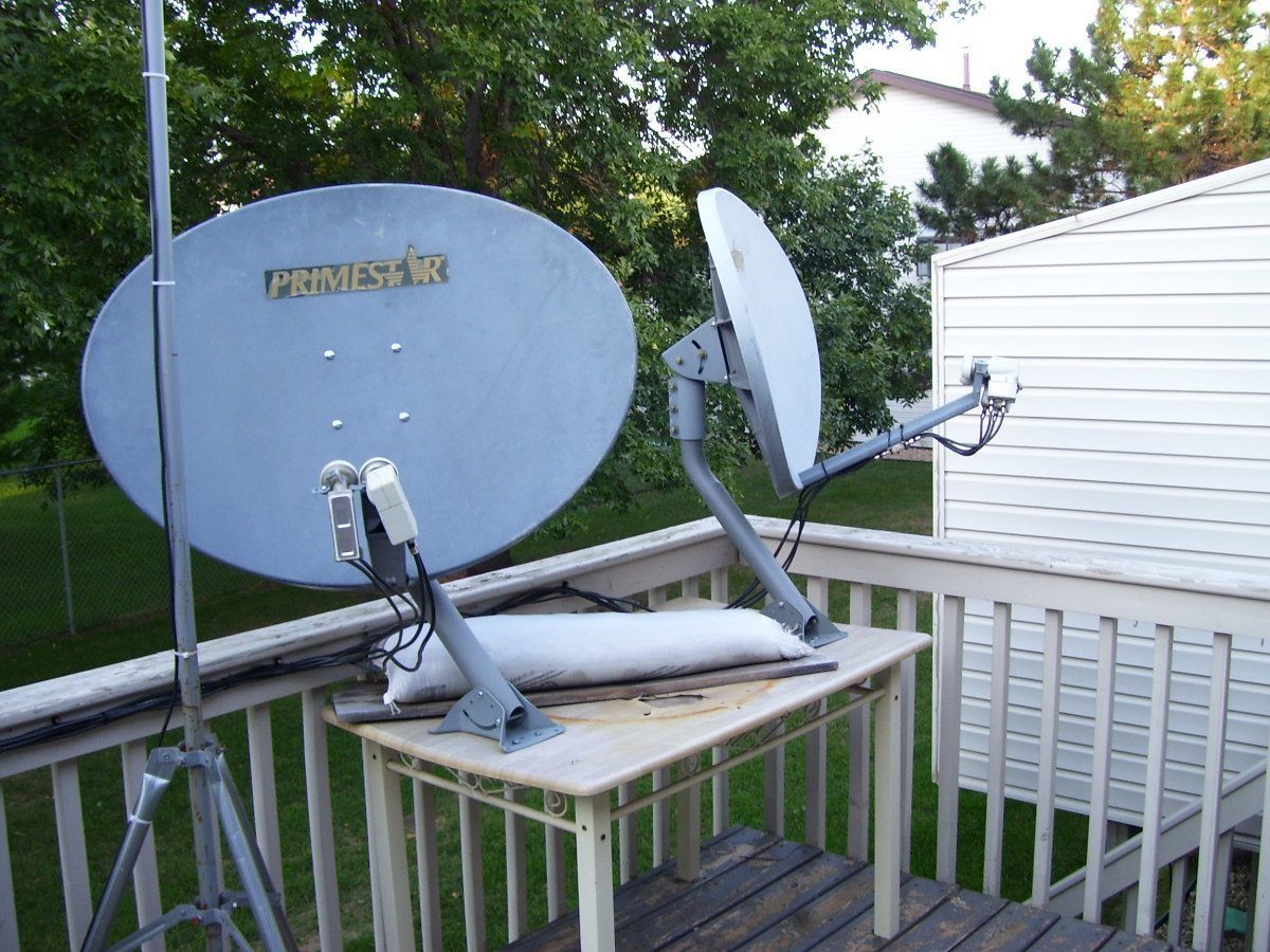

I did have at one point 123/119 and due to 119 being so strong it works just fine ( see pic below) but I did try 105/101 KU on a dish and could only get 3ABN (which is very strong) at about a 30 quality on the Pansat...I could get 105/111 with ease (and a piece of wood to get the angle right...the LNB eyes were touching)
2nd pic was my gangetr ghetto 119/123/129 setup...119 & 129 were DBS
