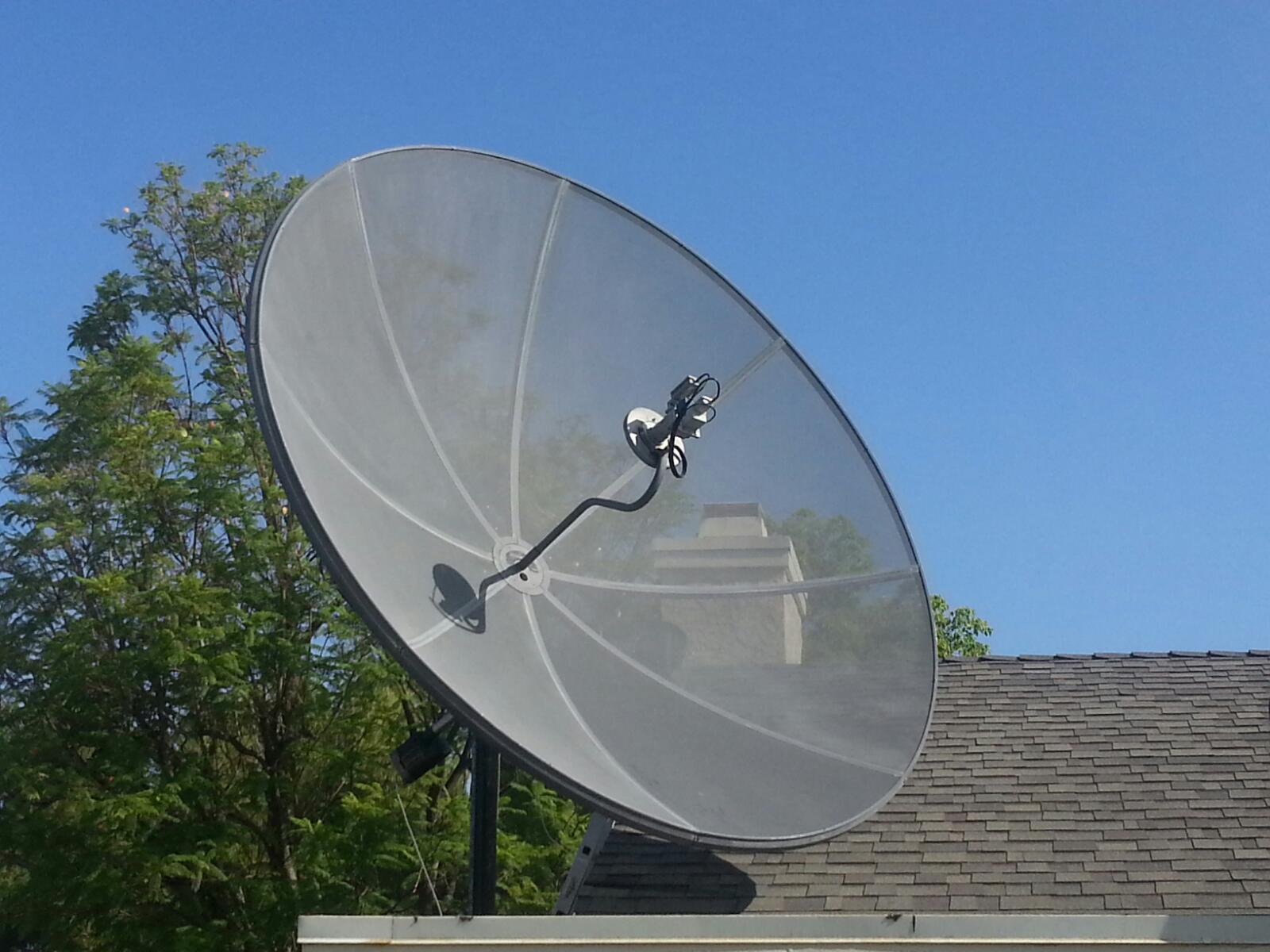

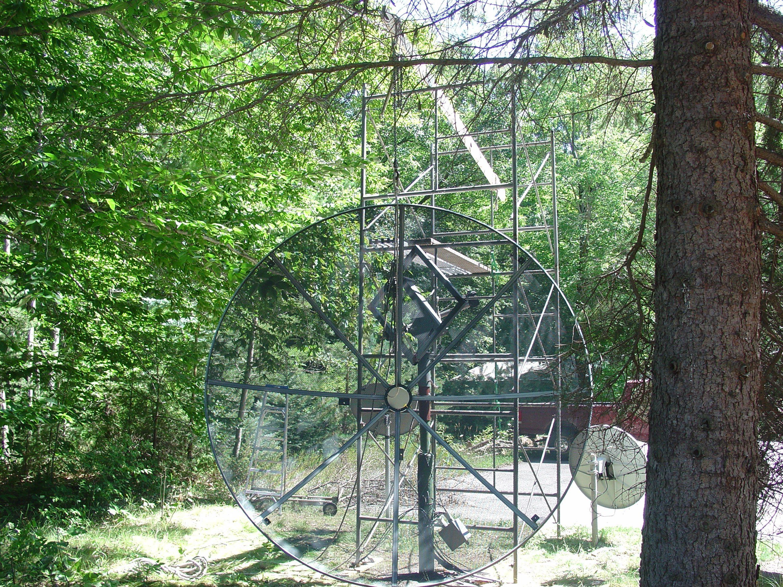

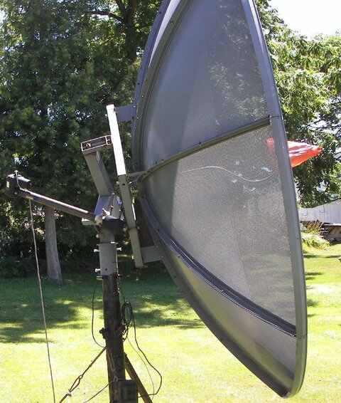

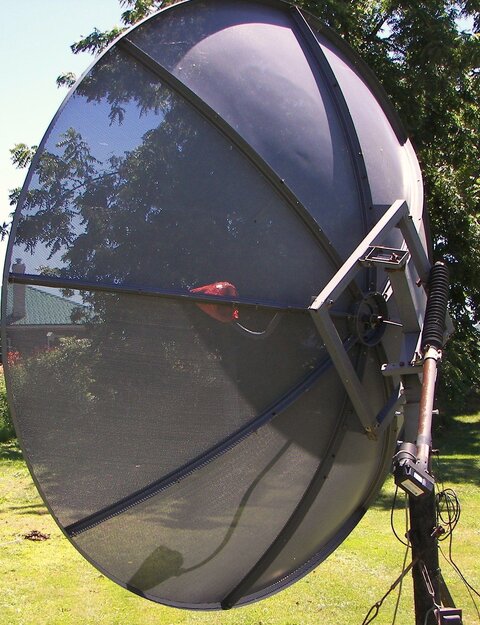

If you want to see the range with a 24",I haven't actually measured it but an 18" would probably do the same.Pic 1 is below my west horizon,my snow dump position(which doesn't work because the snow won't come out of the damn thing:D),pic 2 is all the way east ( could go a bit further but pointless due to trees/buildings).
Two more motor wires. Motor with an unbalanced weight on the shaft. Bolted to the dish. Shakes it out with a pushbutton!
The biggest problem is it will get a little layer of icy stuff that locks it into the perforations.When it's cold enough and dry snow it comes right out or the wind just takes care of it.:D
I've actually thought of attaching a motor with an eccentric on it to vibrate it out.:eek:

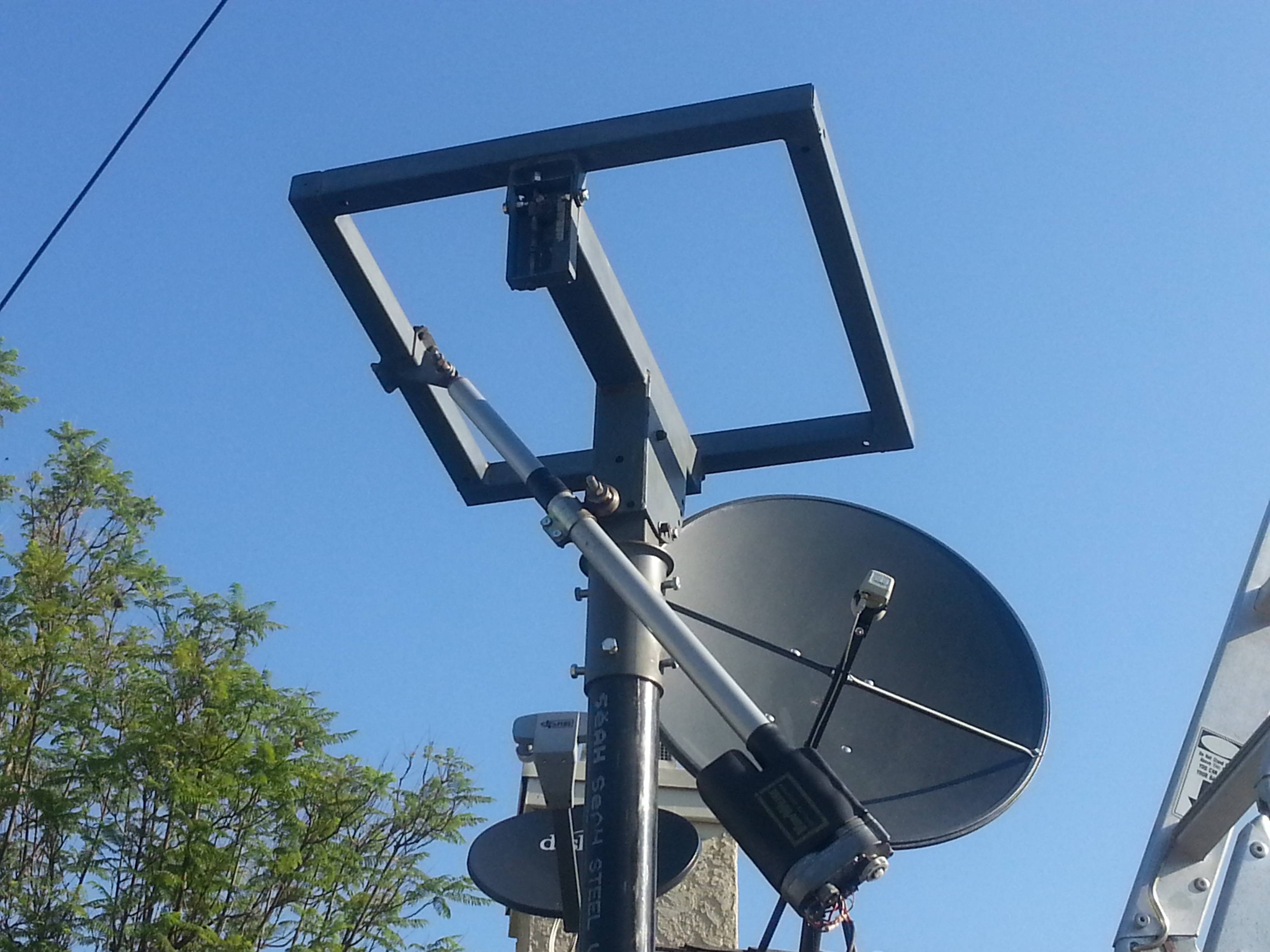

Von Weise Actuator Refurbished and Installed!
I installed the Von Weise Actuator last night after dark (see picture). I spun the mount around and took as much of the declination angle out as possible (mount is closer to the roof edge in this position). I noticed that the mount tends to "flop over" when it gets near it's West Limit. I set the limit switch to stop the actuator before that happens. The fully retracted limit cannot be adjusted, that position is set of course by sliding the actuator in the saddle bracket. I ran the actuator fully out, then back in, it works great.

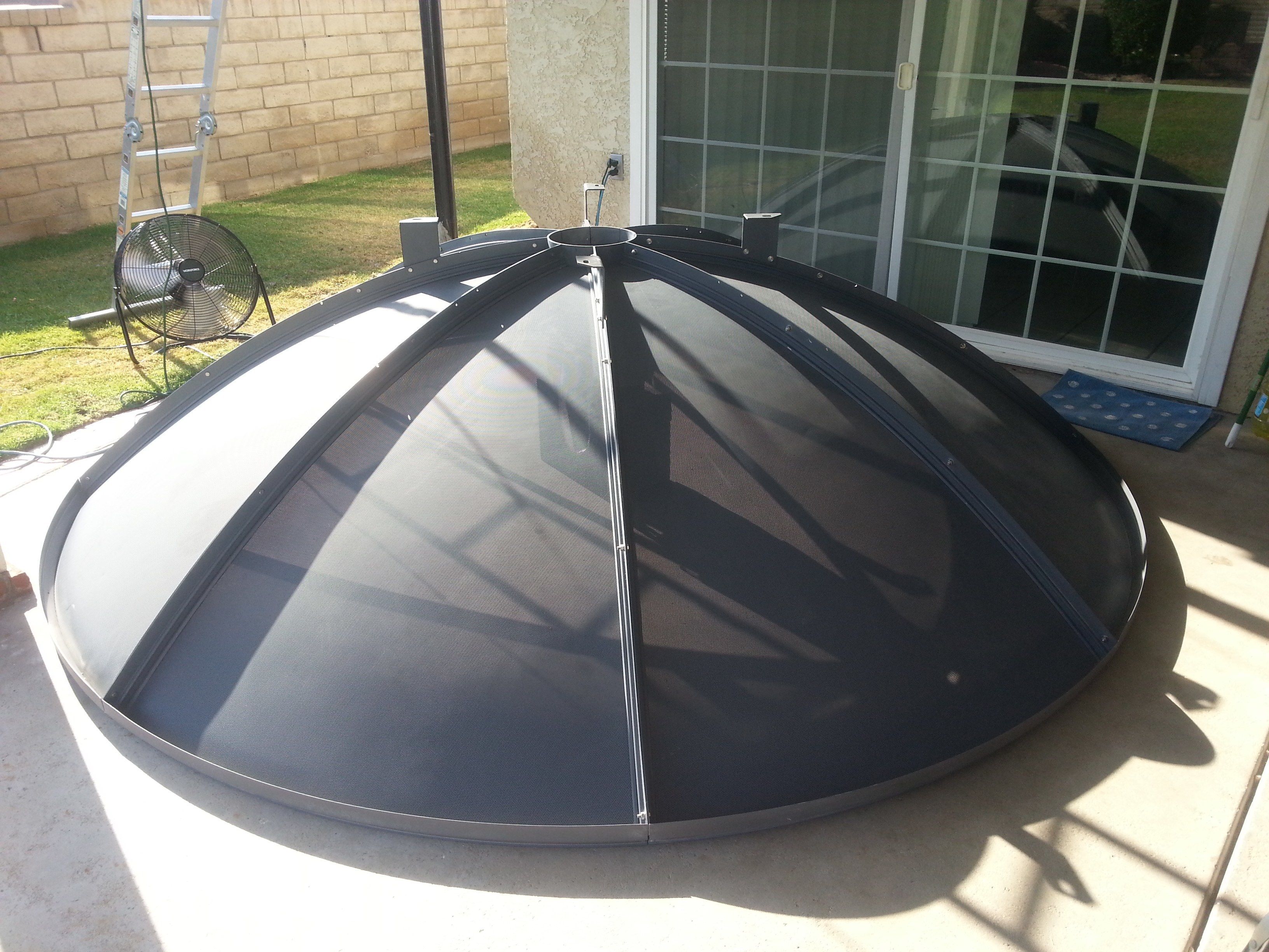

Reflector Assembly Complete!

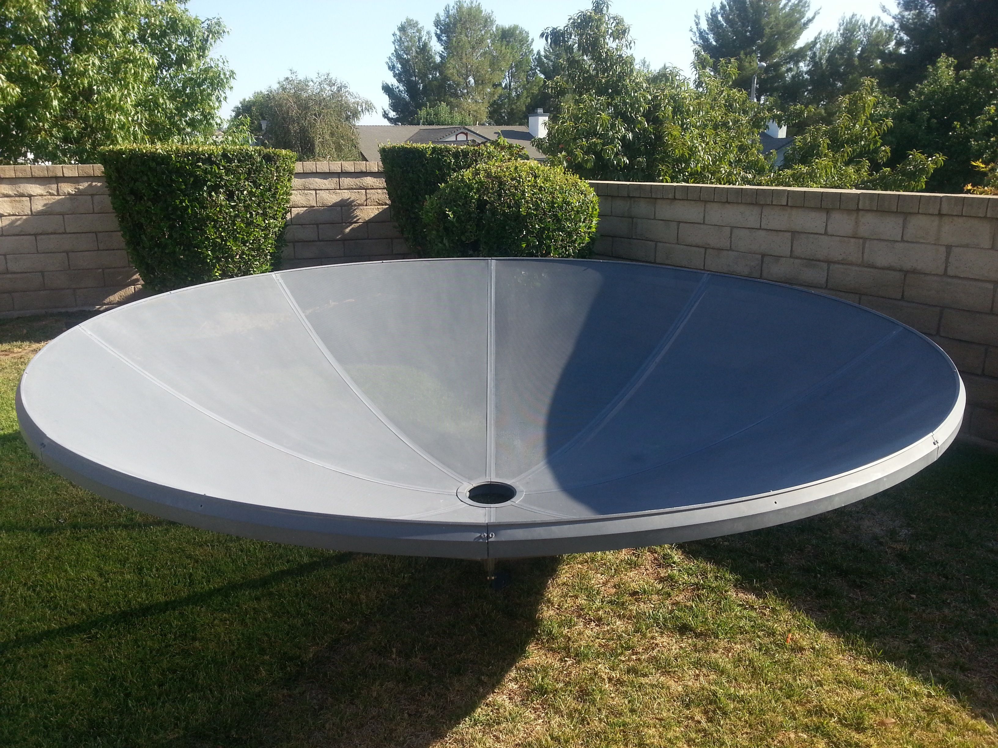

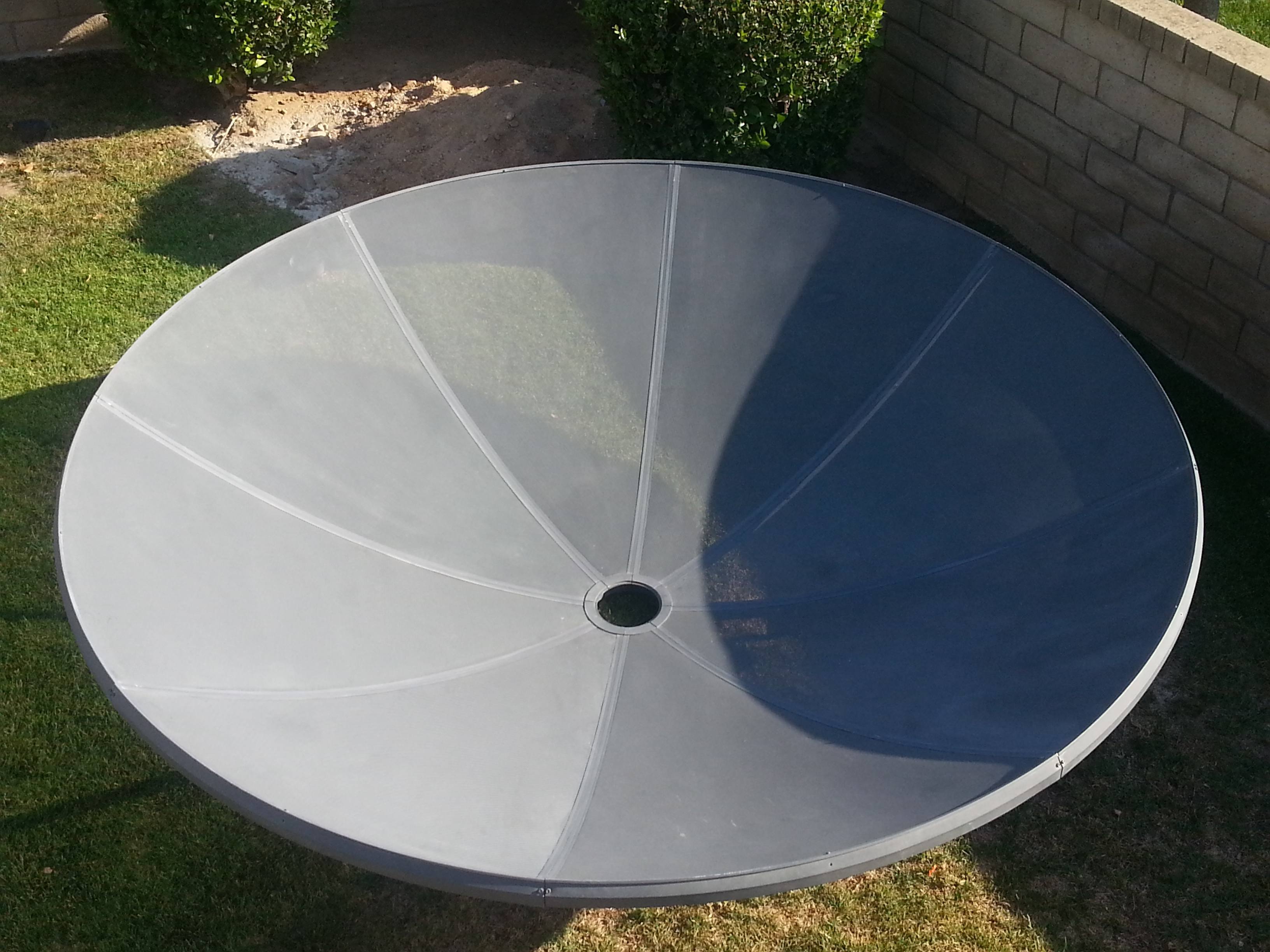

Well Gentlemen ... the reflector assembly is complete. Getting that last panel locked in was difficult!. The brackets are installed in the proper sequence and have been leveled. My wife helped me take the reflector off the patio (upside down). We were able to flip it 180 degrees and it's out in my yard sitting on it's mounting brackets. Several family members (men) will be coming over tomorrow at 7pm. We'll lift the reflector onto the patio roof, then they'll climb up and we'll lift the reflector to it's final position on top of the Polar Mount. Thanks for the climbing suggestions. I'm a Tower Monkey and have done allot of hilltop antenna work. I'm comfortable on a 200 foot tower on a hilltop. Yes your right, never look up at the clouds, it causes vertigo for a few seconds. The ladder will be strapped to the pole with several ratchet straps. I'll be secured to the pole with my tower belt. I'm more worried about my family members on the patio roof. We'll take it slow and easy. I'm gonna go over with them several times exactly what were going to do. I'll call out the steps to them. My wife will have the camera so I'll get you some good pictures. More info soon!

Well, my bud is in the air. I'm gonna try and attach a picture to this post. I'm currently experiencing CRS (Can't Receive Sh*t). The Ku LNB is dropping out, the 22K switch isn't working right, the polarity control seems to screw up everything. I'm not happy with my progress. Well Rome wasn't built in a day. I'm gonna make a trip to WSI in the Valley tomorrow to get a LBNF to point with. I'll fool around with the feedhorn, LNB's, polarity contol later. I just stuck the button hook in there for the picture (not aligned)

Good Morning Gentlemen! I've got NEWS ... and GOOD NEWS! Being a Newbie, some of my problems were created by not knowing what I was doing :D. Anyway, long story short, I've got the Pinnacle aligned and I'm receiving 20 C-Band Sats from 72W - 137W. Nice BIG STRONG SIGNALS (ranging between 70 to 85%). The biggest signals are on 91w, 113w, 131w (those are between 80 to 84). My kids are currently watching Calliou on Sprout HD (131w AMC11). The declination angle on the PM was set to 50 degrees (when I bought it). That was wrong of course. My declination angle is currently set to 35 degrees and it tracks all the sats perfectly). There is allot of slop in the Von Weise (maybe a degree or so). It doesn't cause problems with the C-Band sats, but it sure does with the Ku Band sats (I have to nudge it with the E/W buttons to get the signal to come in). I aligned the BUD to True N/S by setting up on 118.8W Ku AF3 (this is my true south satellite). I used a bubble level on the frame of the PM to insure that it was level at that position. At that position, I reset the V-BOX to 000. Once True North and the Declination Angle was correct, all the sats came in. When I first put the LBNF on, all I could receive was Vertical TP's. This was caused by me not knowing how to set up the LBNF. After fooling around with it for a while and figuring out the proper skew, my scans were showing both V and H TP's. There was some fine tuning of the skew as some of the channels were intermittently freezing. After I was getting all the channels, I slid the Feed Hook in and out to optimize the signal strength. So far, I have only watched one Ku sat on the BUD (125w AMC21). The TP that the main PBS feeds come in on (PBS Pacific, PBS East, etc), came in nice and strong at 70% (just as good as my 90cm dish). I could even pick up OETA ... not bad.
