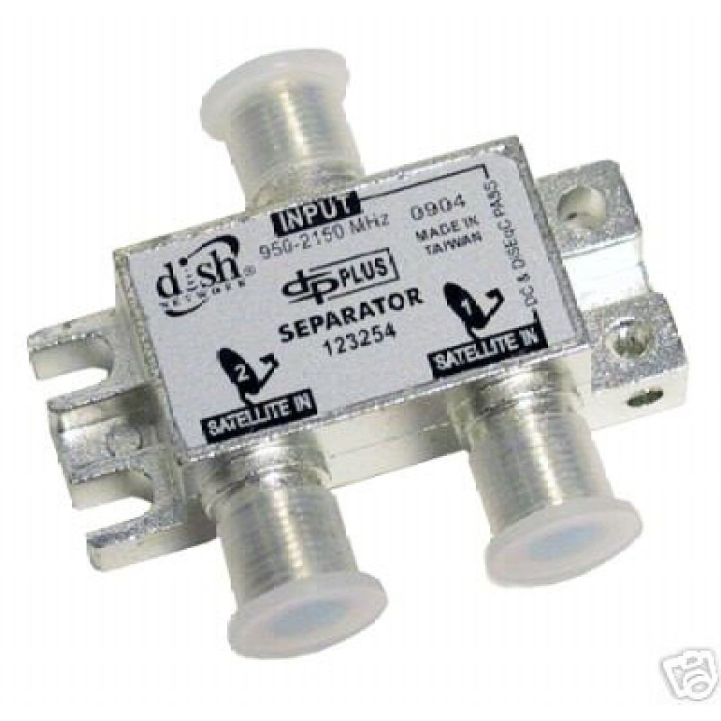

My recollection on that dpp triplexer is that they didn't start producing and shipping that with rx's until the HD-DVR models like 722. The 522/625 originally came with a diplexer (same as above but without the antenna signal port. Worked the same way, split the single coax from dpp (dish pro plus) lnb on the dish to go to both of the tuner inputs on the rx.
The triplexer was evidently added later by dealer, but it works just like the diplexer as far as the dish signals are concerned. Before they started with that you could still accomplish diplexing offair signals along with sat signals on the single coax, it's just that you had to provide a signal combiner outside and a signal separator inside to put in the coax line before the (older) diplexer. Most never did do offair with those triplexers and thus never used that third port.
That's a Separator, not a Diplexer
