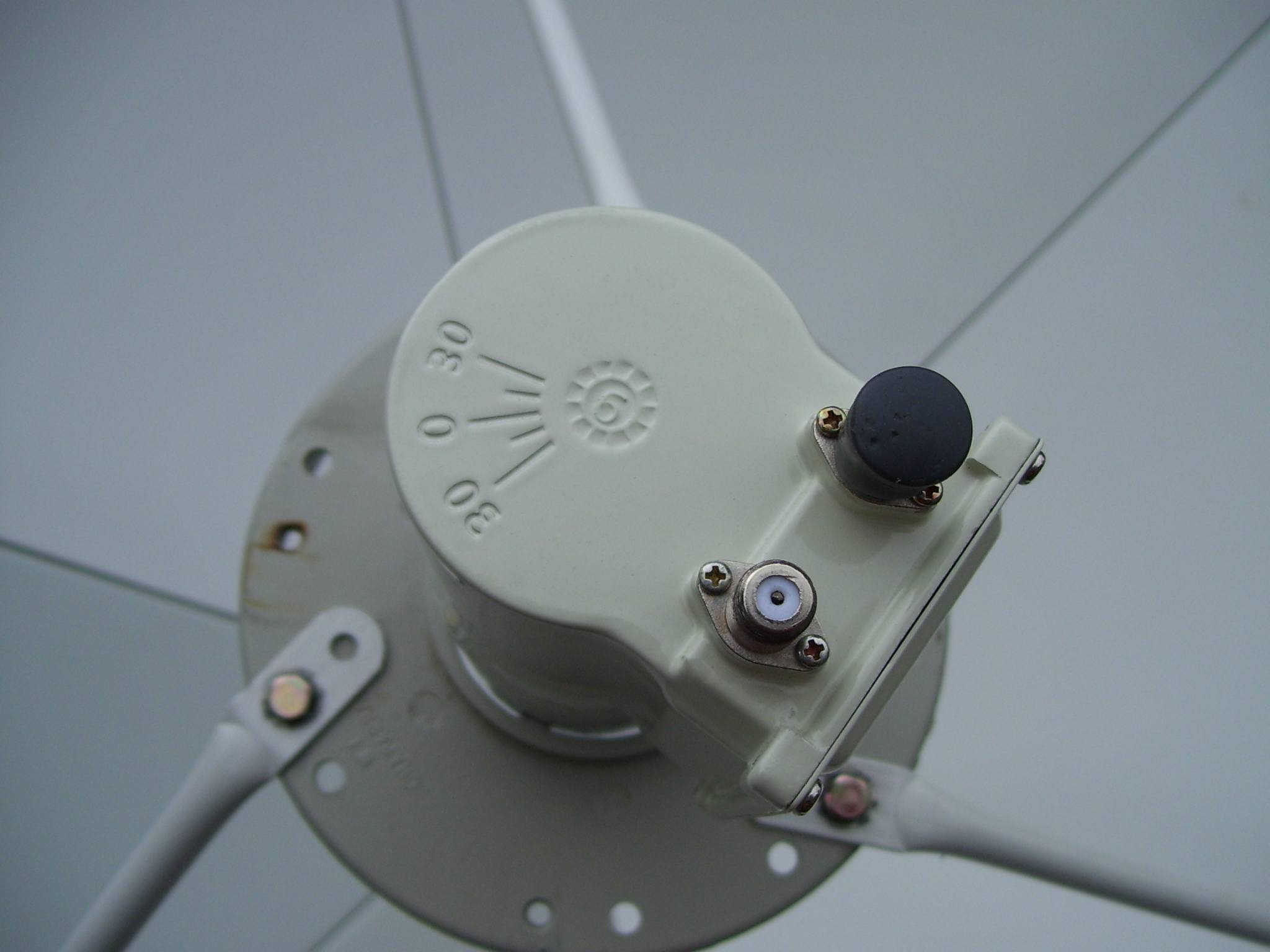

Hi guys,
I'm so what Confused :confused: with this lnbf. I have the DMX 741 and is working fine with my 6 footer. The only thing that I could not get was decent ku. So I setup my old 1M Ku dish and presto.. C and Ku the hard way. I'm using a DiSEqC switch to control both dishes and for must part the setup works pretty good. Since I was bored at home, I'm retired and my wife works all day,... but now that I think about it I would have been bored anyway.....back to my story. I got the DMX 242 today and within a fews minutes I had that sucker ready to go until I turned my receiver on. No signal l:mad: ..... bummer and some other choice worlds that I will not mention on this forum. I went back and checked the cables and I did not see anything wrong with them. I have the lnbf hooked up directly into my receiver. Is my lnbf dead or is it my brain?
Thanks,
Confused in Florida :confused:

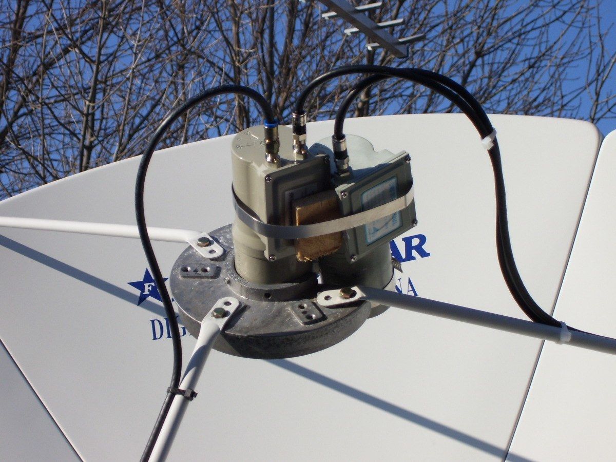

turn (skew) the LNB 90 degrees
For some reason the 242 (and may other C-Band only units) the skew is off by 90 degrees. The 741 its right (0 skew is like 12:00 on a clock)
Turn the skew so its at 3:00 or 9:00 (visualize a clock). See attached pic. My fixed dish is at 99W which is like a 7 skew for me in MInneapolis

Thank you Ice that pretty much took care of it. Just one more question, what is your F/D ratio for your 6'? I have mine set on 0.40.
Mine I think is set at 38 or so....SInce I ghetto move my dish I really dont look at the numbers anymore...Its all rial and error for me :)
So turning it 90 degrees fixed the issue?
cool.
I have yet to find one of these voltage LNBF's for C-Band only that isn't off by 90 degrees
The C/KU units are all skewed properly but the C-Band only ones always seem to be off
