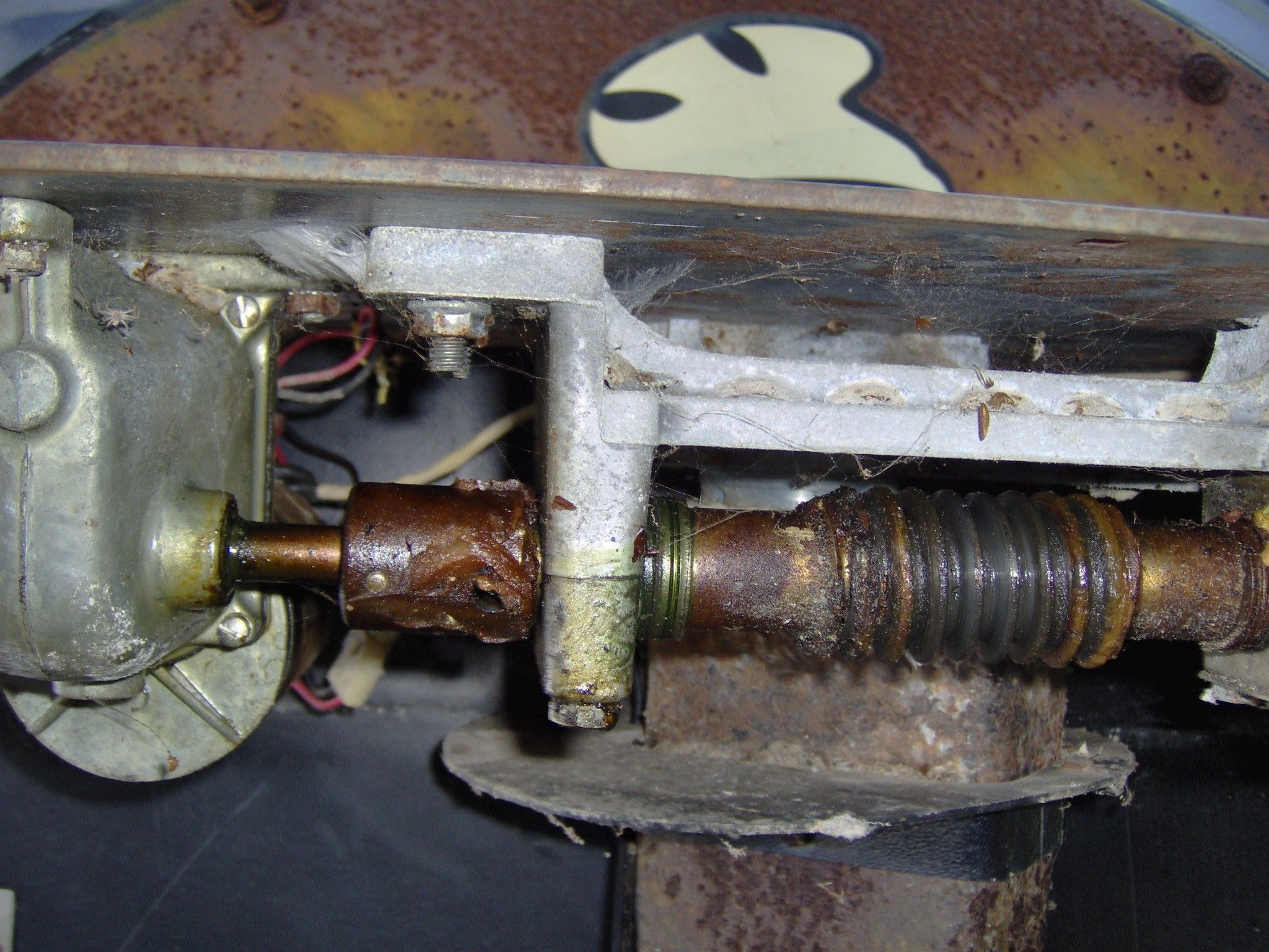

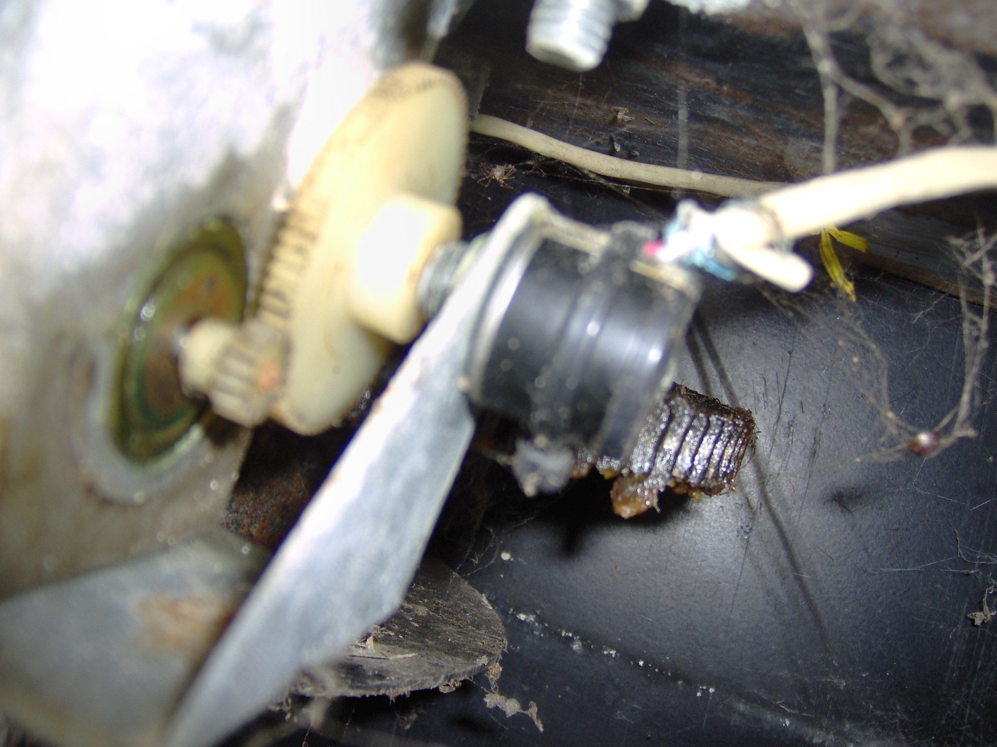

Checked everything and it looks good still, just to give you a heads up i have used it recently as per original post i tracked numerous satelittes and had decent pictures on different sats. wiring looked good i will take some pictures and post them tommorow so you can see what we are up against and then we will go from there also did not see any critters either under the cover or in the feedhorn area . Thanks for this help NOEXE hopefully i will be able to get this unit up and running again ..

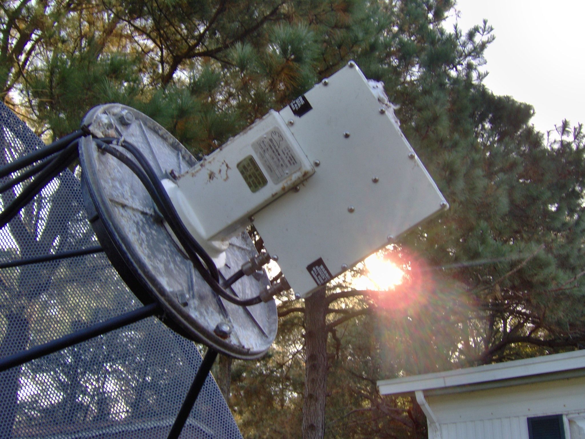

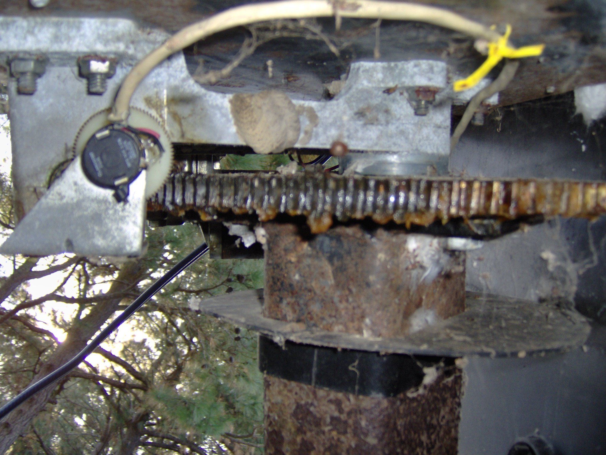

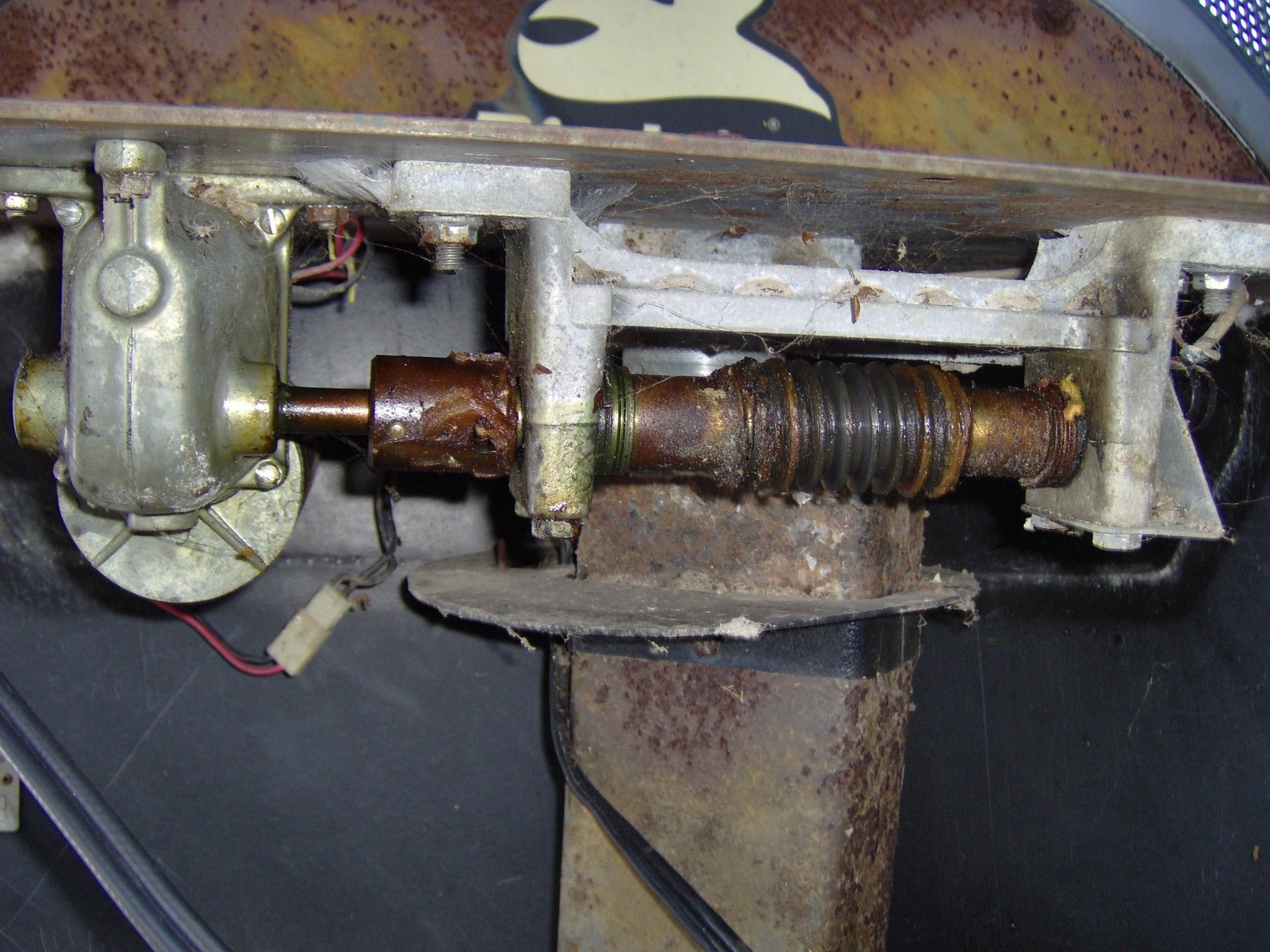

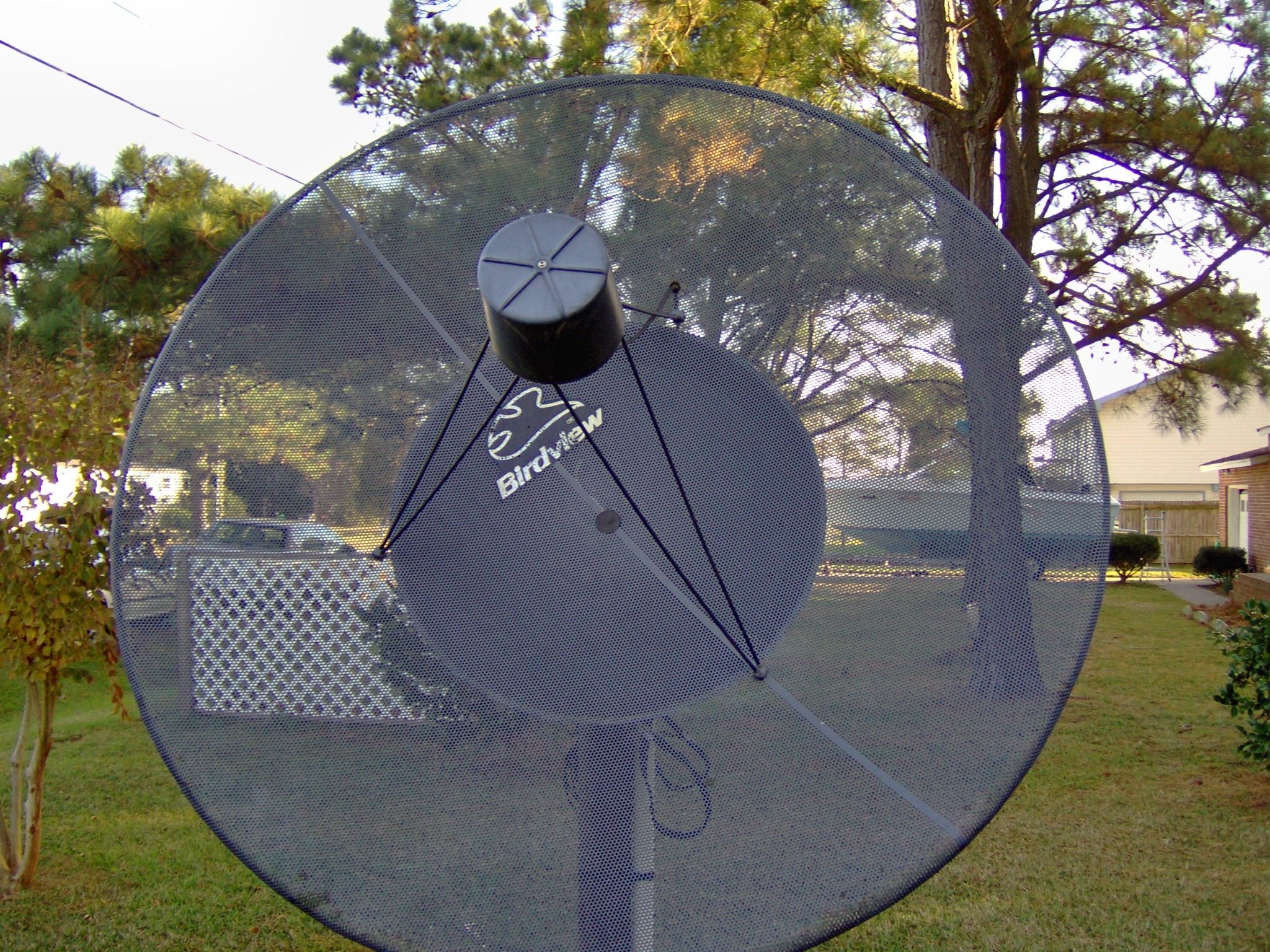

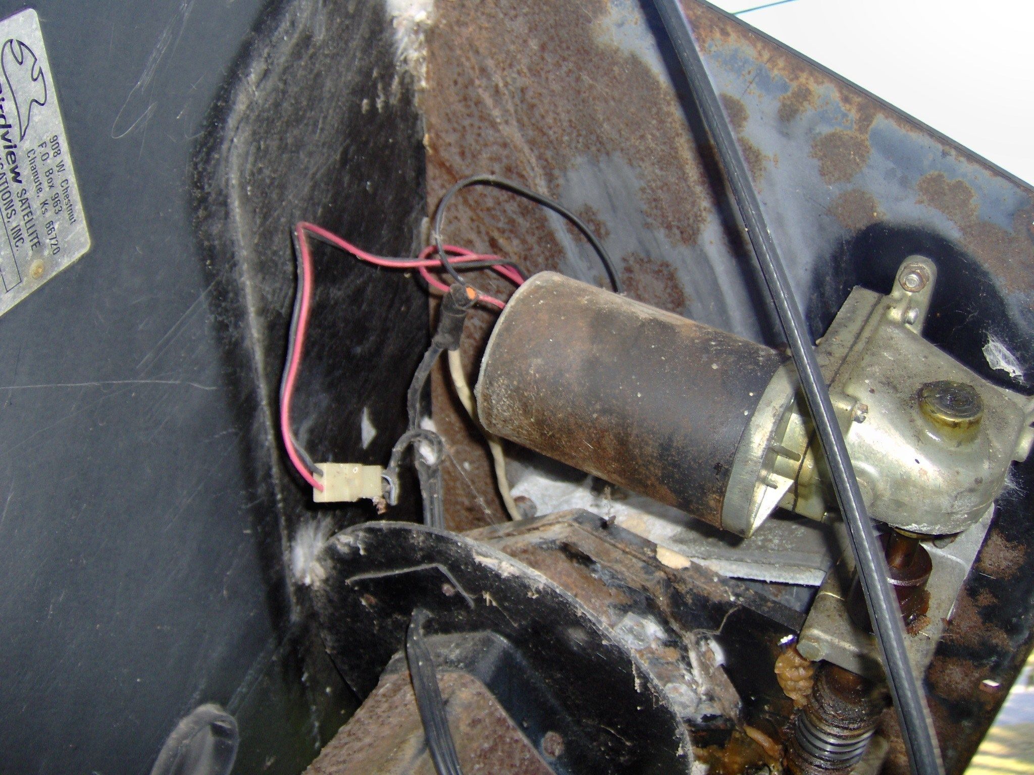

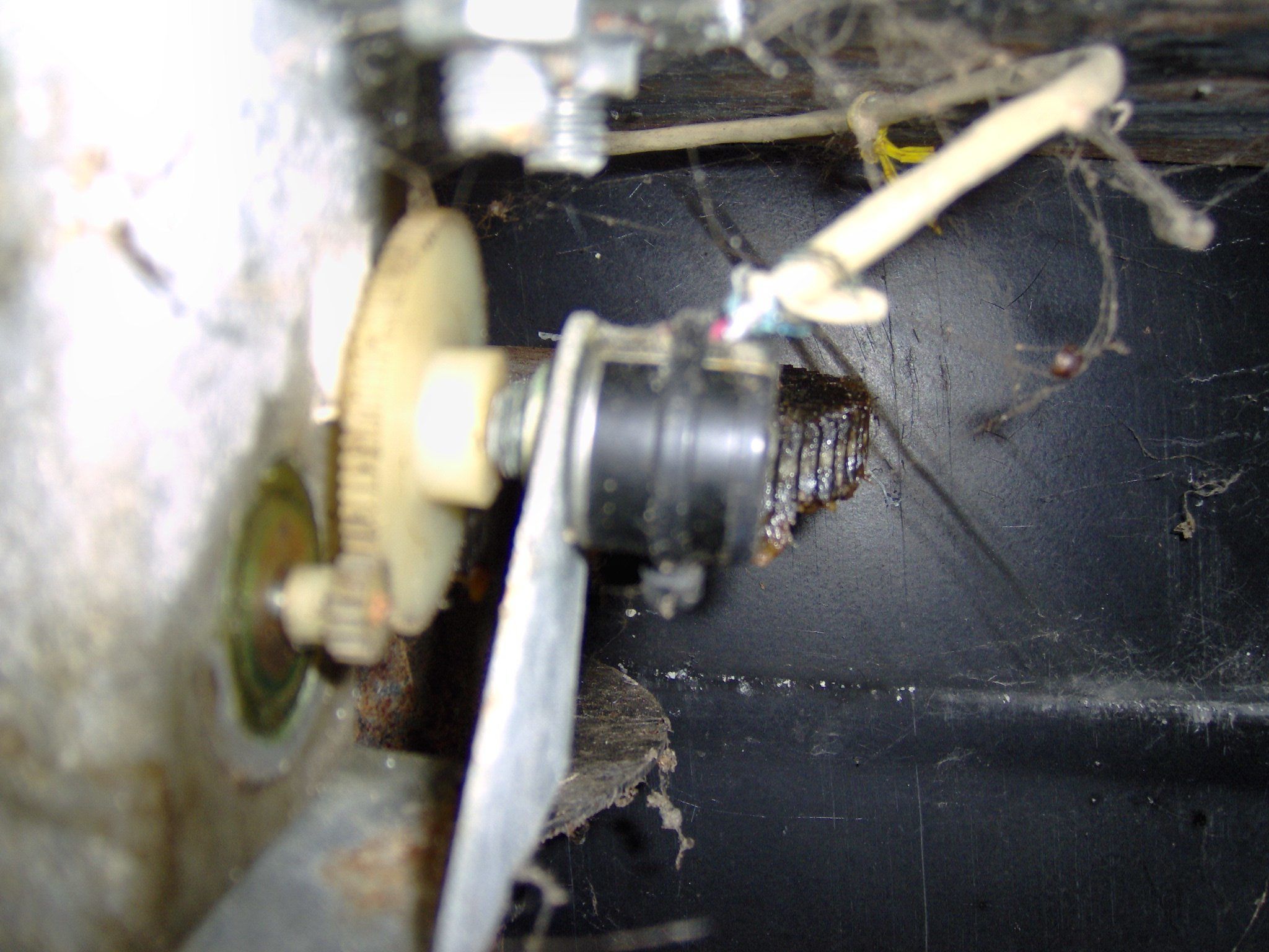

Here are those pictures you wanted to see i hope i have gotten what you need to see. As far as the upgrades, any suggestions which way to go, or should i just talk to skyvision about which reciver, feedhorn , and sensor kit will work best for me ?

contacted skyvision they are telling me to go motorolla 410 and make it stationary not what i wanna do . So i am gonna need some help getting this thing in working order hopefully these pictures will help and someone can tell me what needs to be done.
Linuxman saw your pm . Do you still have a new 1 and used 1? Am i reading the post correctly and if i purchase this what else would i need to get for that as you are aware i am going to have to modify my scaler ring to make anything work with the birdview dish.
I know i need a new sensor but will the motor that movesthe dish still work or do i need to get a new mover as well ? The 1 on there now works perfectly? And any recomendations on a 4dtv reciver ? Or any suggestions on which way will be the easiest to get the new lnb's on the scaler?

I see it is used 1 so am i correct that i would need to get c-band lnb and a ku-band lnb as well to mount on that or does it come with those ? Sorry new to this stuff.
It is used, and I'll throw in a used C-Band, and a used Ku band LNB that I know works. They are older, but will work for you to get started. :)
In answer to 14Karat, the hole only needs to be expanded out just a little about .025 all the way around.

The motor will work fine once you get a magnet wheel and a reed-sensor switch hooked up to it. Your pictures show the old potentiometer which won't work with a 4DTV or the GBox/VBoxes.
great condition
Looks like a well-taken care of Birdview, browncow! (you do know that birdview is the most sought-after of dishes? LOL)
