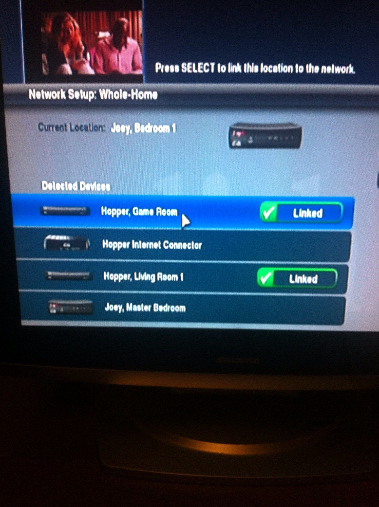

Started having problems with the Joeys not connecting to the Hoppers. They eventually connect. All boxes at current SW updates. Here is a shot of one of my Joeys showing it was connected to both Hoppers.
