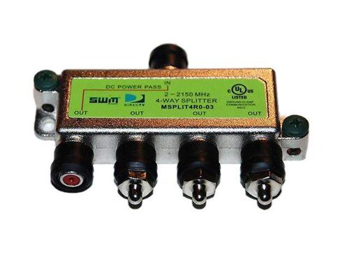

If you follow your HR54 cabling back you may find a Directv Splitter already, if so, thats where you connect the C61k-700.
The HR54 already has a Power Inserter built in, so you don't need that ...
If you don't see a splitter anywhere, you will need to get one, connect it and add your coax at that point for the C61k-700.
Making sure that the HR54 coax connects to the Power ports on the splitter.
There are other s that handle more ports as well as less ... I would get the 4 port, incase you end up adding more.
Maybe, the guy left you the splitter ?

As for the cables you mentioned .... you need to find the feed from the Dish LNB coming into the house, I would put the splitter at that point and run 1 cable to the back of the HR54, then run the other cable from the other side of the splitter to the C61k.
