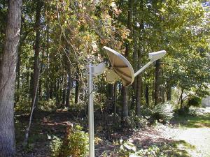

timmy1376 said:
I have told you guys about the DTN dish before, but would a Direcpc or Primestar dish work better? That DTN dish is a LUG, and I am going to have to get it off the roof where I work. I have a friend that loves to rummage and he could probably find me a primestar or direcpc dish. Am I to assume correctly they would need no modification for Ku?
DirecPC dish works like a champ no mods.
