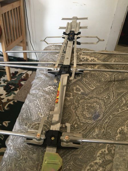

RCA 751R yagi outdoor antenna

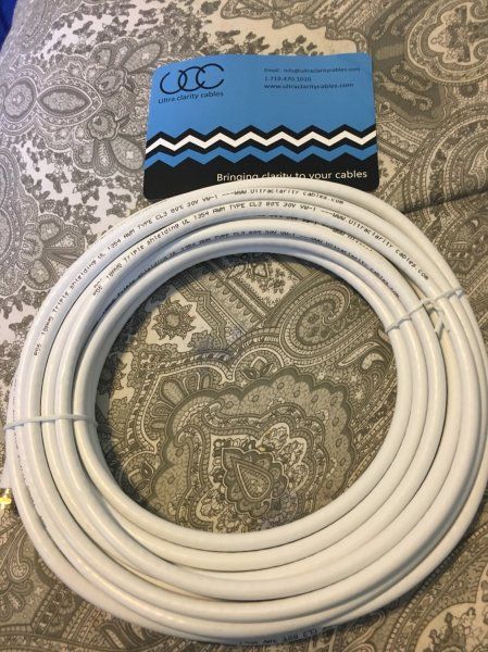

The cable arrived

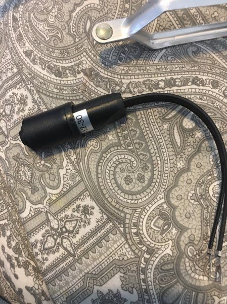

Trying to figure out how to
Connect the transformer to the antenna got to go watch a YouTube video to see how to do it
Should be two studs that you connect the flat ends of the matching transformer to with a couple wingnuts. Then connect the coax to the other end of the matching transformer.
img_2485-jpg.134782
Appears that the transformer has a weather boot already installed. You should be able to pop it off, slide it over the end of your coax cable, screw the coax onto the transformer then slide the weather boot back on. :)
Reactions: osu1991
img_2485-jpg.134782
Everything is done dumb question

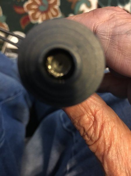

How do I take the weather boot off to make the connection
Boot should be made of rubber and SHOULD just pop off if you pry up on the edge where it is on the transformer. Once it is off slip the boot over your coax, screw the coax onto the transformer and pop the weather boot back on the transformer.
How can u do that when the transformer is connected to the coax
Can't reconnect the boot unless u
Disconnect the coax then your back we're u started from
