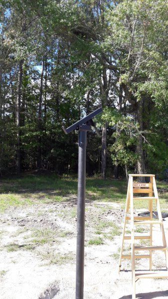

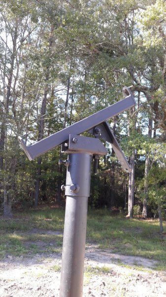

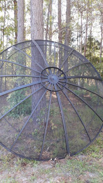

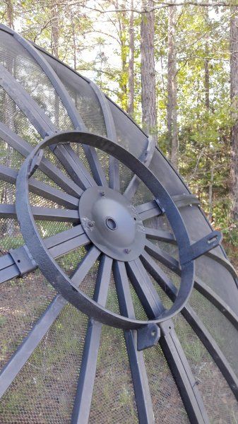

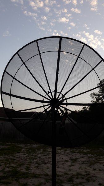

Ok I have been busy today putting my dish back together...I have 2 questions, on the mounting ring on the back of the dish, does the mounting point that has the longer hole need to be on the top of the saddle or on the bottom? Plus here are some pictures for the progress..
Looking at the picture, it appears the bracket with the longer hole would go at the top so you can adjust the offset angle. Just a guess not knowing what brand the dish is. Some dishes have the offset adjustment at the bottom, but it's usually done with all thread with the nuts on both sides of the flange so you can make fine adjustments.
Others have what looks like an elongated hole at the top, but it's actually 4 or 5 holes and you take the pivot bolt out and move it in one hole, or out one. Yours may actually slide up and down the slot to adjust the offset. I'd be surprised it yours goes at the bottom.
Ok that's what I think I remember it being on top when I took it down....its a Channel Master brand.
Channel Master had a really nice fiberglass dish. The feed legs especially were well thought out and they attached to the dish via a hole through the fiberglass. The bottom end of the feed legs were threaded and you installed a bolt from behind the dish threading into the end of the feed leg. They seemed to work really well. We never sold Channel Master, but I remember a couple radio stations in the area using them.

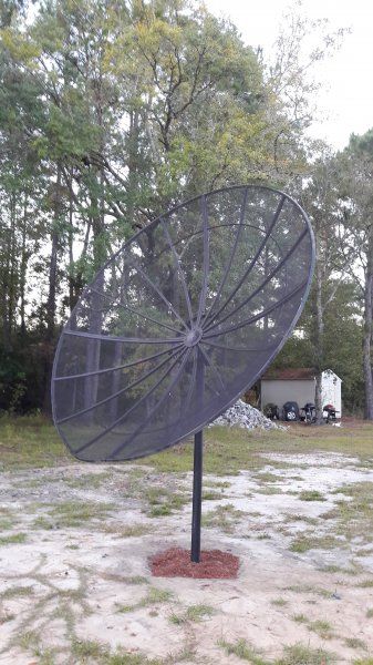

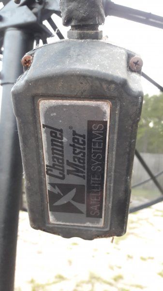

Made progress today with the help of my neighbor....we got it set on the pole! I have installed the actuator to help stationary the dish, looks like it is pretty much froze up ( haven't messed with it yet). Anyone know anything about Channel Master actuators? probably will replace it with a Venture at some point. hope to this coming Sunday to install the LNB support arms and the LNB itself.
